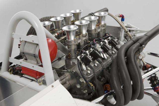

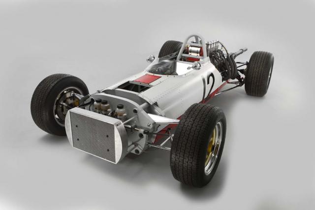

Website is F1-67 - Stuart Taylor Motorsport - Chevy Powered Period 1960's Race Car - The F1-67
Fred W B

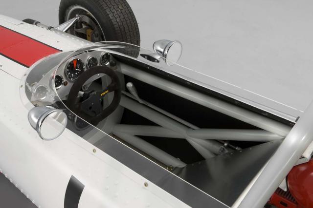

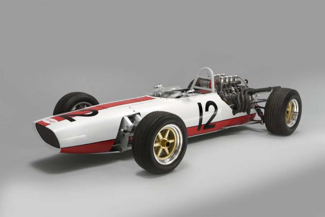

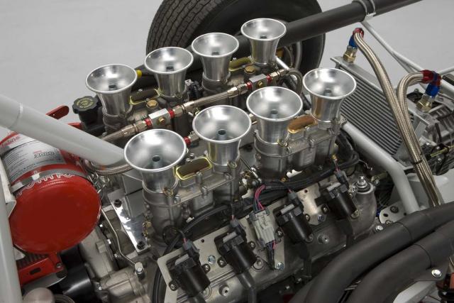

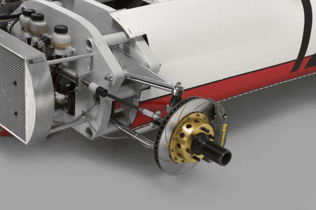

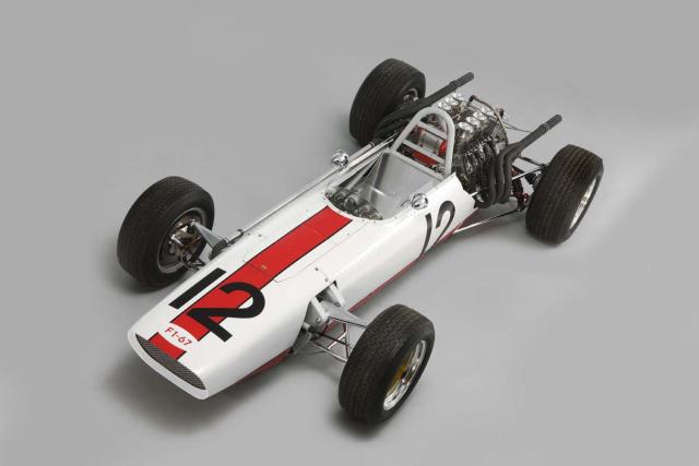

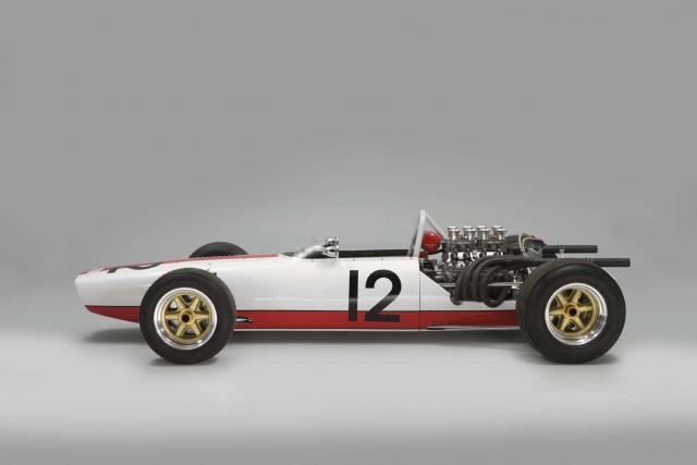

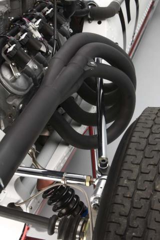

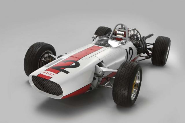

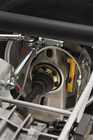

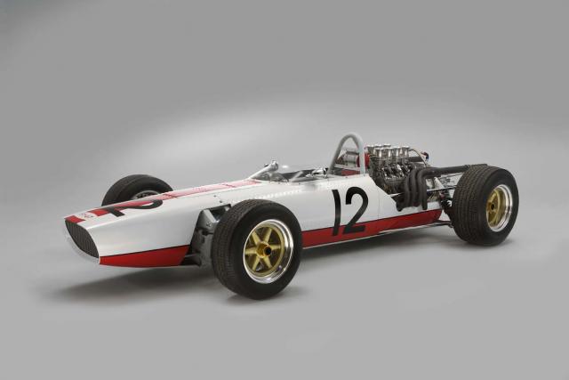

Hi guys
here is a totally new car available in 09 at around $65,000 features the ZFQ and LS3 powertrain.
Regards

This car will be on display at next weeks Autosport show at Birmingham.

If anyone else wants info on this car please don't dilute this thread please start a new thread in the paddock area.
I must say that this F1-67 would be fantastic to drive on a track, take you back to when men were men and F1 cars had gear sticks.

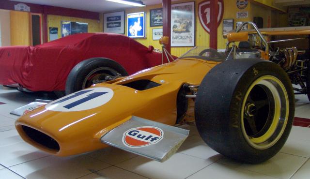

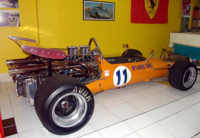

I do have a Formula 5000, a 1969 McLaren M10 A, chassis # 07.
I agree with most of the comments said above... race cars are race cars, and they are expensive to run, you have to pay constant attention to them, rebuilds.... if you want to play safe.
On the other hand, I think I would feel better if I have to repair or rebuild a modern replica after track days and accidents, than if I have to rebuild one of the only 17 chassis built by McLaren/Trojan in 1969.
And rebuilding the replica would be cheaper for sure than rebuilding any of those historic formula cars.

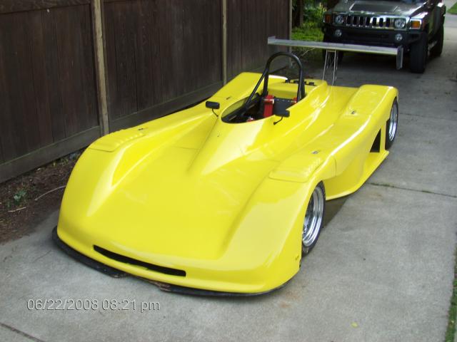

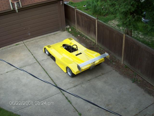

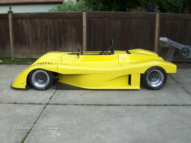

Check out DSR (D-Sports Racer) class. The cars are 800 pounds,ground effects and wings, 180 hp 1000 cc Motorcycle engines. It is one of the fastest classes in SCCA. The cars can be either converted Formula cars, self built cars, to purchased cars. I used to run Formula Ford, and the engines are not designed to run 7000 rpm, so constant maintaince is required (head refresh every 3 race weekend, complete engine refresh every 6 race weekends... $$$$$). Plus, they didn't sound very sexy! The motorcycle engine is designed to rev 11-12,500 (sounds like a proper race engine), it has a six speed sequential gearbox, and will run all season without a refresh.
My car started life as a Van Diemen FF, now it has a Yamaha R1 engine and was highly modified frame and new suspension design.
Darnel
