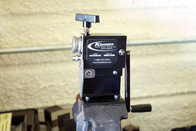

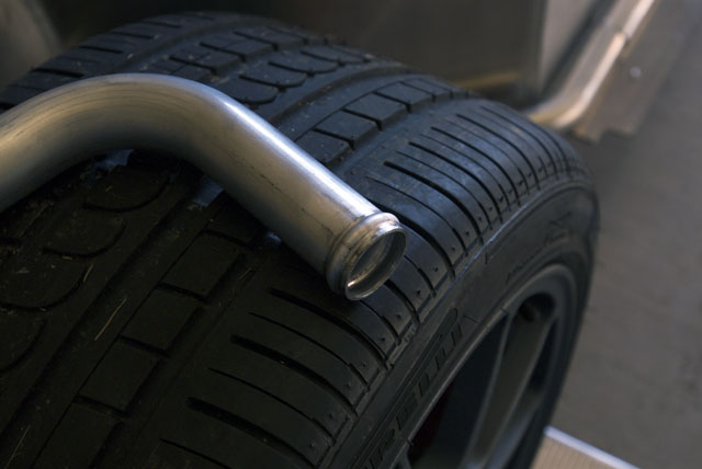

Here is a photo of mine and a bead formed in 1.5" .063 Aluminum tubing:
