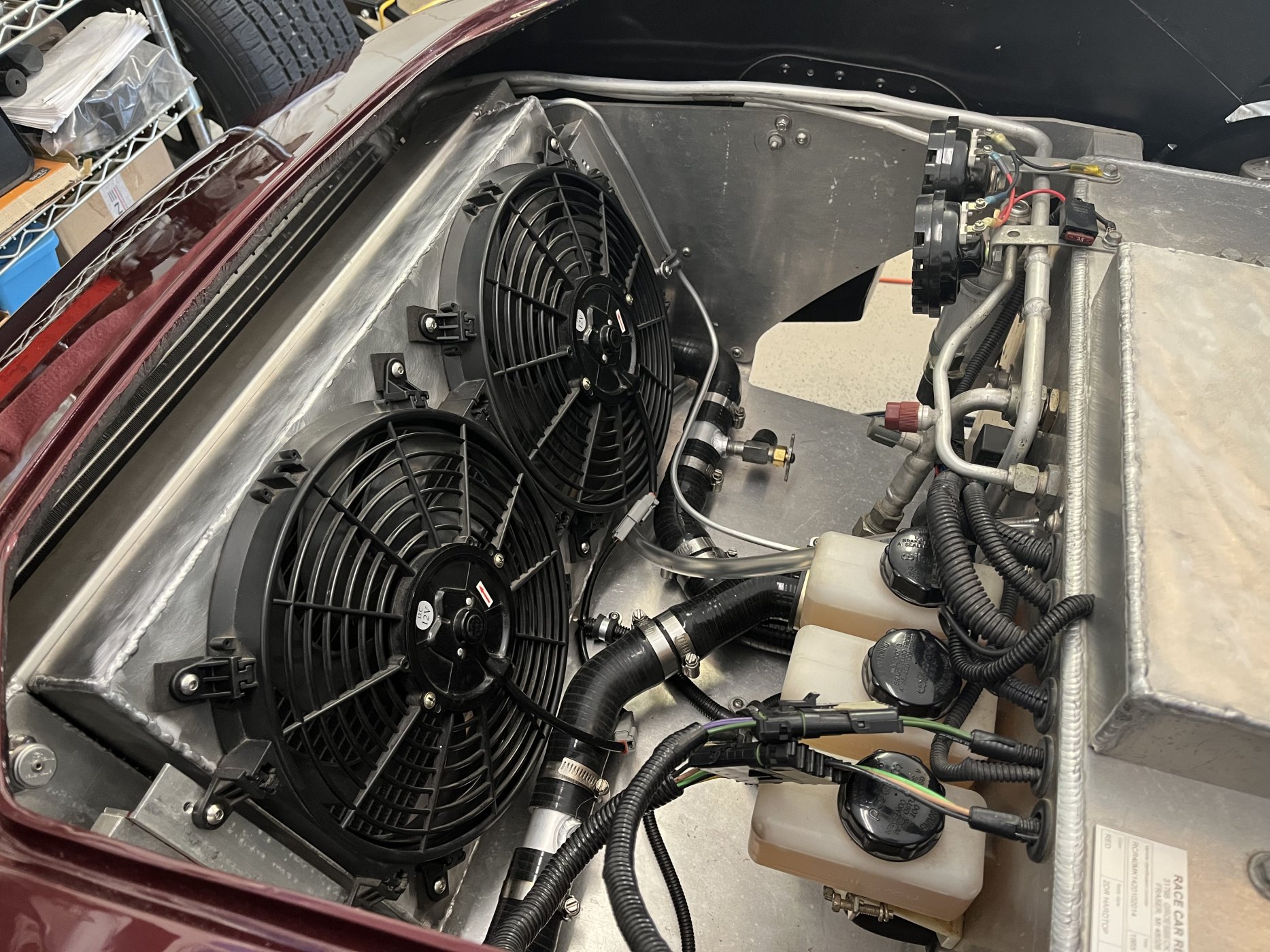

Randy, it has been a few years since this post about radiators and air flow. Wondering what the current thinking is regarding mounting the radiator fans. In my case, my main concern is getting stuck in traffic and overheating. Thx much.
Thanks to Photobucket benevolence, I guess we aren’t privy to Randy V’s original photo array…:rolleyes:
FWIW Randy F, living in FL with high heat and increasingly pervasive traffic, my biggest concern is the same as yours. As such, I’ve been reconfiguring my entire cooling system to preclude low speed issues. Well shrouded fans should be the most efficient means to alleviate low speed air flow through the radiator, so I fabricated an aluminum air box for that purpose. I made it a bit larger volume-wise to hopefully be less restrictive at higher driving speeds, and I configured it to be fairly easy to remove as an assembly for occasional track days. No idea yet how well it will function, as my motor is still out of the car and summer’s not here yet…;)
I do agree with what others have said about guiding as much air as possible into the grill opening is a good idea. Something else to attend to…:cool:
