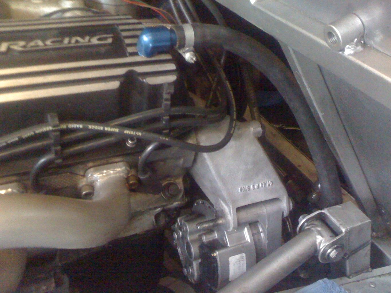

I used one from Real Steel about £14.00 I think. Mick Sollis has all my paperwork as my car is up for its ISVA test tomorrow. If you need more info let me know and I will look it up.
Regards Martin.

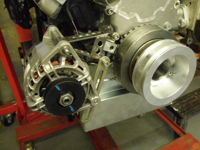

I made my own, The shaft is screwed into the boss on the cylinder block and a simple fabricated brace off the timing cover. The belt came from Halfords

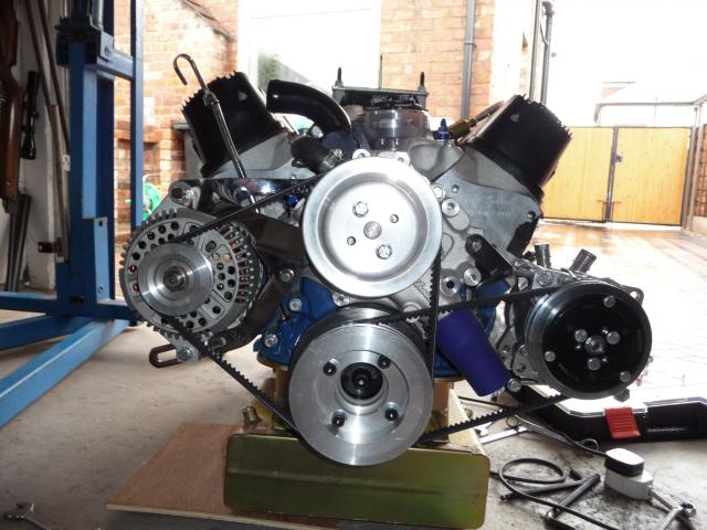

I have several that you could choose from. Early on in my build I wanted "choices" for most of the parts that I chose. So here are a few for you.
Simon buy one of Bill he has 7 spare brackets.
Offer some money for his water pump going by the last pic hes got rid of that as well.
What else you got Bill, we might be able to make you a few bucks.
Jim

I hope I didn't convey the wrong impression. I have a collection of types/examples not the actual ones. As you can see from the photos they are all different engines. If I had that many, I wouldn't have spent 7 years building mine. I have collected literally a thousand different pics of parts, ideas, and techniques that many have done or used in their builds. It helps me when thinking of how to do something. And yes the last one is mine. It is simple and to the point without a lot of extra hardware.
I am running an electric pump because moving the engine forward, put the water pump into the cabin. I may redo the alternator bracket, as it's adjustment rail is the support for the crank trigger and can change its gap if something comes loose. I may go to a variation of my Air conditioner bracket that utilizes the adjustable ball joint.

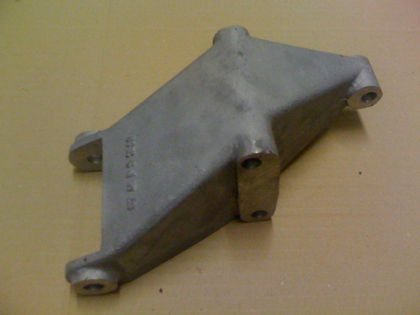

I've had mine cast off an original item - I had a few extra made up if anyone needs one.
