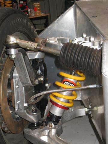

I'm really struggling to get my mind around that bumpsteer correction device --tie rod extension bolt :huh:-- especially on a vehicle intended for competition use .
The settings look pretty good for a start --may need more camber on the front --listen to what the tyres have to say -ultimately

Re: T70 Spyder Track Day Outing #2 Planned
Uh huh! thanks Fran --didn't know all that stuff was available-- still looks 'orrid though
Me no likee either.....:sad:
Well you don't have to drivee then! :)
Yep, that will work as well. We learned about that solution a few weeks ago and drew/theorized it as well, but, wasn't sure it'd do with the ride height. Might be that we end up doing that as we tidy things up. First things first though, get it back out and see if this is doing what we need it to do. From running the suspension through the range of motion is appears we have it set where it needs to be. If what we have is correct then we can look at other ways to accomplish it.
We're a bit pessimistic that we've got everything "perfect" because that just never seems to happen to the best prepared of outings. Now if the weather will cooperate we'll be able to make it out.
Hey, if the bump is gone, the bump is gone.
I already had one brown pancake in that car....would prefer to avoid that next time.
I also agree the steering arms look odd, but if there is no bump and the stuff don't break, then I'm good with it.
Ron, Jac is probably right though that we may need to rethink that for 13 hours of use/abuse, especially if we bump wheels with someone.

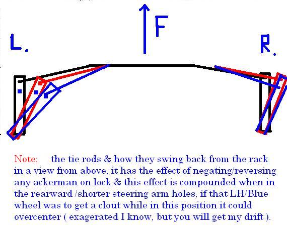

While your pondering what action you might take if any over this, have a think about the attached drawing, it attempts to explain that while your bumpsteer may now be minimal in the straight ahead position, the cure.. with the rack in its current forward position & outer tie rods in a trail position... induces a toe in situation on either lock... now any ackerman built into the steering will be reduced or reversed as lock increases, the car will have a violent reaction when its in a spin situation where loads swap sides while rolling backwards & a few other nasty's that I cant be bothered typing up.. looks like the rack needs to be moved rearwards a bit if your going to use the shorter steering arm configuration.

As far as the suggestions on the rack we'll have to run what we've got now and see what it does. Right now the steering uses the forward most hole on the arm because that gave a better angle to the upper control arm. Static, that is, straight ahead geometry seems to be good but whilst turning through a small angle I'm not sure about. Also not sure how much turning will be needed on track either but we'll definitely pay close attention to it.

This is what I've done --- hopefully will be able to test drive it this w'end
-- may have to take some shims out to raise the rack a bit
