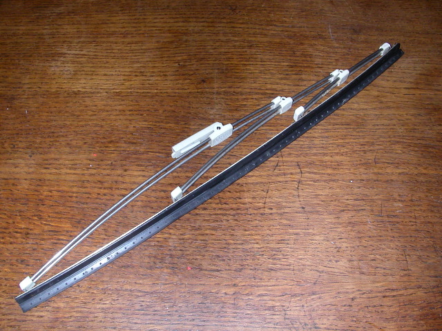

Charlie Farley
Incase anyone is interested, this is what
an original MK 1 wiperblade looks like.
I'm afraid they are like buried treasure
these days !
