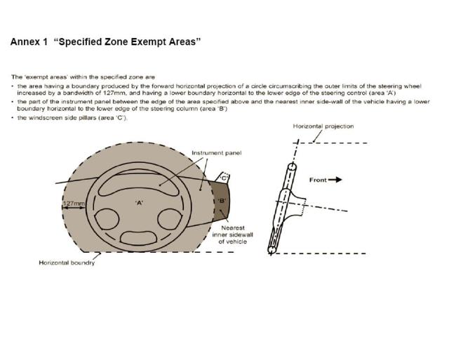

Paul, See attached for exempt area, Section 12 doesn't seem to specify the need for a windscreen. BTW the projection is 3.2mm for normal fittings. The switch statement is below, I would go the loop route for the test like a Mini:
<TABLE dir=ltr borderColor=#000000 cellSpacing=2 cellPadding=7 width=539 border=1><TBODY><TR><TD vAlign=top height=0>
All switches, control knobs etc which are mounted on the instrument panel which are within the "specified zone", contactable by a 165mm diameter. Sphere and protrude from the instrument panel by more than 9.5mm must be likely to retract or detach with no sharp edges when subject to an impact of 40kgf (see Note 5)
</TD></TR></TBODY></TABLE>
On the immobiliser, I hear the cut off switch with removable key is sufficient. If you had a MSD control, they also have a function that you can kill the spark, just use a key switch instead of a toggle.
Brett

OK:There is an exempt area within the specified zone. It is not clear whether or not the 12cm extension to the steering wheel is valid for cars without windscreens. The manual doesn’t mention this, but I have been told that examiners believe it to be the case. Not a problem, I’ll just assume the limit of the steering wheel is my exempt zone. Also, it is unclear whether or not the tester will use the 4” ball inside (instead of the usual 6” ball) due to the lack of a windscreen - inside considered as part of the outside. But again, that shouldn’t be a problem.

I’ll put the ignition key behind the wheel so that should be a problem solved. However, there will be the need for some toggle switches for things like the indicators. I’ll use the loops mentioned above to protect them. But, surely they will protrude more than 9.5mm and therefore need to be able to be broken off without leaving sharp edges (if not in the exempt zone….) which they won’t???
I think the answer is to not to put any switches that aren’t flush fitting anywhere aside from behind the wheel….
