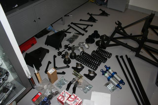

Hi All,
I just thought I would share my good news....
My TSC40 has arrived in my garage!
Day 1 Kit arrived/unpacked and goods checked
Due to work commitments thats it for the first day!
I will post photos of the progress.
I dont think I will be able to sleep tonight.....
A big thanks to Tornado'a Andy Sheldon for arranging the shipment!
John

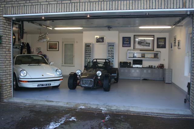

heej another kaaskop,welkom to the forum,I don't have to wish you al the fun cause looking into your garage your already having fun (porker AND a seven)
good luck with the build and please more pic's
btw where are you located in holland?

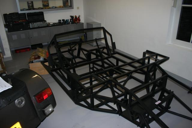

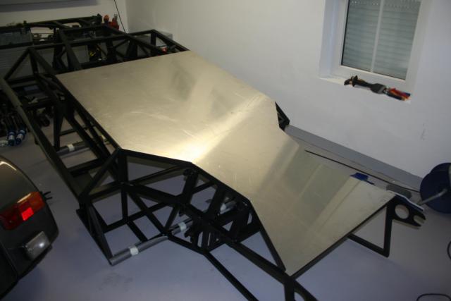

I had a day off today so things have started to move on the build!
The floor pan has been cut to size with a great help from my new toys from Bosch, my dad always says get the right tools for the right job, how true is that, yesterday I managed to find a great tool shop with all the boys tools you could ever wish for! and better still on stock!
Back to work!
Hi John,
I'm at the same point as you are. I got the floor cut last night and should have it in place by Sat. Then on to more .

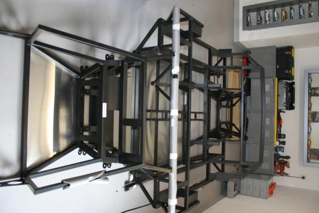

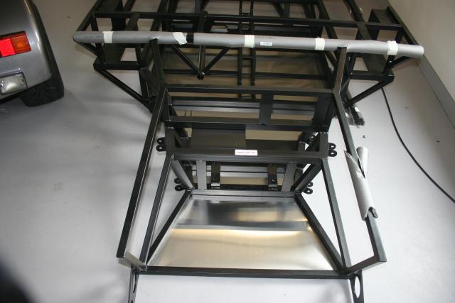

A quick update from with pictures!
Floor finished, flipped her over and started the rear sills :drunk:
Weekend is nearly over so tools away garage tidy.
