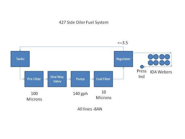

How does the attached fuel system look? After going thru many of the variations online, looked like a system something like this mounted under the oil cooler would ensure that the pump lasts since it won't be 'pulling fuel up hill', would always have fuel available given the high volume, would ensure that 3.5 psi goes to the webers, and would keep the cool fuel by recircualting back to the tank.
Although the new roller is sitting in the garage, have not had rear clip off yet to dig into the fuel plumbing that comes wit hthe roller from SPF. Assume the fuel out line is there. Is there a port to add a return line to the tank already there?
Mark

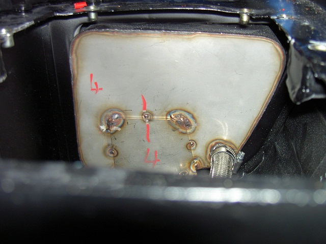

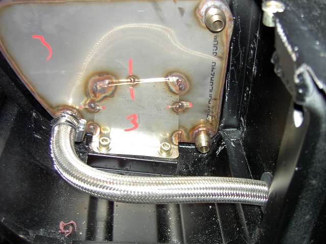

Mark --
Attached are pictures of the rear of both the LH and RH fuel tanks on P2160. You'll see that the LH tank has AN-8 fittings top and bottom on the inside. Note crossover hose on the outside, hose-clamped, on both tanks. RH tank has no other fittings.
Alan.
