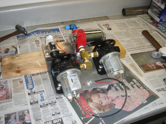

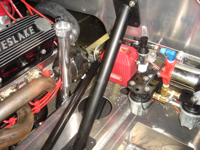

Neil,
I mounted my pumps, the filter and a valve to put the return fuel into the proper tank all to an aluminum plate then mounted the plate to the firewall with rubber isolation mounts.
The pumps make more noise than anything else in the car. That said, it does give some comfort to hear the pump running.
