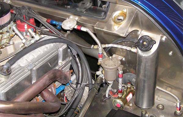

After doing that I went poking around under the clamshell of the GT40 and noticed that the fuel hoses looked pretty "deformed" to say the least (see pic). I think they had shrunk over time....notice the hard kinks and bends. These are stainless sheethed fuel hoses so it's pretty hard to tell if the rubber itself is cracking or obviously failing. However, once off, it was clear the rubber was old and cracking and really just about ready to let the fuel start seeping (if not spraying) out the hose itself. My car is carb'd, so, fuel pressures are pretty low, however, those fuel lines run right by the exhaust manifolds so it wouldn't be any stretch to start a fire in there.
I went to one of our local, and very excellent, hose shops and they made up replacement hoses with a teflon liner designed for modern fuel blends, stainless sheeths, and the proper compression fit ends. A few hundred bucks for all.
