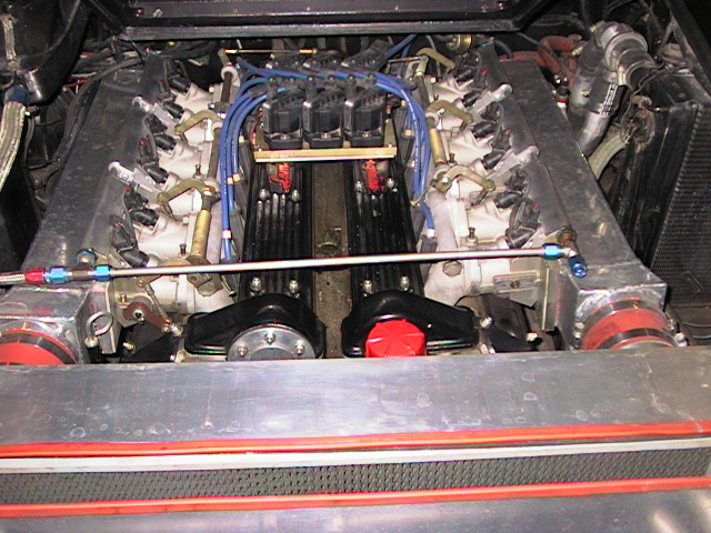

I use electromotive on my lamborghini, Mike Trusty and I put this on in 1993 and its still running on the same plugs some 20k miles later and starts on the second go round. Here is a picture of the engine with TWM throttle bodies. I really like your choice of engines for your project, its a good solid motor from what I have read.
I have put electromotive on every car I own even my twin turbo Subaru powered VW Vanagon, I love the product. The later versions of electromotive are great if you are familiar with there operation but there are far to many options which get people confused and into trouble, I would recommend Tech 1 for price and ease of use.
One nice thing about the latest electromotive product is it is true sequential as the tech 1 and 2 are not, unless you use 2 units. The tech 1 bang for the buck is your best bet and if you have a problem getting it tuned I would be willing to help.
