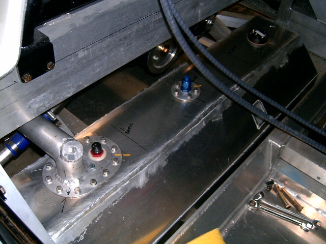

Here's my gas tank. I'm talking about the return line from the regulator to the gas tank.
I drew 2 rough lines. The bottom red line is the bottom of the return line. The top red line is the max fill line (any higher than this and it comes pouring out my vent line).
As you can see, if I fill the tank to the absolute max it can take, the return line will be well covered by the fuel (although not for long, lol)
Is this okay, or should the return line ALWAYS be above the fuel line? The reason I ask is because the A1000 needs the return line to keep itself cool - so if the tank is filled to max and the return line is a bit below the max mark, will the fuel still cycle back in and kepe the a1000 cool, or will bad things happen?

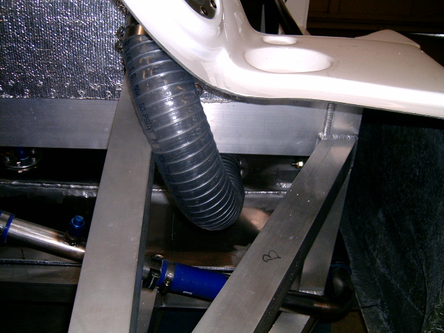

The vent is a slight concern, but that's the highest point I can stick the vent fitting at - any higher and you run into the rear crossbeam
I don't have any pictures of it, but I have the vent hose running upwards for a little bit, then downwards (no u-trap anywhere) so if fuel does get into it it should slosh back into the tank, or if it's an extreme slosh, slosh out onto the ground, but not get trapped anywhere
Might be an idea to run a vent line from _HERE_ also under the cross beam & Tee it into the other vent line.
Wouldn't that be a bad idea? - you'd have to basically form a U and go underneath the rear crossbeam. If any fuel sloshes into the 'U' it isn't going to come back out unless you have a really hard slosh.
I could put the vent fitting there and run it upwards and back, buuuuuut then I'd have to chop into the rear aluminum bulkhead panel, and I don't really feel like doing that because I'd rather not have a hose sticking in the interior that you can see.

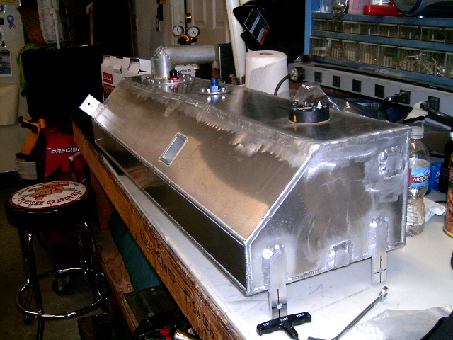

Btw, here's 2 pictures with the tank mounted and vent in place.
If I fill the tank up to the bottom of the vent, I can get 29 1/2L in. So if I leave a few litres out, say only filling 25L, then I think even though it isn't ideal, I should be okay-ish .... it would take a violent slosh to get fuel into the vent line, but then it would drain back down into the tank immediately (unless it was a huge surge, in which case it would puke it out)
Also, if you see the return line in the first picture (far left side of the tank), filling to 25L would have the return above the max fill line. Filling to 29L (max) would have it ~ 1/4'' below the max fill line, so I guess that isn't too too horrible.
It may be kind of hard to tell from the last picture, but by placing a vent fitting where you suggested and coming under the crossbeam, I don't think would help that much - it'd only be ~ 1/4'' higher than the current fitting, not to mention the potential u-trap.
The one thought I did have though is what happens if I added another vent line into the fill neck, and t'd that line into this vent line? Good idea, or potentially bad idea?
See pic...even though the upper suggested vent line would have a 'U' to go under the x-member, the fuel going in & displacing the air would force any fuel trapped in the 'U' of the vent tube out during the filling process.
In that picture, the top of the filler neck is roughly even with the bottom of the vent tube (~29 1/2 L).
So my plan would be to atmost fill it with 27-28L since that brings it to the bottom of the filler neck.
I'm not so much concerned about my limited fuel capacity as i am doing this safely (i.e., not a rolling fire trap, heh)

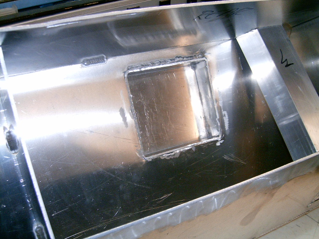

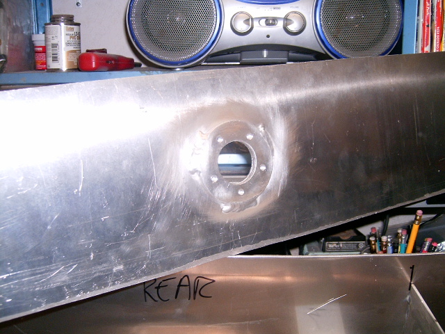

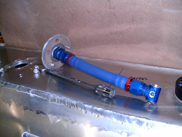

This is how I did mine. I see no reason to extend the tank above the fill port. I needed a flat surface to mount all the stuff on including the level sender and vent and return port, and I wanted to pump from a sump at the center of the tank. Also everything can be removed from the tank for maintenance.
I also filled mine and found it will hold 14 gals as you see it.

Howard, do you have any pics of your sump? As you can see from mine, my sump is at the side of the tank - not my favorite location, but it was designed well enough that fuel starvation shouldn't be an issue unless I'm running reallly low and pull a very hard turn.
I can't figure out how you'd sump it at the back and have access to it, because the sump would sit below the rear crossbeam blocking access to it?
