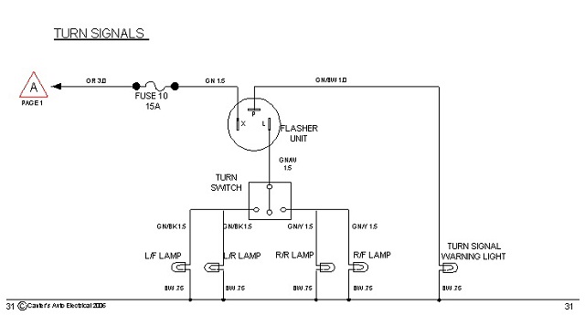

See schmatic of that area below. I'm assuming what you're saying is you used the turn signals, they worked normally, but when you turned the switch off the amber dash light stayed on.
I think your flasher unit has failed. I don't recall exactly where it is, somewhere behind the dash. Usually it's an aluminum or plastic box or cylinder about 1" on each side, and might look just like an automotive relay. If you can get it to make it's "tink-tink" noise, perhaps by manipulating the switch, you might find it that way. If you can't find it let me know and I'll figure out where it is. If you can, swap it for an equivalent from your local Pep Boys or whatever, and see if that fixes it. They're pretty generic and cheap.

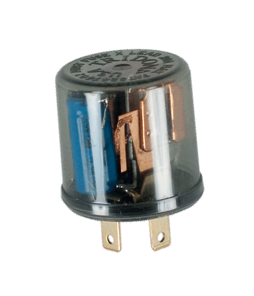

And after all that it turns out my flasher problem is internal to the flasher relay as well. There is a very thin piece of copper that is an extension of the dash lamp terminal. If it is a little out of adjustement (i.e. bent) the dash lamp will be intermittent with wiggling the terminal. If it is further out of adjustment, the dash lamp will either be solid on or solid off.
So, if you have any symptom where the turn signals themselvers work but the dash lamp doesn't, you should probably just go buy a new three-terminal flasher relay.
This is a picture of the guilty party:

This is a picture of the guilty party...
I learned way more than I wanted to know about flasher relays today: Three terminal flashers are of two incompatible types: The Tridon EL13 SPF used by SPF is in series with the turn signal lights, with a separate terminal for the dash light. In other words it needs no ground connection.
The other type of three terminal units deletes the dash light terminal but requires a ground terminal. This i believe is because it has an internal integrated circuit that assures a load-independent flash rate and controls some government mandated "bulb out" behavior (eg blinking fast).
If you see a flasher unit described as "electronic" it simply means it has one of those ICs. It does NOT mean it has no galvanic contacts or moving parts or is "solid state." I could not find any solid state flasher units other than a bulky (4 cu. in) and expensive ($40) Grote 44010.
So basically the obvious thing to do with a bad EL13 is replace it with another EL13 and hope for the best. I'm going to go one step further and replace mine with an EP26, a 4-terminal unit to which I will have to supply a ground lead (there's a power receptacle nearby in the small switch panel where I can grab a ground). The reason for the change is that I suspect the EP26 will be more reliable. It also has a rectangular case that is easier to fit behind the dash.
