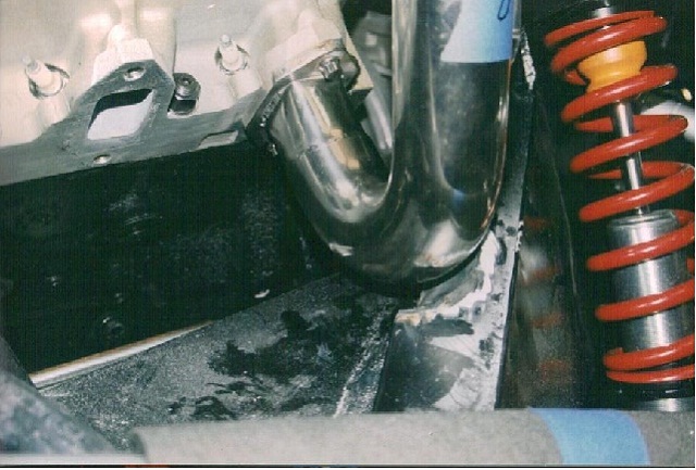

I also know from Paul and some of his pictures that there is some significant variability here: for example, consider the attached picture from him showing a car (not P2125; frame's black) that required significant notching to the frame to clear the rearmost exhaust headers. Mine required no such modification (by a significant margin), so we're talking about differences of an inch or more. I don't know how to account for those unless there are some big differences in our various motor mounts.

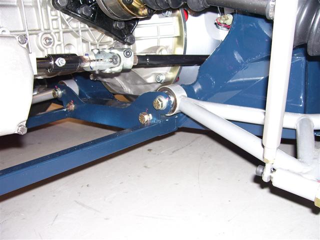

Also attached is one of your pictures of your car. It does suggest a large amount of clearance but you can't really tell without sighting along the forward edge of the lower hoop. I think you'd have to get under the car to take that picture.

Have the car up on blocks doing winter PM's and large 24" block right under the lower crossmember so can't get a pic but, I was able to put my fingers between the bellhousing and the crossmember so maybe 3/8 at the lowest point.
Looks like Paul gently rolled the front lip (no damage to paint and a smooth roll).
