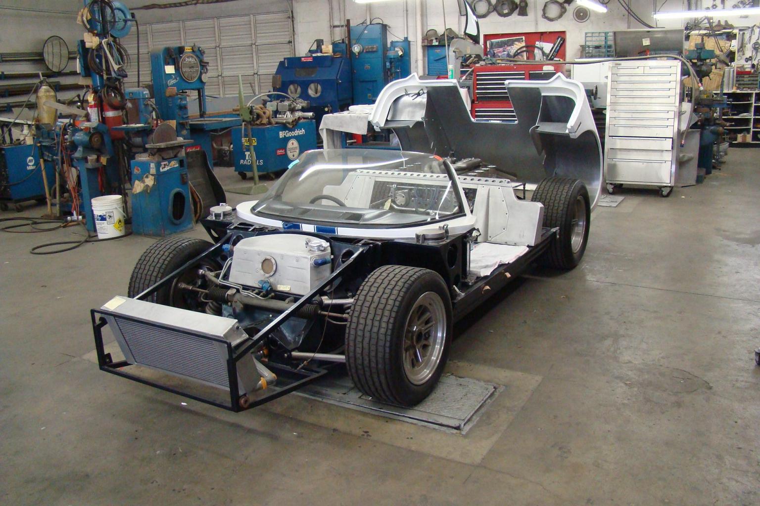

I am in LA now helping Dean with GT109 and can positively tell you it has not been sold and Dean has no plans to sell the car despite plenty of offers. Dean also still owns the Manta Ray he built in 1963

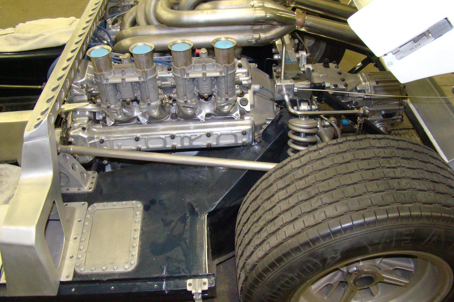

I didn't realize that 109 has a Ford Indy engine with the inside exhaust and outside Webers. Very cool. How does the throttle linkage work with the carbs so far apart? Maybe I will not be the only one with synchronizing headaches....
Jim,
The 255 DOHC "Indy" motor was constant flow injected from Ford, the Webers are an 'add on". What is not commonly known is that the heads can be swapped left for right and that then the exhausts come out below the cams much like a "normal" V8 while the intakes still flow between the cams. There are pictures of this configuration in front engine sprint cars circa 1965. Mario drove one that way several times, but the Ford was not as competitive in sprints as at the "big" tracks.
As you know Bill Wonder also had a 255 installed in 103 for many years. Very cool looking but probably not worth the hassles.......

I remember that; they had Hilborn type injection or something like it, maybe Kinsler? And I did see the motor in Bill's car 103 when I visited him, although he had by then put an EFI system on it with coil packs and all that... I did not hear it run, but it must have been earsplitting when running...
I still don't know how you synch the butterflies from one side to the other...
Very carefully!
I think, but do not know for sure that they really didn't "fine tune" the balance as it would seem to be more important at low RPMs as opposed to 7,000 plus.
