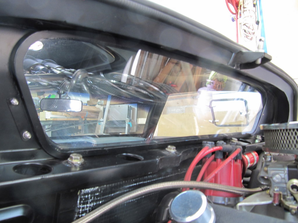

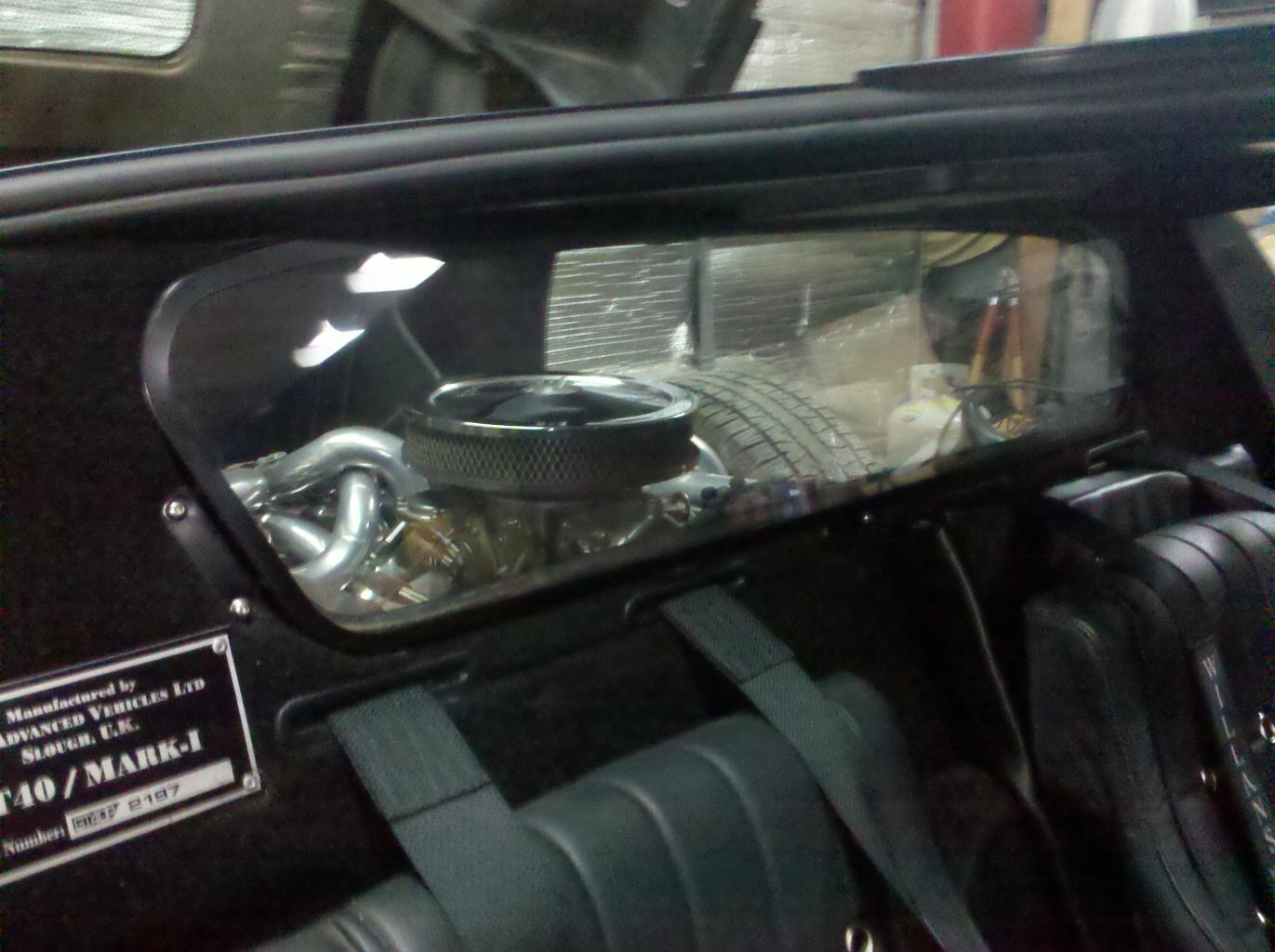

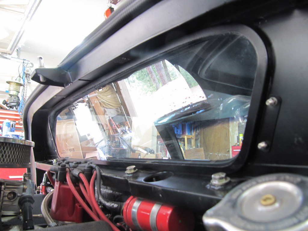

Originally the thought of having that very thin piece of plastic between me and the engine didn’t set well. Then there was the matter of heat and noise, not that I don’t love the sound but it would have been a bit much after hours on the road. So before I ever drove the car I replaced the thin plastic window with a piece of ½” Lexan. Everything was fine until I had to keep cleaning the engine side of the window and worried about the engine heat and scratches. My solution was to add a safety glass window on the engine side of the window opening. I was lucky enough to pick up an extra window frame hoping it would fit. Well it does with the removal of the bottom tab. So now I have a piece of safety plate glass on the engine side and Lexan on the passenger side. From the inside of the car you would never know it was there. Only when you open the rear clip and look would you ever see it. It looks like it's always been there. Sorry my cell phone doesn't take the best pictures.

Actually my windows are 1/4" glass. The 3/4" Lexan is from Olthoff. Both do the job well of insulating heat and noise, I made the glass units to more closely replicate the originals and to prevent any discoloration from fuel, etc.
The glass windows are now $139.00 to GT40s.com'ers and include a new rubber moulding and drain tube splice.

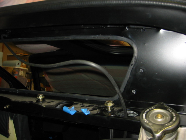

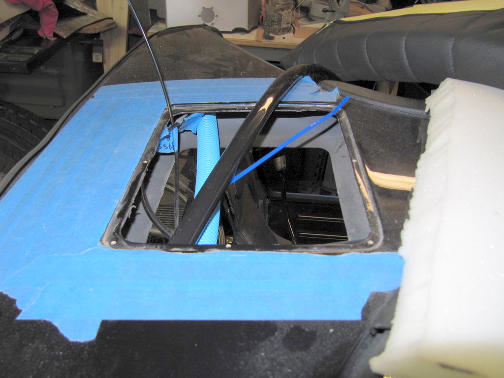

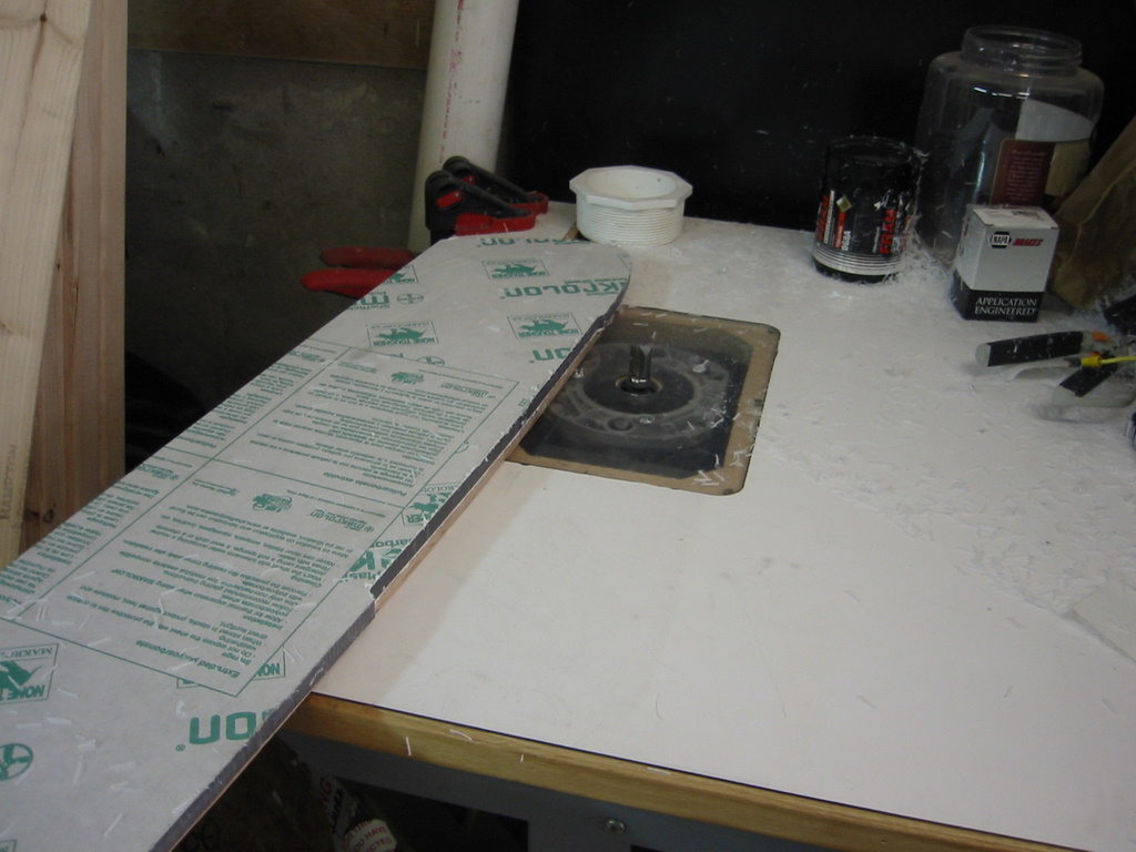

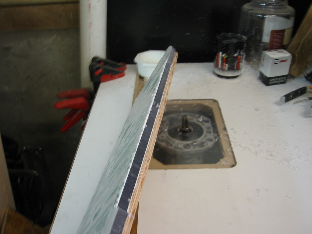

I made a 1/2" Lexan window in about an hour. It's the perfect thickness if you want to retain the original frame. I first moved and glued with 3M weather strip adhesive the window gasket to the metal window opening. I then made a pattern out of 3/8" plywood using the window frame as a template. Make sure the pattern fits inside the frame. Trim the plastic a little oversize then use double stick tape to hold the Lexan to the pattern. Next using a router and a trim bit, route around the pattern. Piece of cake.
BTW make sure you order scratch resistant Lexan. I didn't now there was any other kind but there is. Also you don't need a router table I just happen to have made one and it does make it easier. Do not take the protective paper off until you're ready to install the window.
For those of you that don't use a router that often and you're using a router table go clockwise around the pattern if you use a hand held router go counter clockwise. It makes the whole process safer, easier with better results.
I also got rid of the drain tube as it was much to small. I ended up using a 1/2" tube routed down the right hand B pillar. The new drain is the black tube in the fourth picture.
