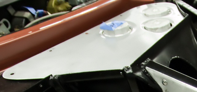

By the way here is how this all looks on P1032, a real Mk II.:
It looks like they mount the reservoirs from below, and then the cover plate just "covers".

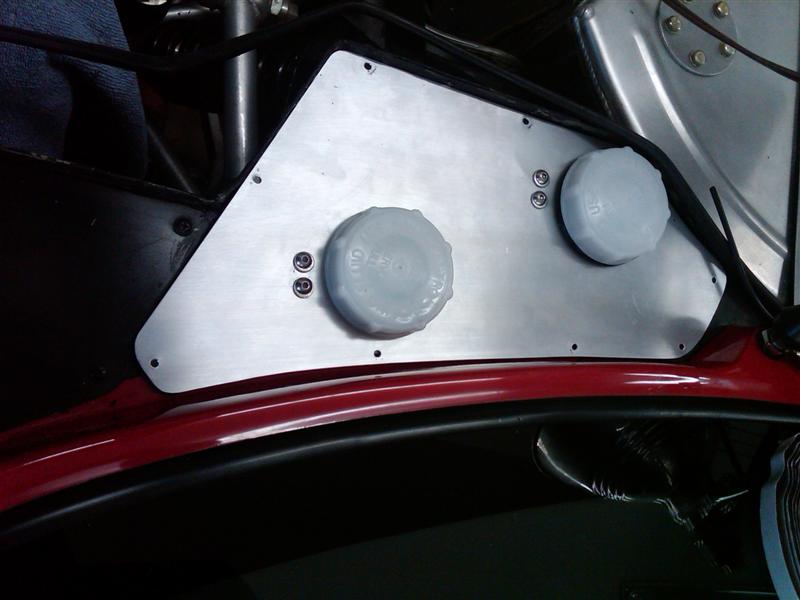

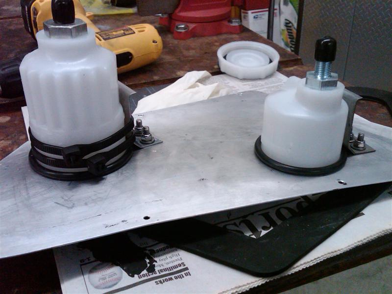

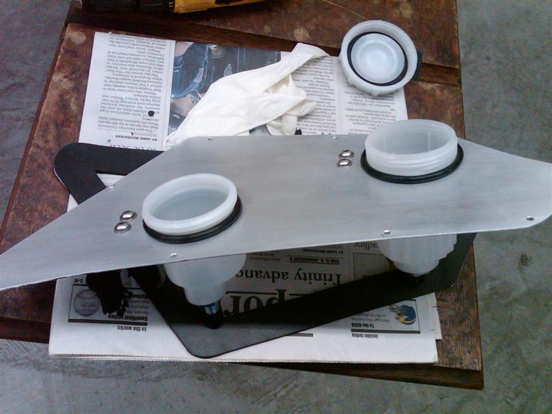

Here was my solution to the reservior problem. I enlarged the holes and installed plastic reserviors and JB welded them in the hole after attaching them to the original bracket with tie wraps.

Chet --
Elegant. What is the black ring on either side of the aluminum plate? Is it an O-ring, or some part that comes with the reservoirs?
Chet Schwer
Alan,
They are just O-rings that are there just for cosmetic purposes. I did not install the O-rings shown in the photos on the underside. I just used them for a trial fit.
