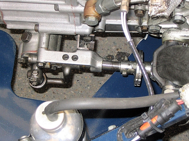

Look close at pic 3 and 4.
Actually 2 cross shafts from center to Rt side (one for R/L the other Fwd/Back motion).
They merge into one shaft running Front to Back

You got it!

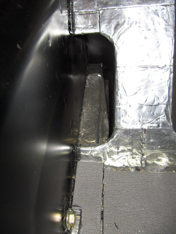

Does anyone have a picture of the bearing that supports the shift rod on a RHD drive car as goes through bulkhead? My car is a LHD but if it were a RHD car the rod would go tall slot in the picture. Steve do you have a picture of this area on you car.

Steve I did find the one picture of that area of you car. Do you have one at a lower angle that shows the shift rod going through the bulkhead?
