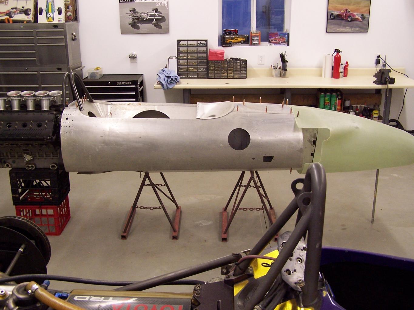

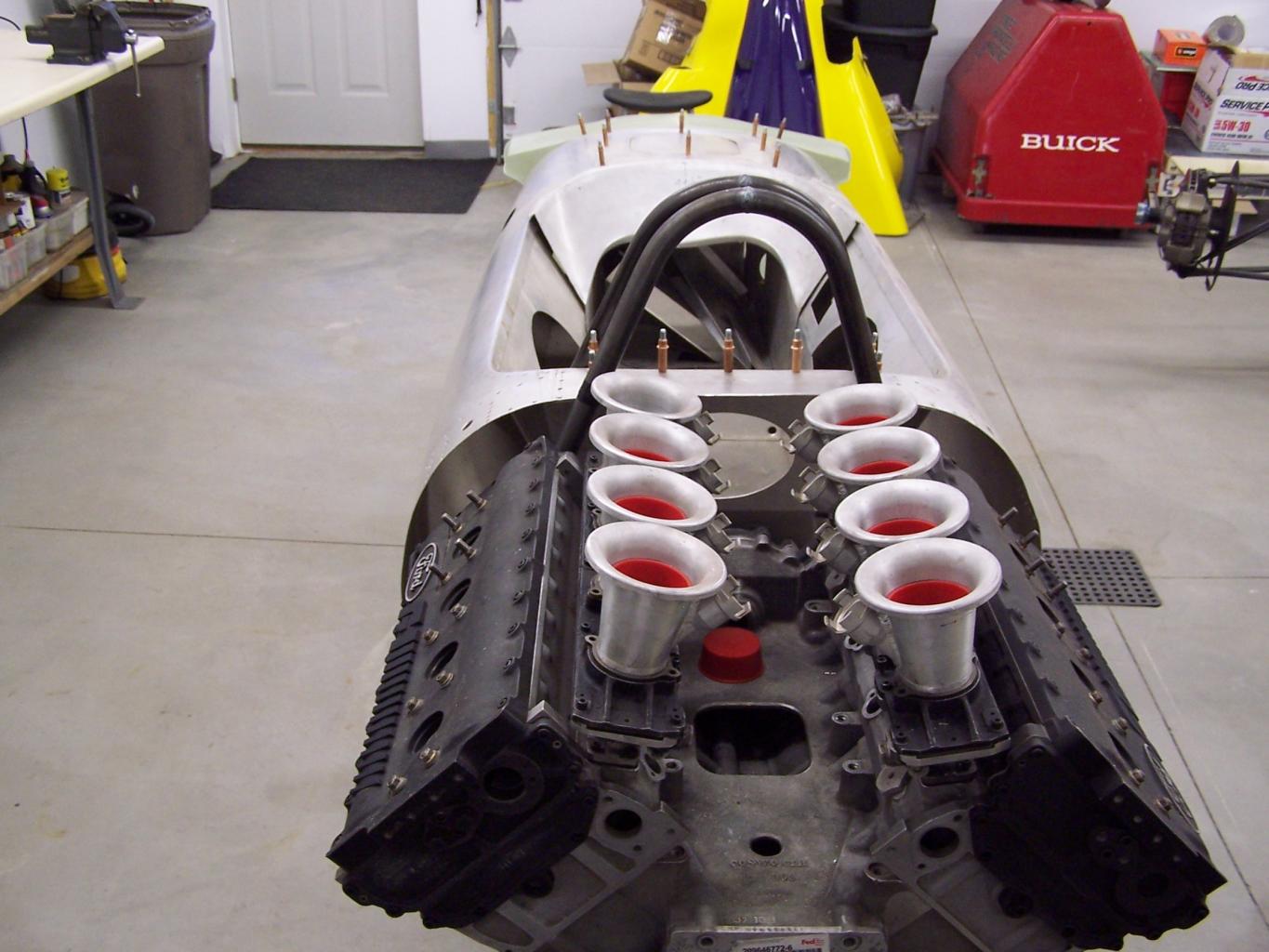

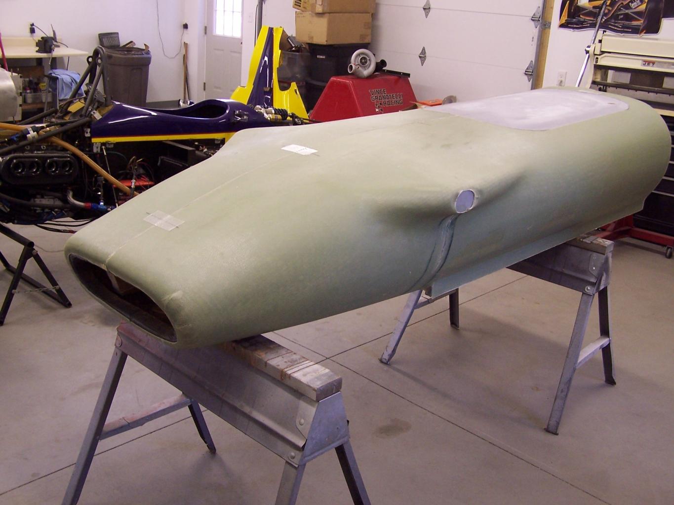

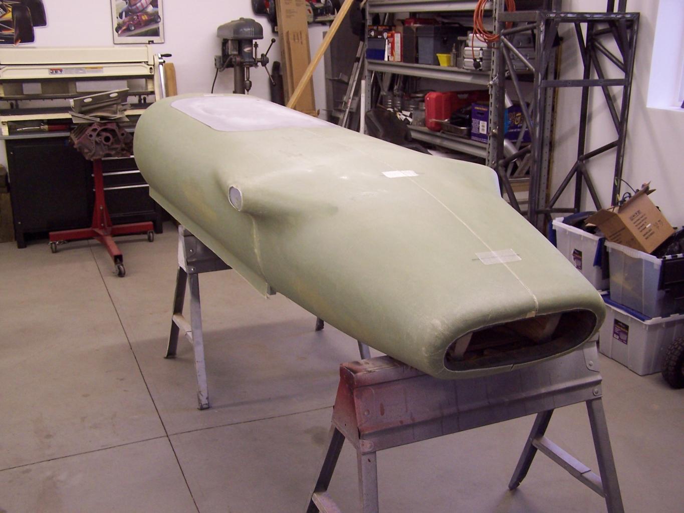

A long way to go on my Lotus 49 replica, can't decide whether to continue on with the monocoque route or go with the space frame, clad in ally to look like one. Still have a lot of fitting and fabrication, hope to be out by next spring. Just couldn't come up with the cash for a real one.

Nice! Very clean, much like your work space. I also admire the Tamiya models you have for inspiration on your tool chest. Being a devout Can-Am fan I have to ask, are you going to run the "banned" wing from the 49B?
Seymour Snerd
What a beautiful project. I hope you stick with the monocoque, but that's a serious case of "let's you and him fight."

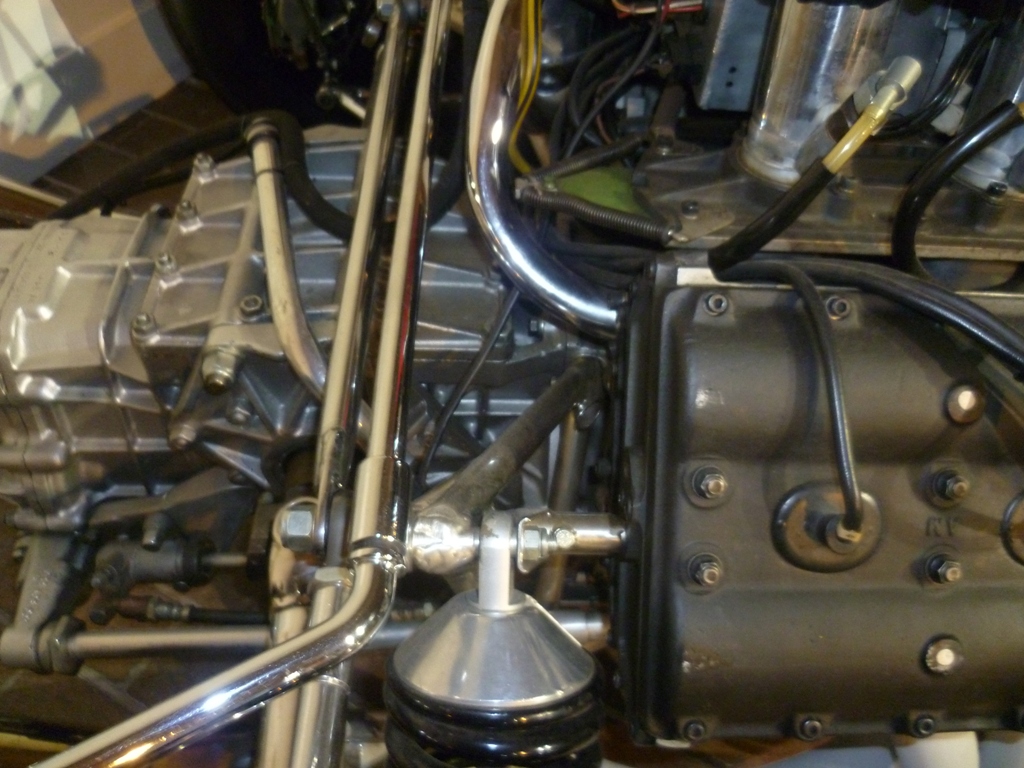

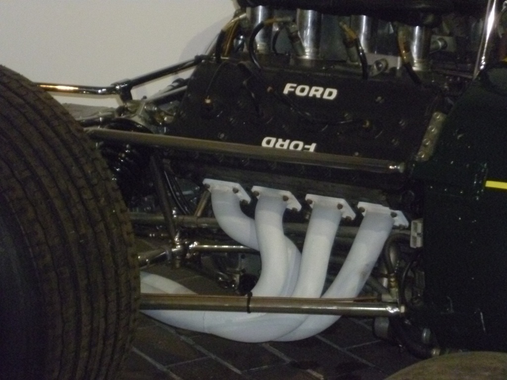

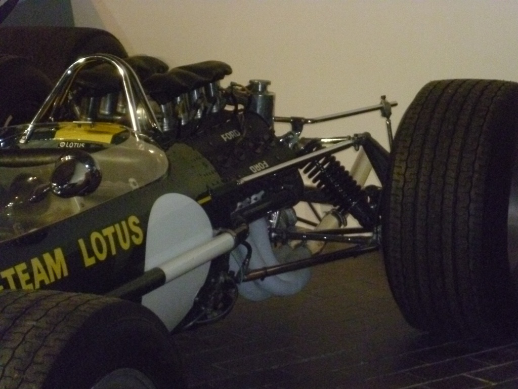

Gordy,

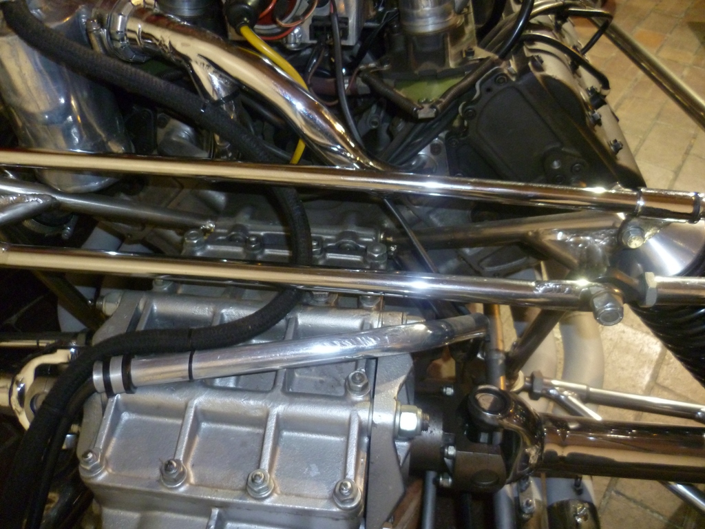

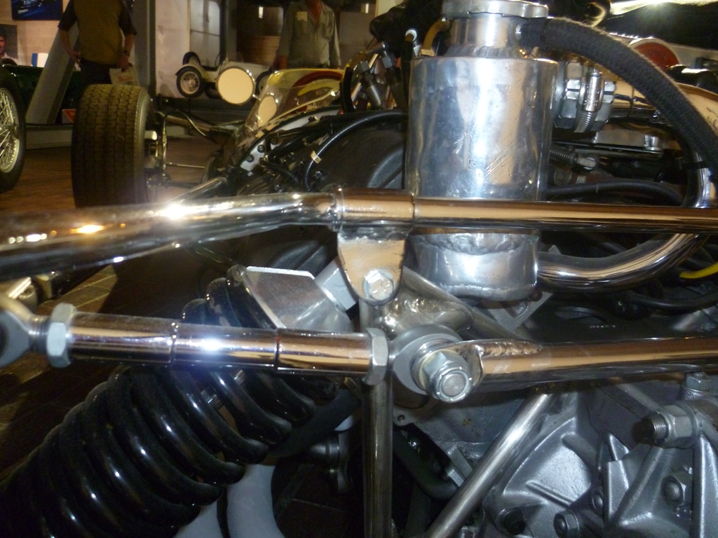

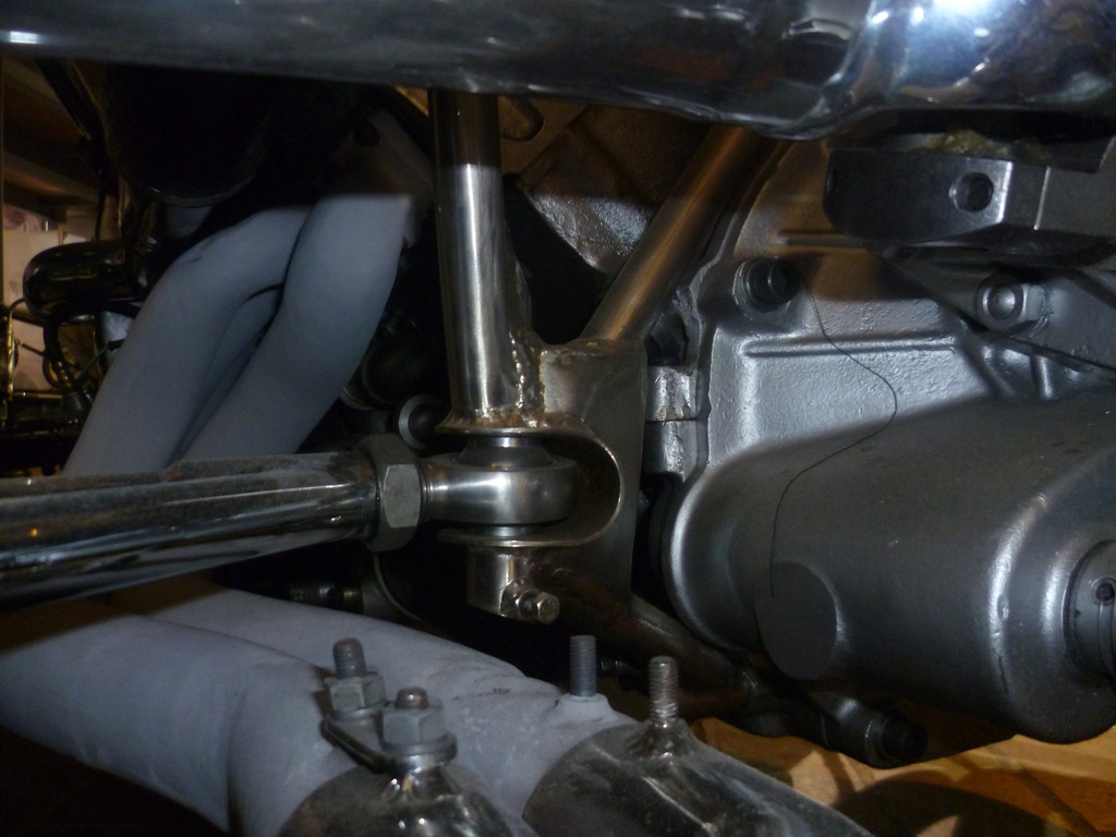

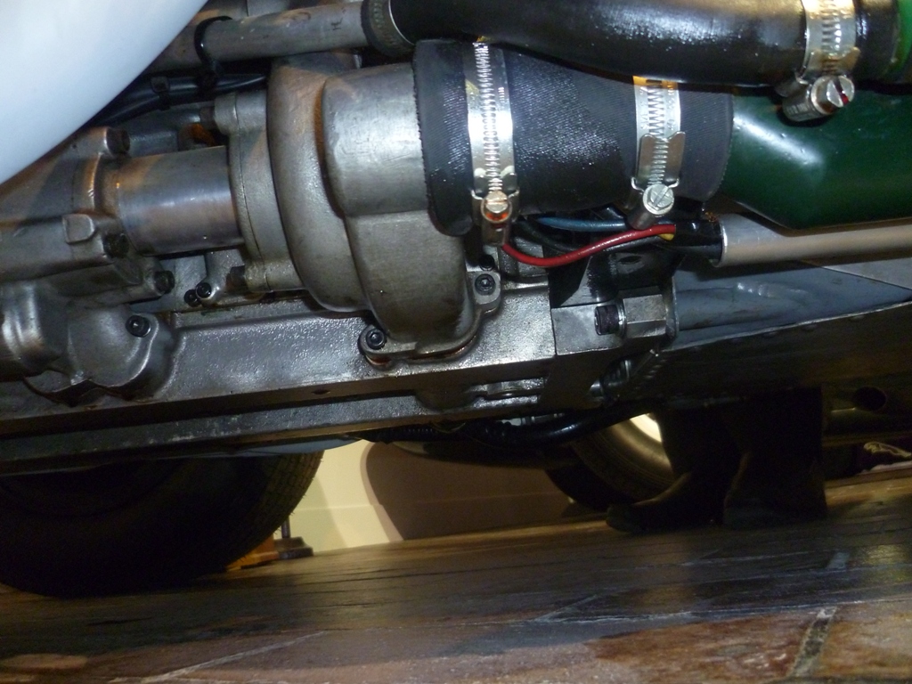

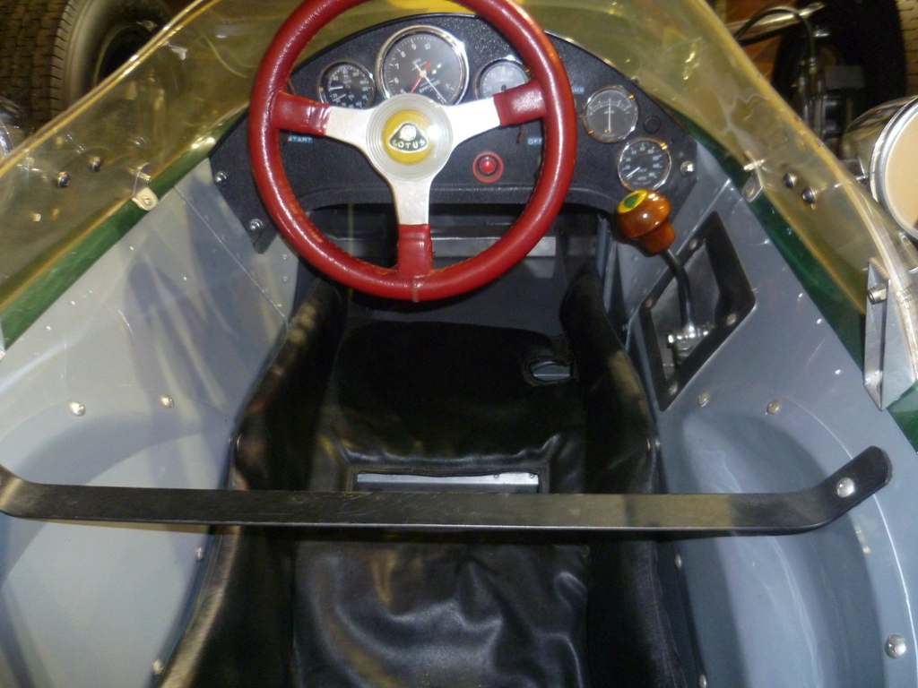

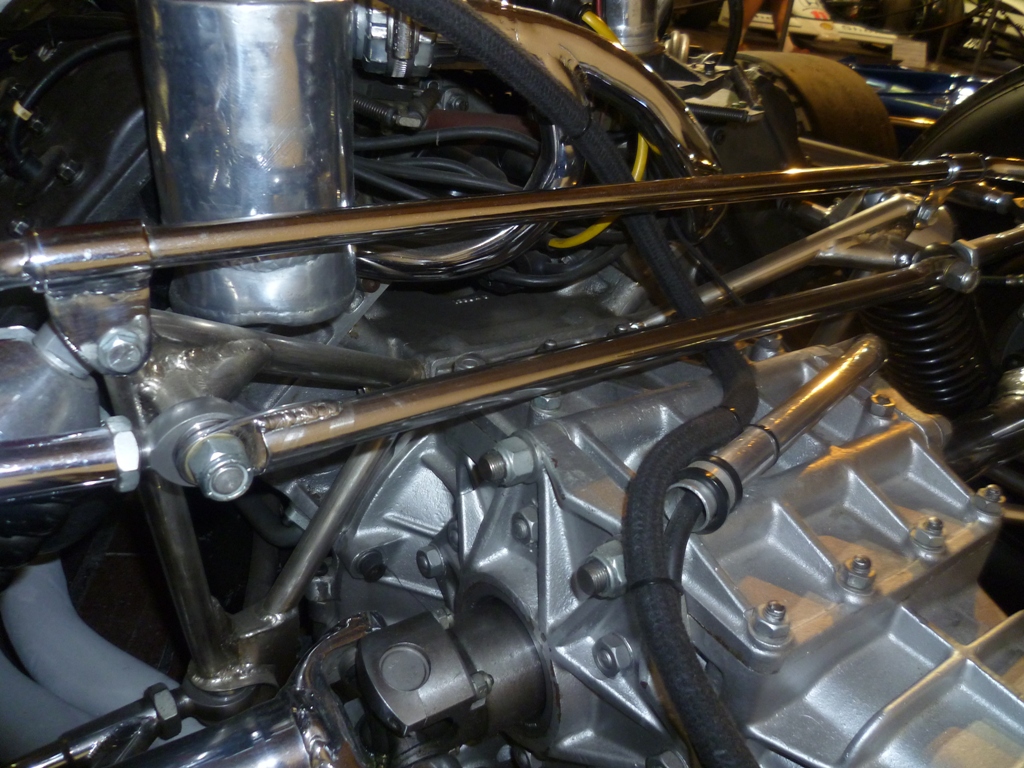

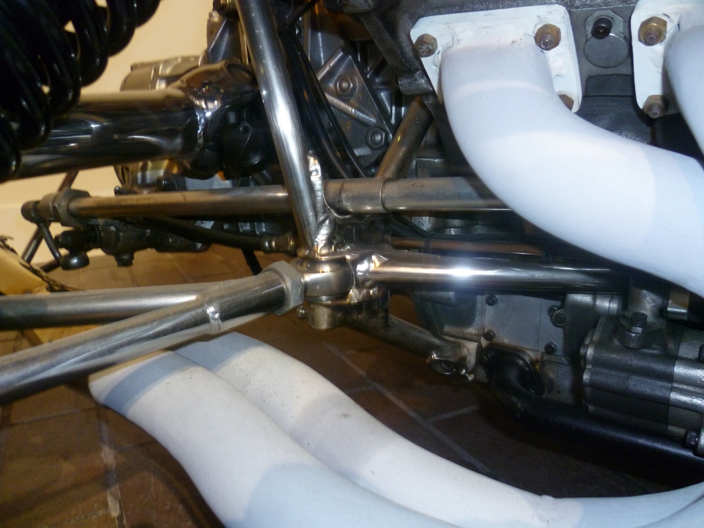

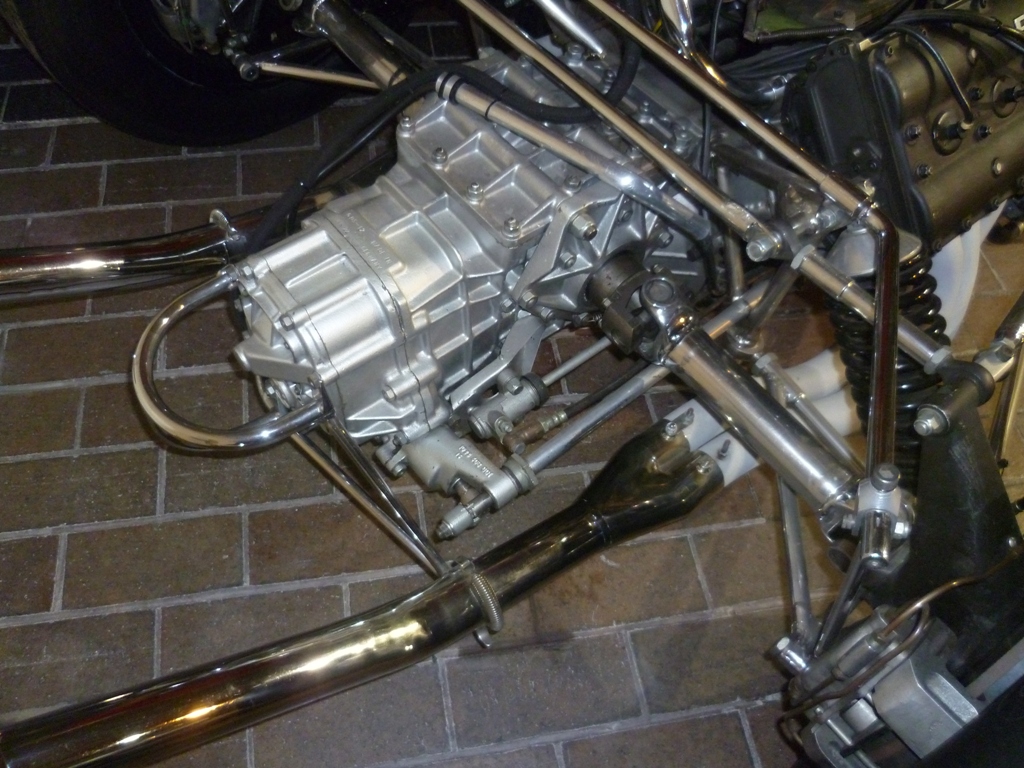

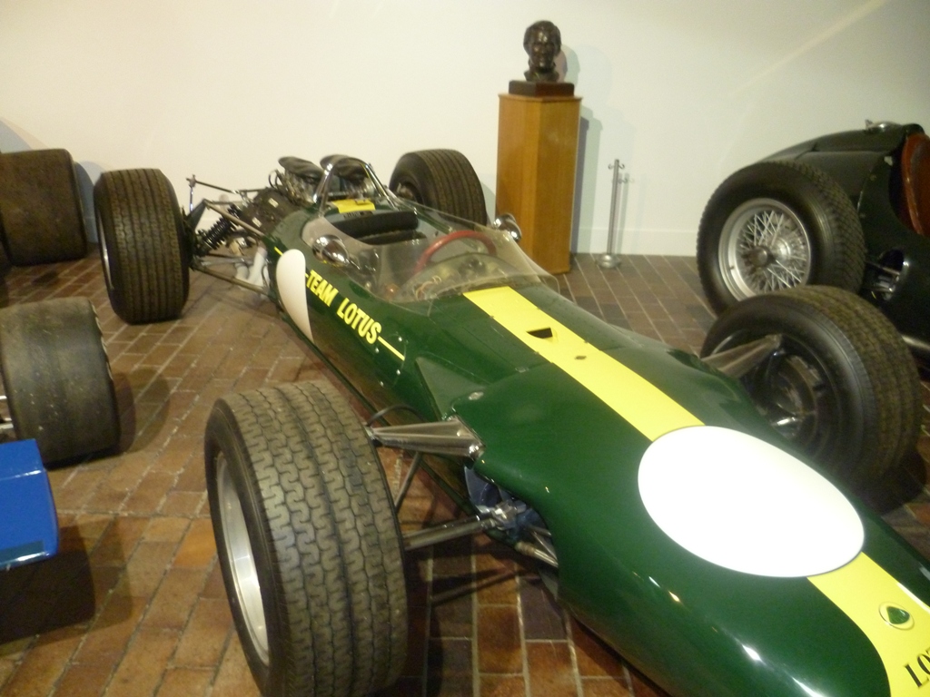

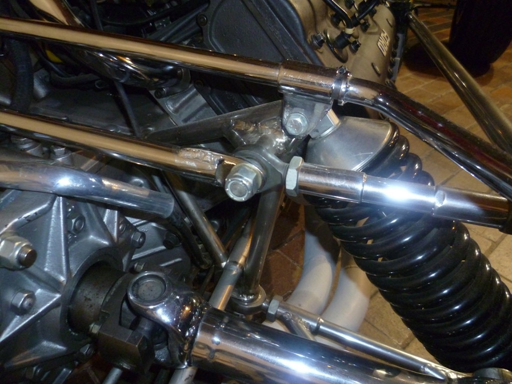

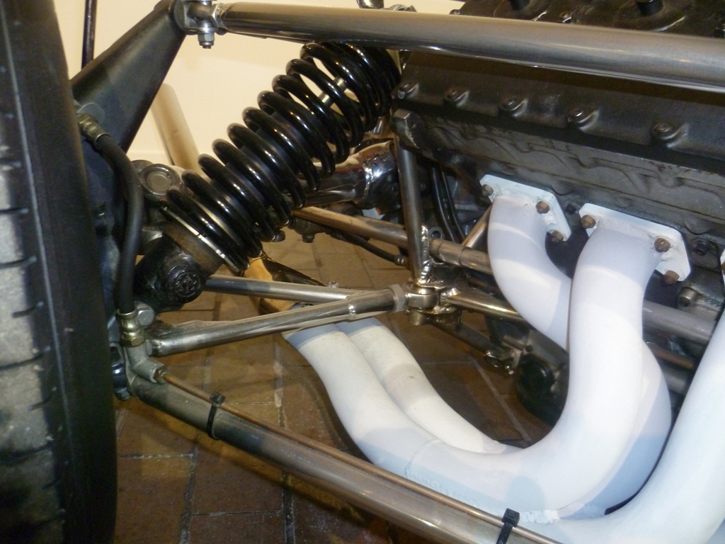

Great project....I recently went to Beaulieu Motor Museum, and took about 30 close up pics of the Lotus 49.
Most of the pics are of the rear suspension, and how it attaches to the engine/gearbox. if your intrested, ill post the pics here for you.
I hope you go all the way, and make a monocoque chassis...

So far the mono version is the direction I want to go, it's just a lot of fitting and fiddling and very limited info to work with. I have to completely redo all the panels as the current ones are too soft of an alloy.
Planning the original style 49,( R2 ) with green / yellow colors, no wing, with two possible drivetrain choices.
My first choice is a DFV or DFR coverted to DFV look. I am also working on a small block 289, which will have Inglese injection, with proper inward tilt on the trumpets, and valve covers I am fabricating which will look identical to those on a DFV. ZF transaxle, which is what the first few had before changing to Hewlands.
Either way I am looking for at least 95% accuracy in appearance, and a usable track car, not a static display. Definitely something to look forward to during the winter months instead of snow.
Mick, any pictures you have would be much appreciated, that is one area I am lacking in for the fine detail.

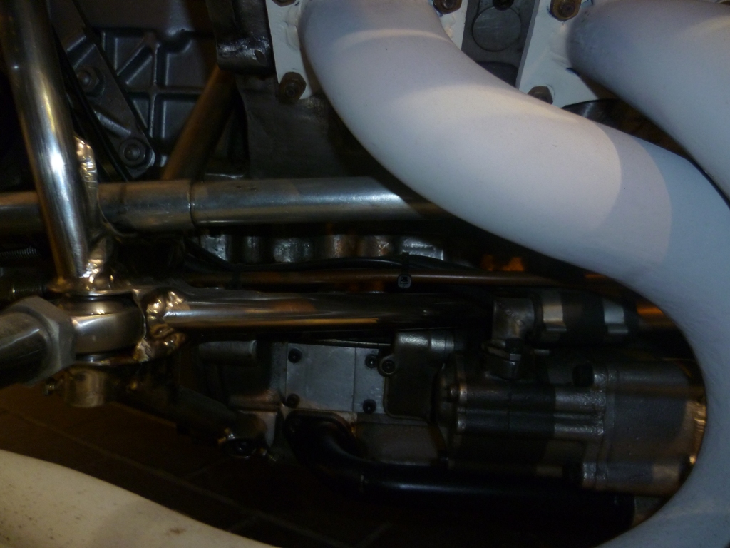

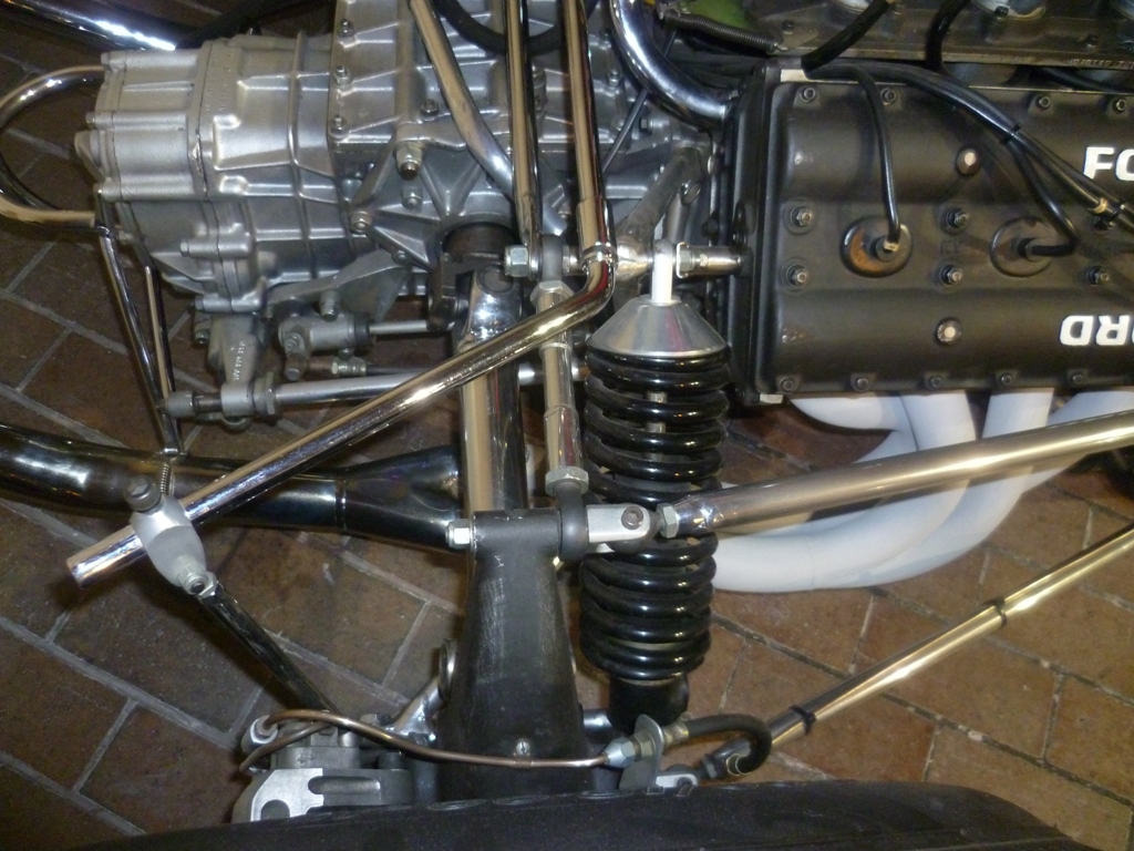

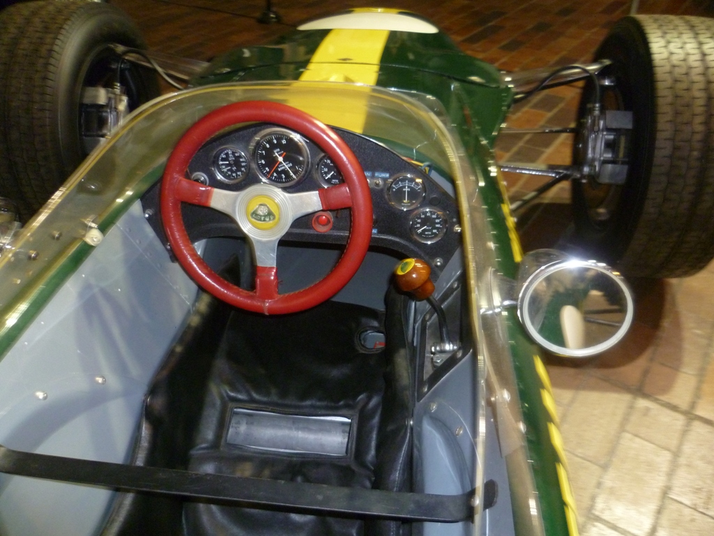

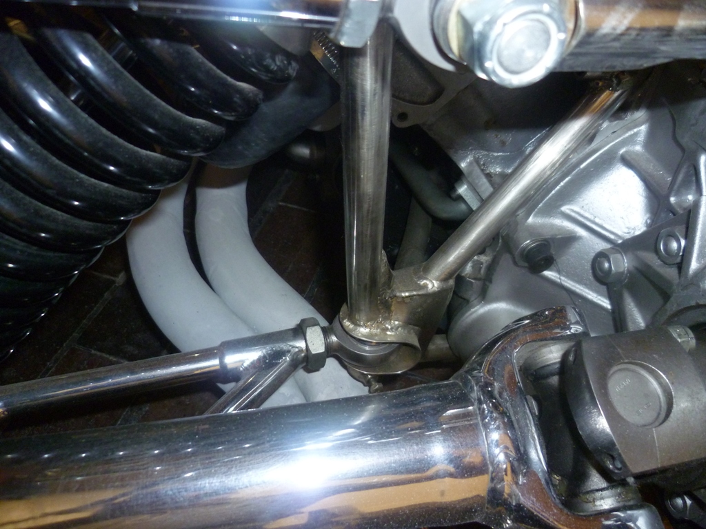

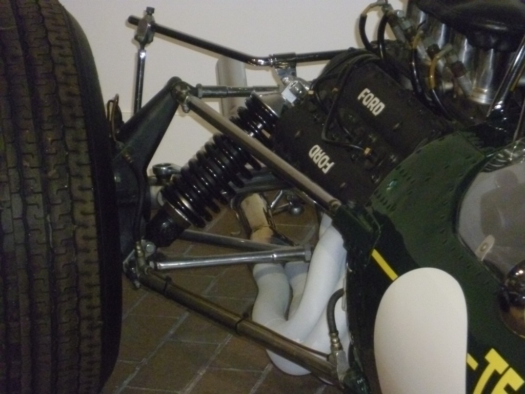

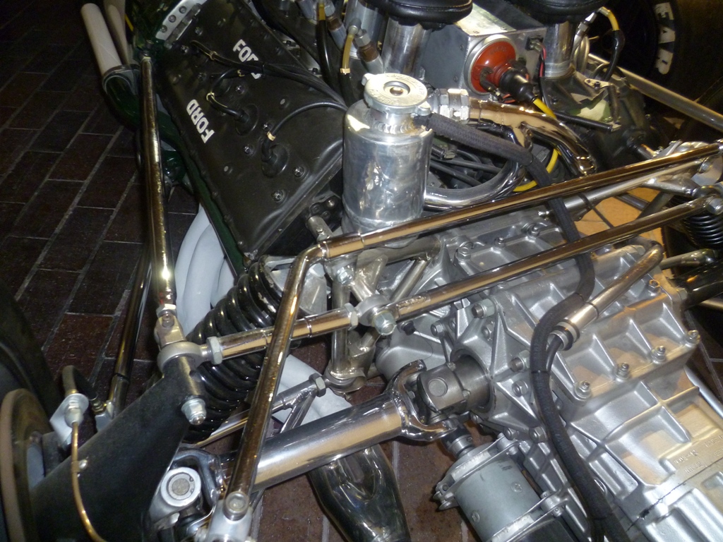

Lotus 49 pics
The Lotus 49 is my favorite car, and its shows Colin Chapman at his best...
Im buliding an alloy monocoque, chassis for my GT 40, and the rear suspension layout, will be based on the Lotus 49. I live about 40 mins drive from the museum,and I would be happy to go there , and get some more pics of the car for you...
I hope you find my pics usefull, and I cant wait to see your car as it progresses
Good luck with your project
mick

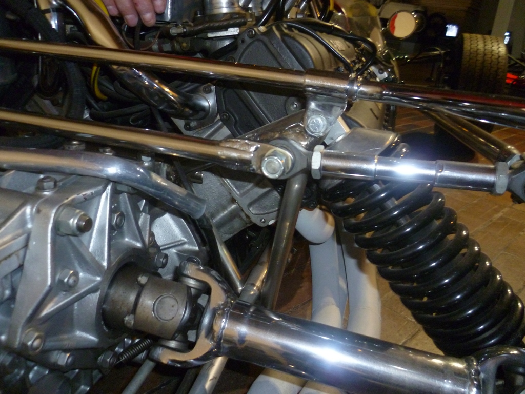

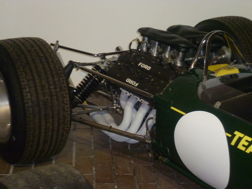

Lotus 49 pics

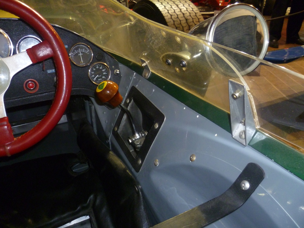

Gordy
A few more pics for you...Im really happy to share the pics with someone who really appreciates them
I do have some more pics but ill have to resize them,,its late here Ill do it tomorrow....
Gordy
Mick,
Awesome detail pics, exactly what I was lacking and they will be very useful in my build. Thanks so much for taking the time to post them.

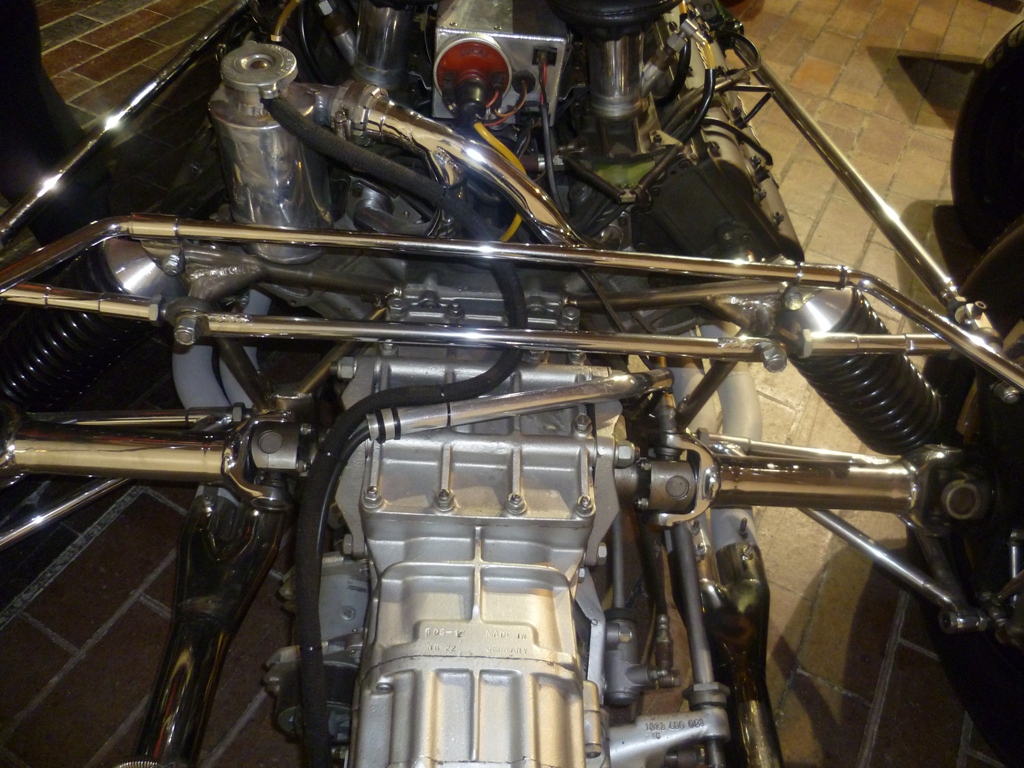

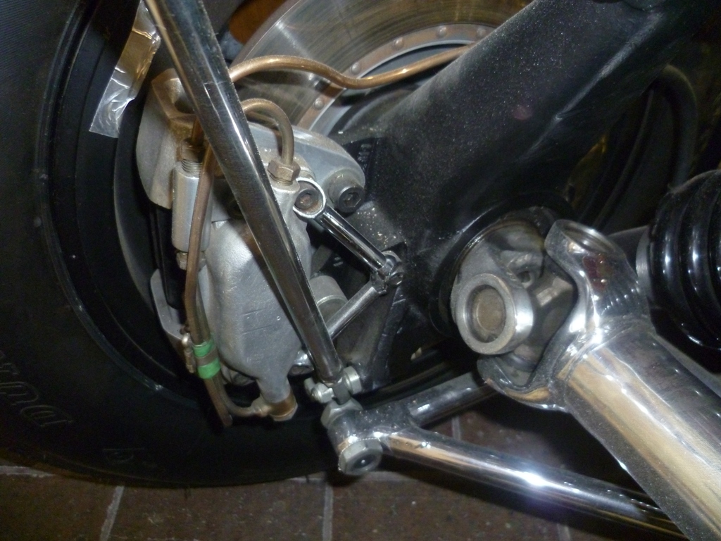

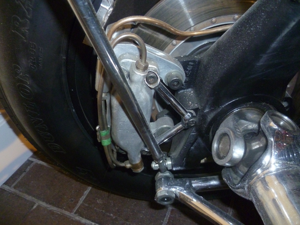

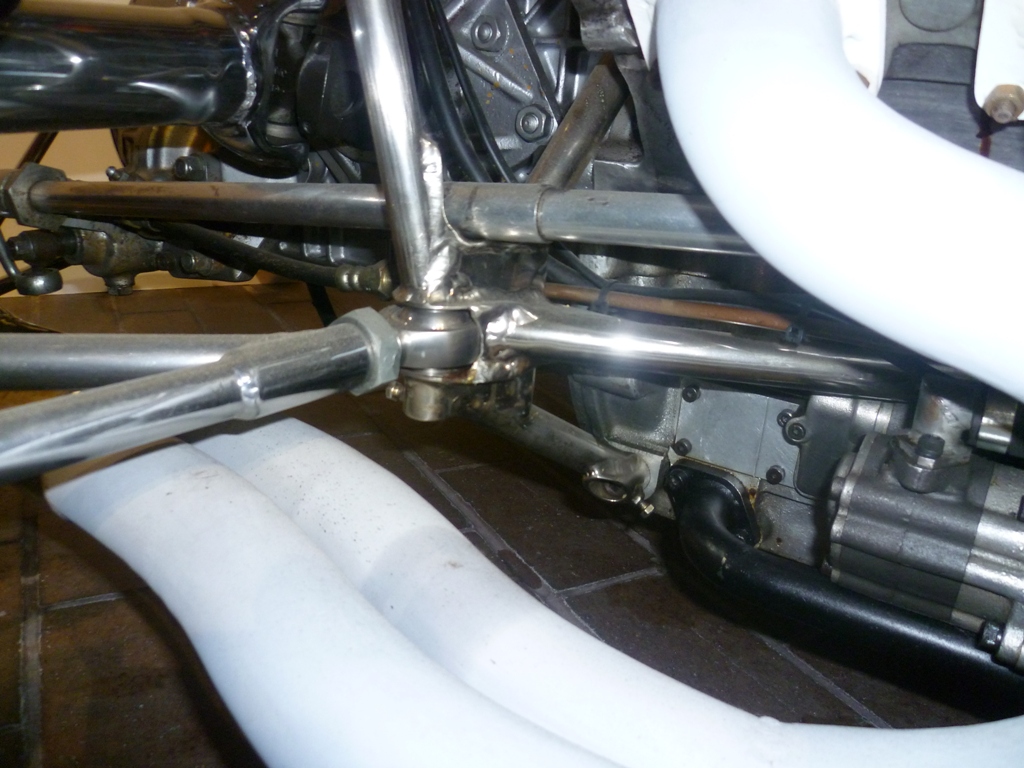

Lotus 49 Pics
Gordy,
Here are the rest of my Lotus 49 Pics...Sorry its taken so long to post them, but ive neen busy on my chassis
mick

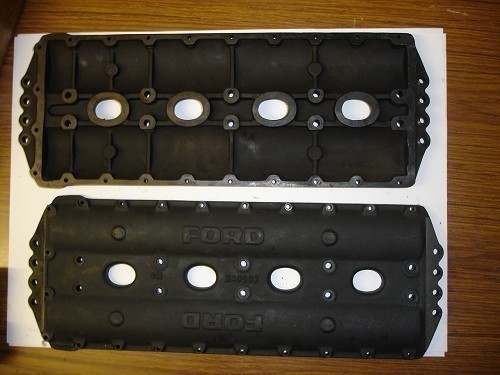

I need some help locating a set of cam covers for a DFV. Here is a picture of what I am looking for. Posted at the usual race car sites, hoping someone out there can help with my search. So far no luck.
I did find a gentleman in the UK, Chris Perkins, who was reproducing them, but have been having trouble getting through to him by email.
Any help or leads appreciated.
