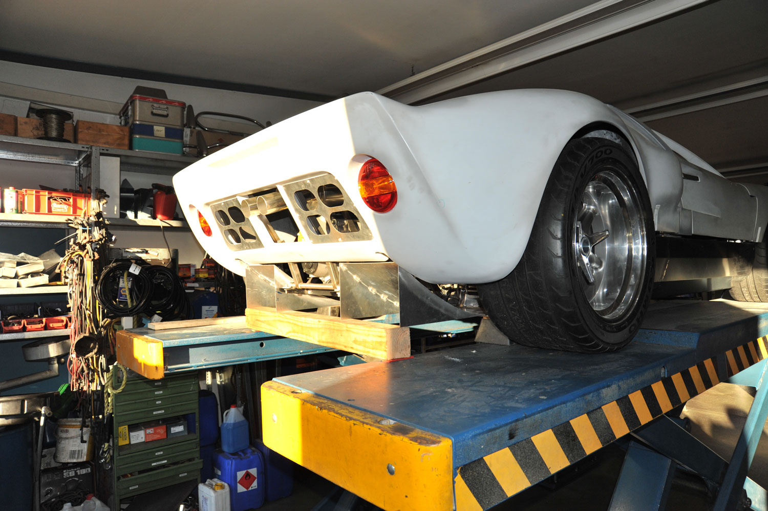

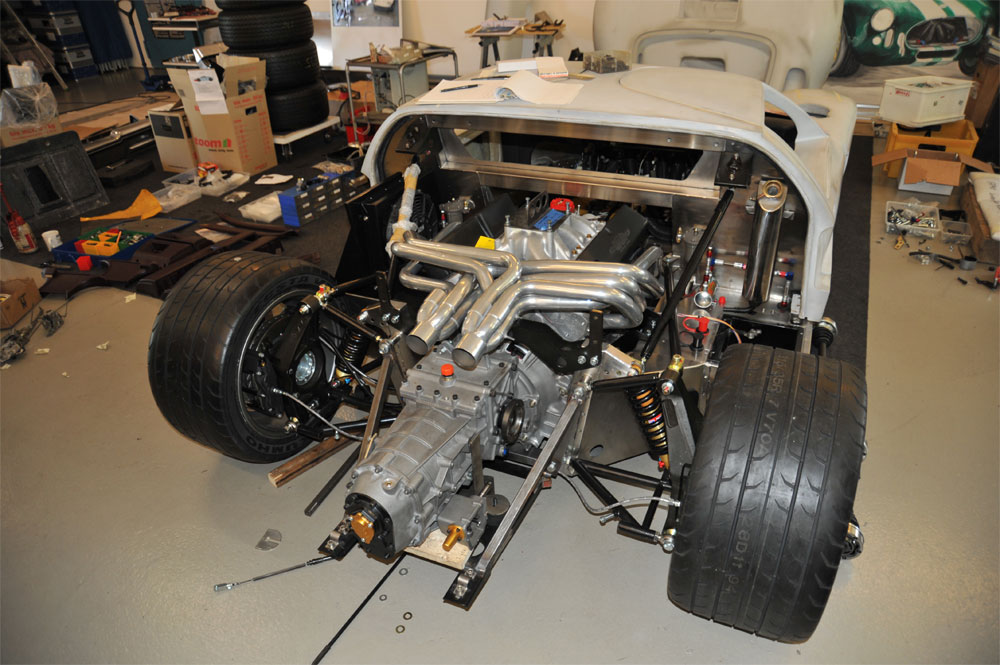

Unfortunately, I have no up-to-date pics in the moment. Only a few which are about 3 weeks old.
What you can see there is the modified rear hood attachement to make room for the diffuser.
The diffuser itself is made from aluminium plates. The top is formed after an airfoil, calculated with a little program to fit in the available space. The aluminium plates are currently being laser-cut and hopefully ready the next days.
The diffuser starts close behind the lower suspension arm and goes from there up to the bottom edge of the rear hood. It will be mounted with a brace at this diagonal bar, going up from the hood mount.
To stabilize the outer plates, we currently plan to simply mount an aluminium bar to the bottom of the diffuser and fix it somwhere in the middle. When the diffuser works good, I will think about something less ugly ;)
The middle section under th gearbox and the opening under the engine will be covered with a removable aluminium plate.

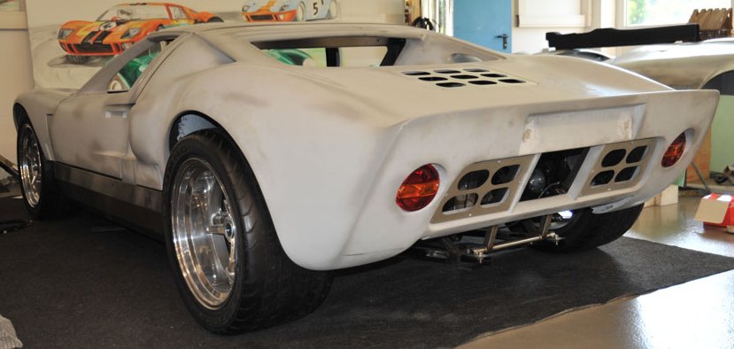

So, after the diffuser channels are ready, here is a first fitting test.
Now they have to be fixed somewhere ;) and the sides and the openings in the underbody have to be sealed with some panels.

No expert here, but shouldn't the airflow be channeled out in a lower plane? Your diffuser looks to me as tough it will cause uneccessary drag by guiding the air upward as it exits the car? Or is that a good thing?

Hi Mark,
guiding the air upwards is really the intention here. This is a key factor of producing downforce.
I am not an expert here, but I have been reading long discussions and many articles about this topic.
An airfoil produces lift, because the path, the air has to travel along, is longer at the upper side than on the underside. This produces a kind of rotation of the air, which is mainly responsible for the lift. This rotation is illustrated in the picture below (source: http://www.diam.unige.it/~irro/animation/prosmo030.gif).
For a car, everything is reverse, we want to produce downforce. So the path of the air over the upper side of the car has to be shorter than the path under the car. When the air under the car comes out horizontally and merges with the air from above at near street level, than you produce lift.
Therefore it is important to direct the air from under the car upwards to produce downforce. A spoiler will do the same, but the drag of a diffuser is lower.
Not that I'm too concernded about drag, because the engine produces about 600 hp and I will hardly reach the possible top speed with my gearbox. Maybe, I add a spoiler later, first I want to see what the effect of the diffuser is. I will do measurements of the spring travel (is this the correct word?) of all wheels and after heavy averaging, one should see an effect of the aerodynamics for different speeds. We will see ;).
