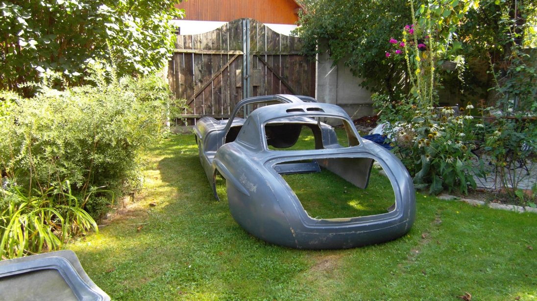

hi & sure....YES WE CAN :thumbsup:
...so i do to replicate my favorite cars ( see my post about the 300sl )

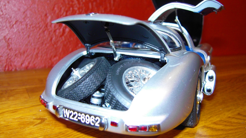

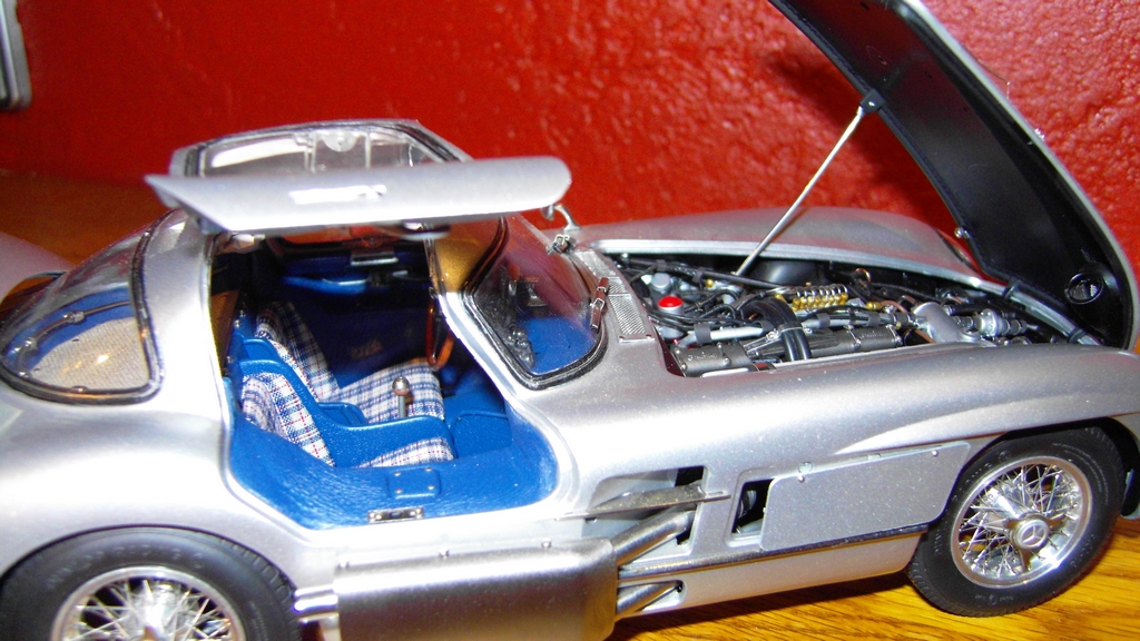

...enclosed pictures showing the uhlenhaut coupe ( 2 cars made ) never sold to anybody....

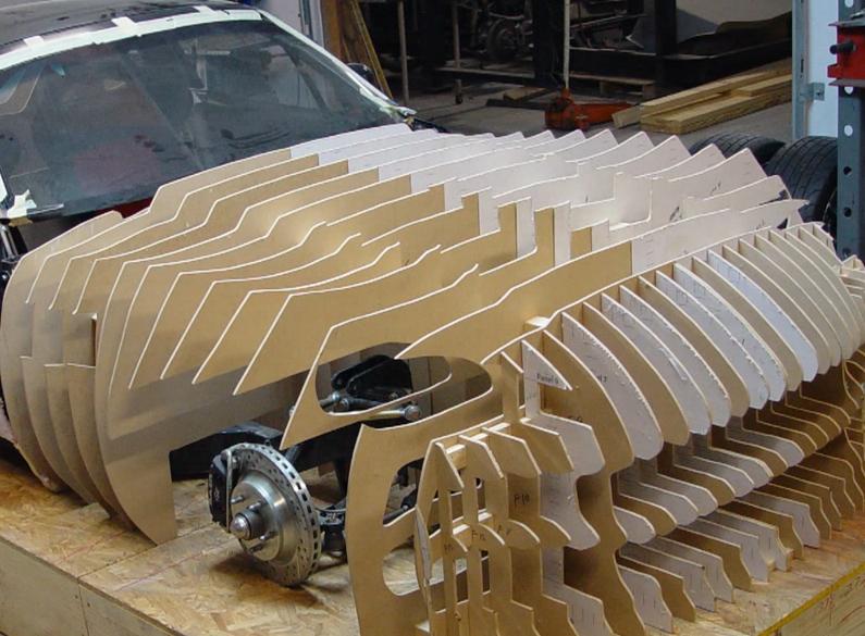

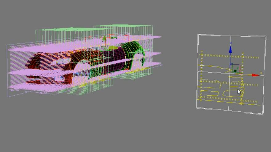

for building such a car, i make an virtual 3d model ( 3ds max ) with reference pictures & a 1/18 model, then dismantle to slices,print them & use as template for a wooden frame & so on. this type you can build a positive mold and use it either for GFK_Negative or to do panelling with sheet metal directly !!!

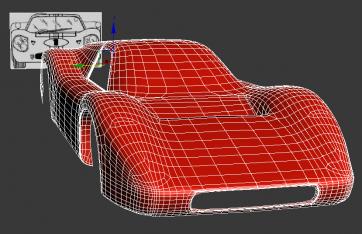

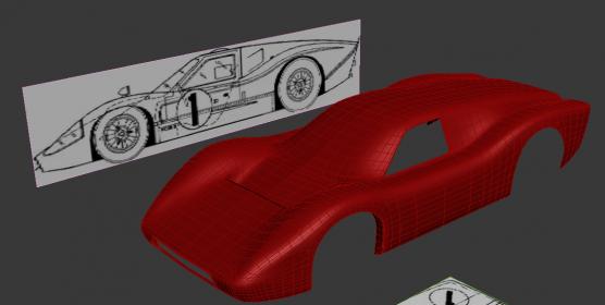

here´s a rough version of a 3d MK4 iám doing, wheelbases and other dimensional data you can get via www.ultimatecarpage ect.
Looks like your using 3DS max for the modelling. I am actually quite handy with max so can you tell me if engineering companies can work from 3DS models if the model is made using correct measurements or do you have to export the models to CAD?

Hi TrevS,
yes iám working with 3ds Max, also with other 3d programs. It belongs to how precise you want to recreate a car.
as long as you can provide any of the following formats (*.3ds / *.dwg / *.dxf / *.obj ) to engineering companies, i think that will work for them ( say they use mastercamX to route their cnc centre, they can load and transfer any of those formats into the cnc ) on the other hand you have to be 99,99% perfect while the hole Pc/engineering process.
for me that doesn`t matter, i do it the old way ( see the pics ), only shapes matter to me + which plattform i will use. iám not at this level, there i can 99,99% recreate a whole car. Take my Gullwing, it will use the proven & reliable running gear from Merc SLK. Or for Trackday_Toy my Matra M650 "recreation"....to match the power & noises i will use a simple lightweight frame with some sort of hayabusa or Kawa zx12 engine.
Things has to be as simple and cheap as possible........
