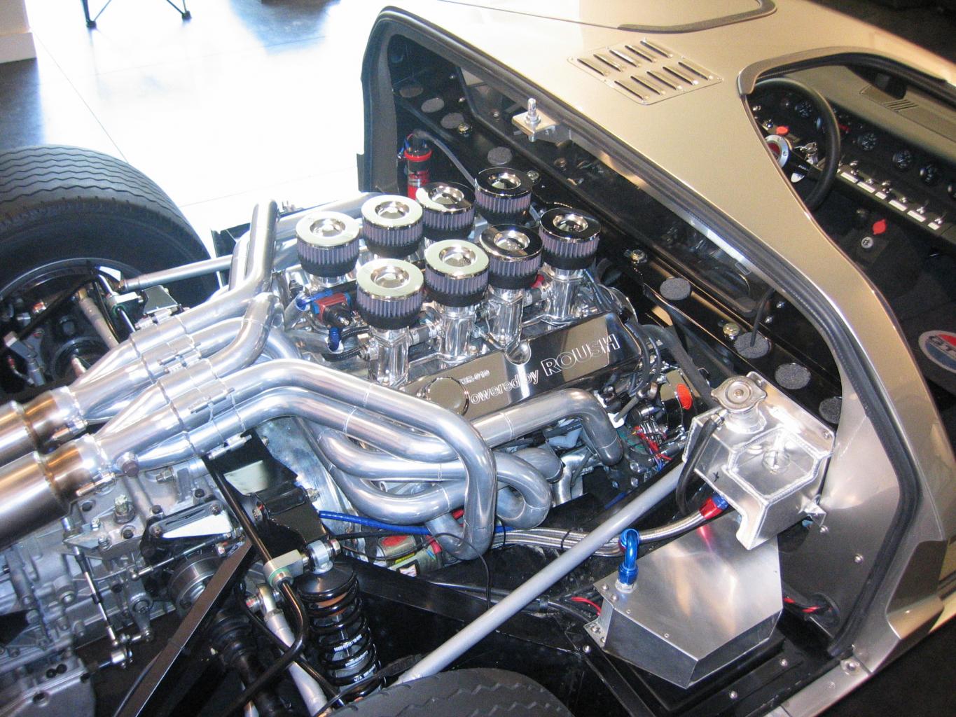

The previous post shows a 351w with Quicktime. The ZF has to be modified as shown. No mods necessary to the front of the mono. The forward edge of the bottom of the rear horseshoe needs to be peened down. Maybe some slight blistering with a body hammer to the access panel if necessary. This is all you need to do to fit the engine/gearbox

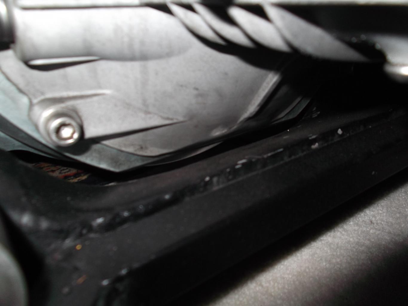

Did some test fitting last night. Don't believe it's going in until I shave off that boss. (In the pic, the rear of the engine has been lifted about 1 inch over the lower crossmember....still not enough room to attach the transaxle with the boss present)

It probably depends on exactly which belt system and water pump you have on a 351W. My Roush 427SR needed a 1/2" 'bump out' in the passenger area of the firewall to clear the alternator pulley and belt. Also the end of the water pump required some hammering of the firewall to clear. I used a heat gun on the plastic trim cover to accommodate the hammered metal of the firewall. Maybe some 351W's will clear with no mods.
