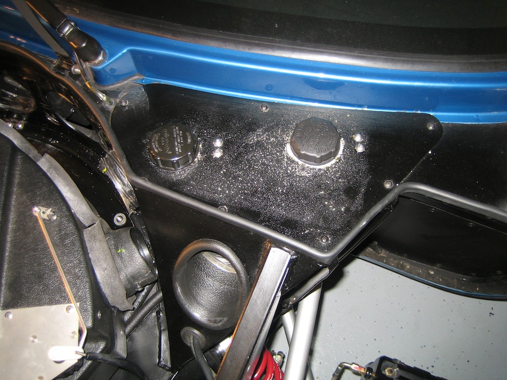

Awhile back I had mentioned my displeasure in what appeared to be some lifting of the paint and at the time questioned paint prep. Now that I am a little deeper into the car I have found what is causing the paint to lift on the front left part of the chassis. It appears both brake and clutch reservoirs are leaking around the caps or through the vents. Does not appear to be any o-ring sealing just plain old threads. Reservoir levels don't seem overly high. Is this a known issue and are there better caps or ways to seal? I'm going to have to scrape a lot of paint off the chassis, clean everything thoroughly, and repaint the affected area. Not particularly pleased :blank:

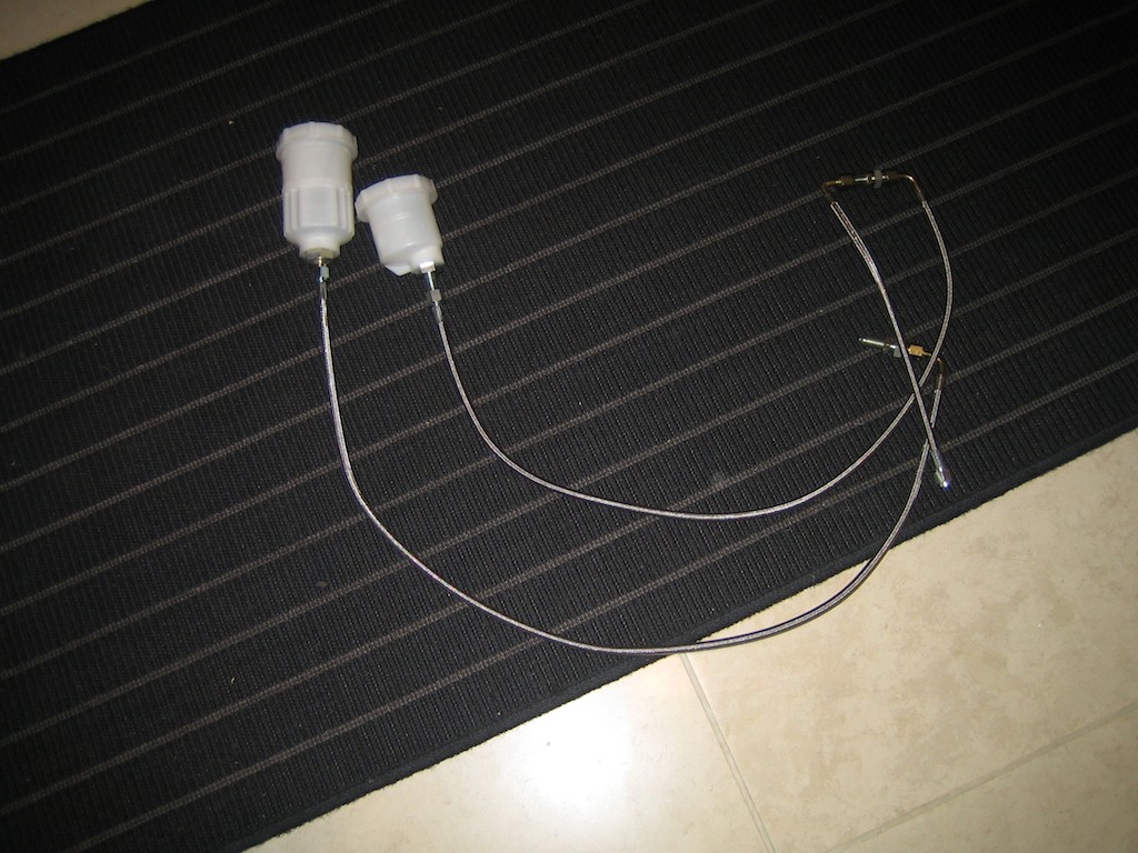

I am in the process of retrofitting all new clutch and brake canisters with plastic ones from Pegasus racing. Steve detailed how he replaced the rubber lines and canisters, I am following his directions.
The only reason I mention this is that even if you fix the o-ring, these metal canisters have a tendency to rust; you might find it better to fix everything at once.

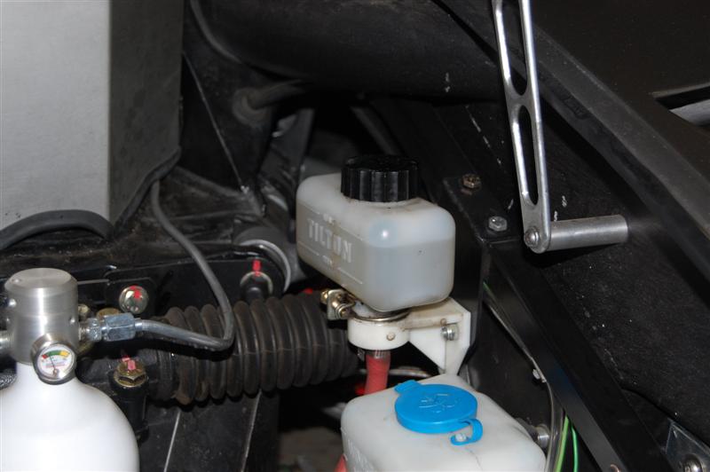

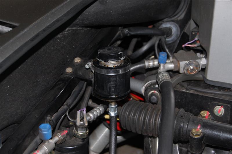

Dave, can you post pictures of how you mounted the plastic canisters?
These are the relocated reservoirs. I haven't replaced the steel clutch one with a plastic one yet, but have that on my winter list. I fabricated simple brackets that bolt to the square tubing on both sides of the compartment. Mount them high enough so that they're above the hoses entering the cockpit, but low enough to clear the nose. May have to move the washer reservoir slightly, I don't remember.

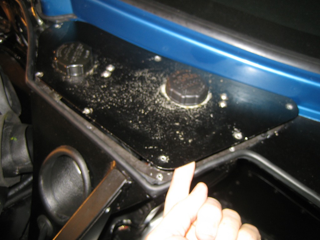

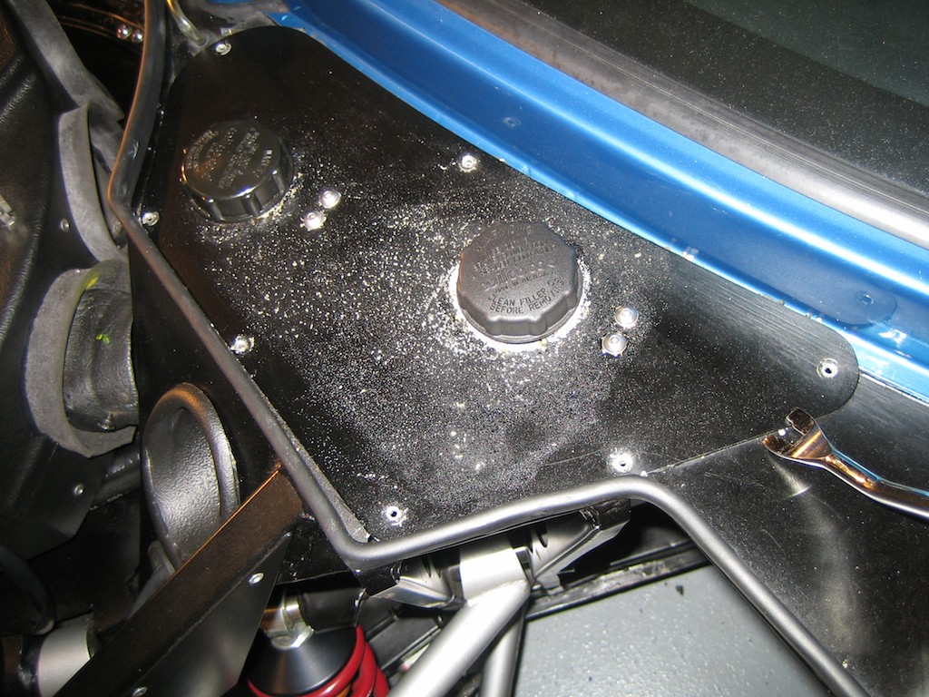

I spoke this week to Dennis who suggested suggested some new better sealing Wilwood caps as a solution. In an effort to clean all the fluid up before I repaint, I wanted to look under the top cover over the reservoirs and make sure there was no fluid leaking inside there. I am struggling to figure out how this thing comes apart and would rather not just start pulling things apart. I seem to have misplaced Dennis' cell # and would like to get this done today if I can. Would someone mind sharing with me what steps would be necessary to remove the panel and get down inside that void? It appears the cover would come off if I could get a wrench on the nuts underneath and remove the reservoir brackets? Doesn't seem to be very easy when the cover will only come up a fraction of an inch. Thanks
Michael, I am in the process today of pulling that apart today as well. Here are the steps I went through:
1) Remove nose
2) Remove the 7 or so screws around the plate
3) I use an interior panel removal tool or a plastic screw driver to slide in-between the chassis and the plate to lever it up. The plate has adhesive foam attached to act a "seal" (it is not very effective but that is another story), this can make it hard to remove at times.
4) Use a flashlight to inspect, the hoses are not super long making allowing only a small amount of room.
5) You can also remove the canisters from their brackets at this time to really get in there.
