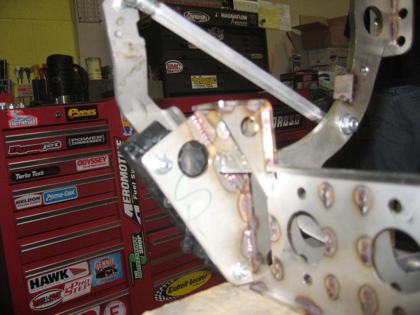

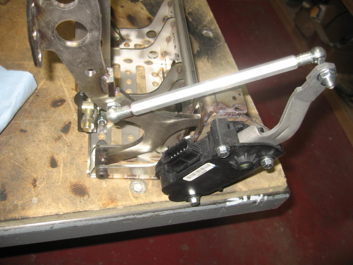

RCR pedal assembly with DBW throttle attachment.

Similar to Wayne's. A short linkage rod runs between the RCR pedal and the LS DBW rheostat, taking the GM pedal off. The key is to ensure that the rheostat arm (and the RCR pedal) travels it's entire arc without binding. It just takes a little time and maneuvering of parts to get the right geometry.
I cut the GM dbw out of the wirign harness so it had enough slack to make it through the center chase that runs through the gas tank. Then i didnt have to splice gm's 8 wires.
i used 2 mcmaster clevis's to have frans pedal actuate the dbw. i think i like waynes idea better though. His heims look to have less of a chance to get jammed?
