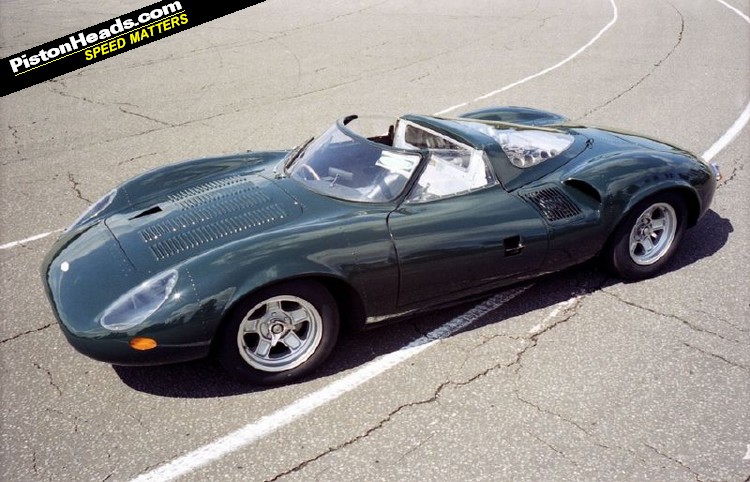

This may be a roundabout way of saying what Molleur just said, but having just finished reading the new Jag XJ-13 book and learning that its windshield is still being made (sort of) its windshield springs to mind. I suspect Fran could supply one or you might be able to get one the way other XJ-13 builders do.
I love the XJ-13 (got a model of it in the den) But a B-16 is probably more in line with size of a Lotus Europa. I'd have to check what the wheel base is in comparison. I fell in love with the design back when it was still available as a kit car. But have no idea if there are any of the windshields availabe today
