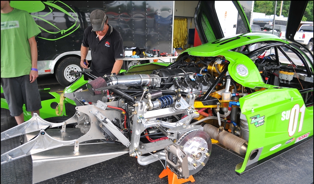

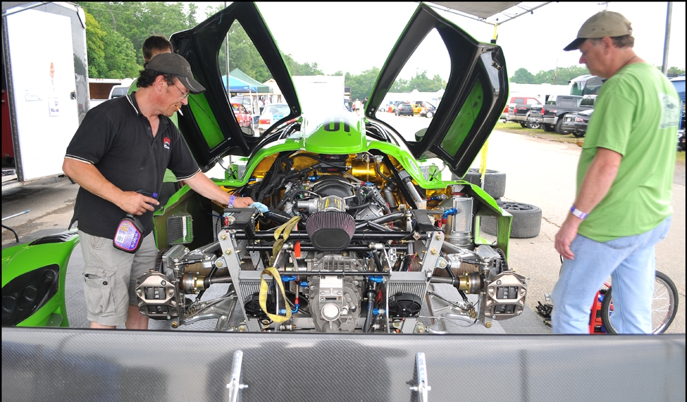

Dean - I'm sure there are better pictures, but if you look close you'll see some coolers/fans.
IMO, the best spot for a cooler is in the side scoop area, unless you have the side exhaust. You will have to fab some brackets anyway. With the Ricardo gearbox the room for a rear mounted cooler and exhaust is limited. Anyone else care to chime in?

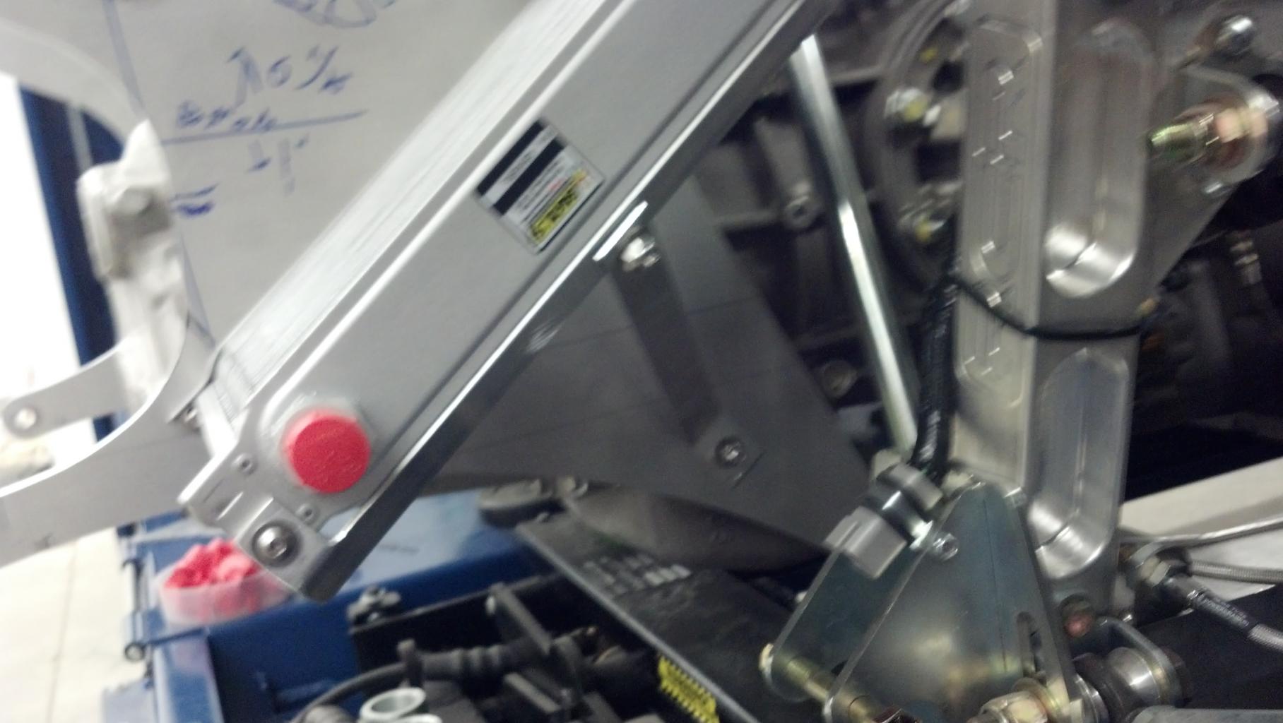

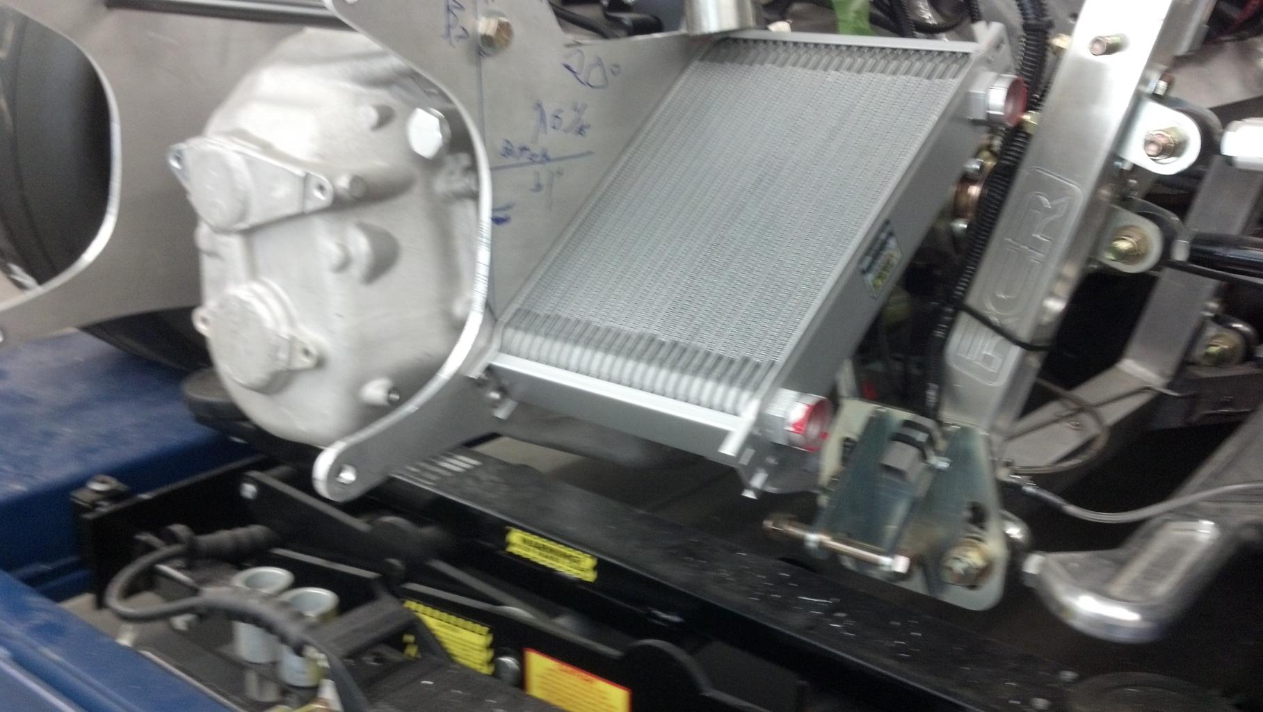

I mounted the cooler today. I put it in the scoop area sort of. I have side exhaust so I had to really tuck it up out of the way. I will add a heat shield once the body is mounted for the last time. There was no way to mount it in the rear where the factory car has them mounted. My cooler is larger with a fan.

Dean, I mounted mine like the race cars but I turned them 90 degrees so the top is towards the front of the car. it seams like it will vent better that way with the street tail and wing
Wing mounts, I go to VIR to play on the track for member days, but I wanted to drive my car on the steet as well so I told Fran to set me up similar to a GT3 RS so he picked out what would be the best options for that. Unfortunately they did not tell me that the tail would not swing up with the wing mounts in place, so they are working that out, they say they will have a answer in a couple of days. Currently you have to lift the tail off the car, not good for checking the engine out for leaks or fire by yourself.
If you have the race tail, you should mount your coolers like Frans. with the street tail they flow into a dead space, but with the race tail they work great where he has them. I still think the outside of the cooler needs a brace so it doesn't strees fracture itself to failure.

The race car ran the street tail last year but this year he is running the race tail. I believe those pictures above are for the race tail set up.
