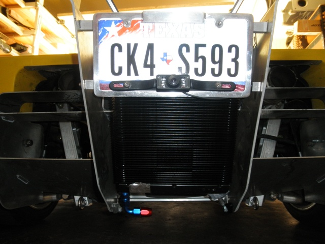

The trans fittings are AN 8, I used an8 90 double females from earls and then used a an8 to an10 male union followed by a temp fitting which is now on the wrong side of the cooler,(thats what i get for guessing) I went up to 10 to accomidate the an 10 cooler Fran gave me, also they provide more space for the temp probe so it does not reduce fluid flow that bad
The day I put that B&M cooler on, all my boiling probelms went away. well spent $100. it only boiled on track days though. teaspoons, but its $10 a teaspoon for that oil....

I placed my cooler on the driver rear scoop side, so I've got to make a bit of a trip to get over to it.......
