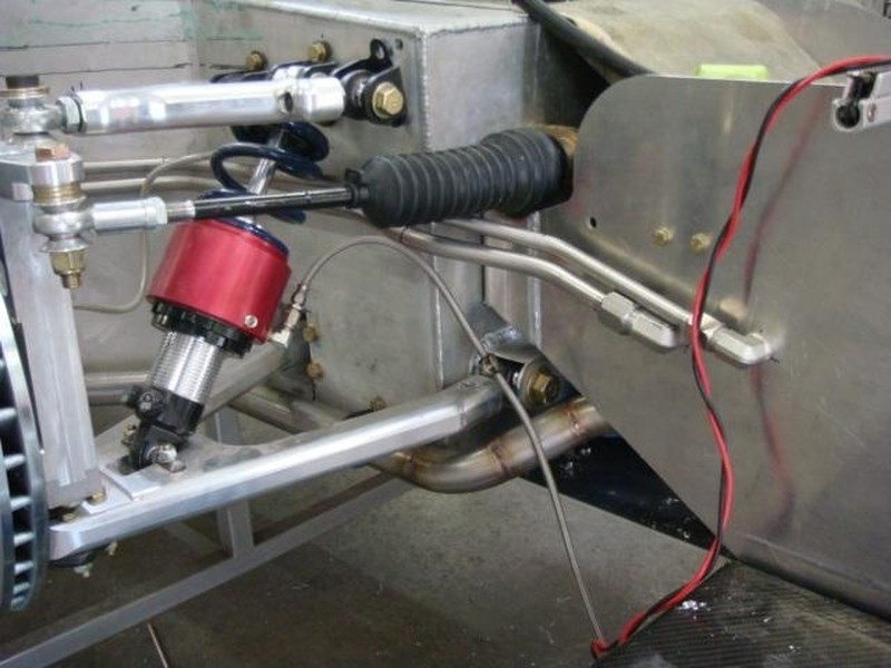

I've been trying to wait for someone from the SLC crowd to post, but here are a couple of pictures and a video of my car, to show how the lift works. I am using the RamLift Pro, which Fran sells. I'm from the GTM crowd, but I see an SLC in my not so distant future. So here you go. When I bought mine, Fran didn't have any in stock, but pointed me toward his supplier in order to buy direct...
As you can see in the pictures, the ram is fitted on the lower perch, below the spring. When it is activated, it pushes up on the spring, causing the shocks to extend, lifting the car. It gives me a couple of inches of lift at the nose.

RamLift Pro Pump:
The Ram Lift Pump was mounted on the driver's side frame wall at the control arm mounts. The pump reservoir is mounted on the block off panel behind the radiator.
The system is activated by a toggle switch mounted on the console. I'll probably change it to a momentary switch though.
Thanks for the photos. I'm looking for ideas on where to put mine, so your placement is quite informative.
You should get in touch with Roberto (Stage 7). He mounted his, on the opposite side wall of the front compartment. In this pic, you can see the pump and reservoir on the left side.
