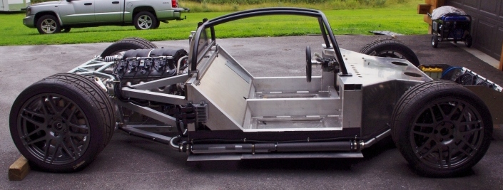

Here's a pic of the cf5's in matte black on an SLC. So far...I think I'm the only guy on the forum with the Forgestars. The funny thing is, I was looking at Forgestar's before I even knew they were offered!
I have to give credit to Fran. He made a great choice with these wheels... :thumbsup:

F14's - "gunmetal" on SL-C
Thanks for the pictures Yos, those look amazing on the SLC. The F14 look real good to. I like a nice simple wheel and Forgestar make wheels that fit that bill. Since I am looking to emulate the F1 LM I plan on getting the F5 in a copper color if possible. On the website custom colors are available. How much would it add to the cost if available? Thanks Fran!
