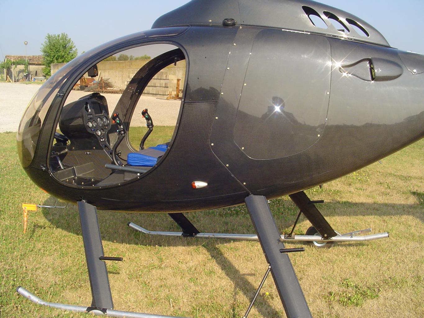

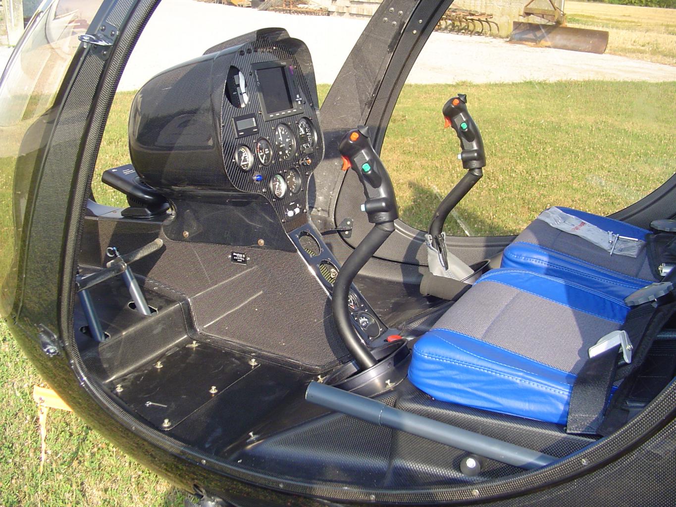

Using existing molds and a very special quality of low temperature Prepeg carbon fiber can give you avery light and very nice look result ( see my chopper using this process some year ago )
As usal it's only time and time is money !!
The fact is you need an autoclave able to handle molds volume ( need a cure of 12 hours at 50 to 60 °c and then out of molds another cure at 90 ° C for 4 hours )
Another big work is to achieve very neat biiiiiiiiiiiiiig vacuum bag around each mold and this is a lot of hours to check and seal any vacuum leak
for now I know only one factory in Italy able to do a good work using polyester molds ( and not epoxy as usual in carbon world) and that low temp carbon Prepeg)
