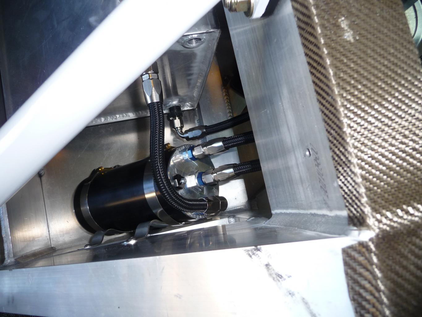

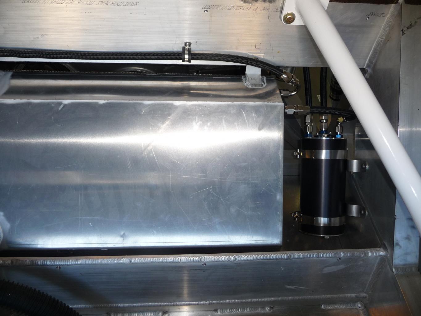

I'm using this setup. My reasons were:
1) It's big enough for my engine and application. I'll be putting out 400ish HP and should I ever take it to a track, I am unlikely to be on tracks with huge, giant long sweepers where I could theoretically run the risk of drying the system out. Local tracks to me are the pretty twisty Laguna Seca and Sonoma.
2) Street application. Occasional track days. Don't need a huge system.
3) Submerge fuel pump -> quieter.
4) Clever design. I like how you can mount it vertical, horizontal or any other angle. In my case it's mounted behind the driver at a 45 degree angle to the frame rail.
Hope this helps... my car doesn't run yet, so I can't say more than the above...
Tim

Tim, I'm looking forward to hearing a performance report on your Mortorsport Fuel Surge Tank once you get your car running. I was attracted to the FP34 044 for the very same reasons as you: Minimum track use and versatility in mounting.
Could you please snap a couple photo's of your fuel pump installation.
Thanks for the in-put!
Jim
That looks great Tim! Very clean... :thumbsup:
Those are the same type of braided lines I'm using too.
