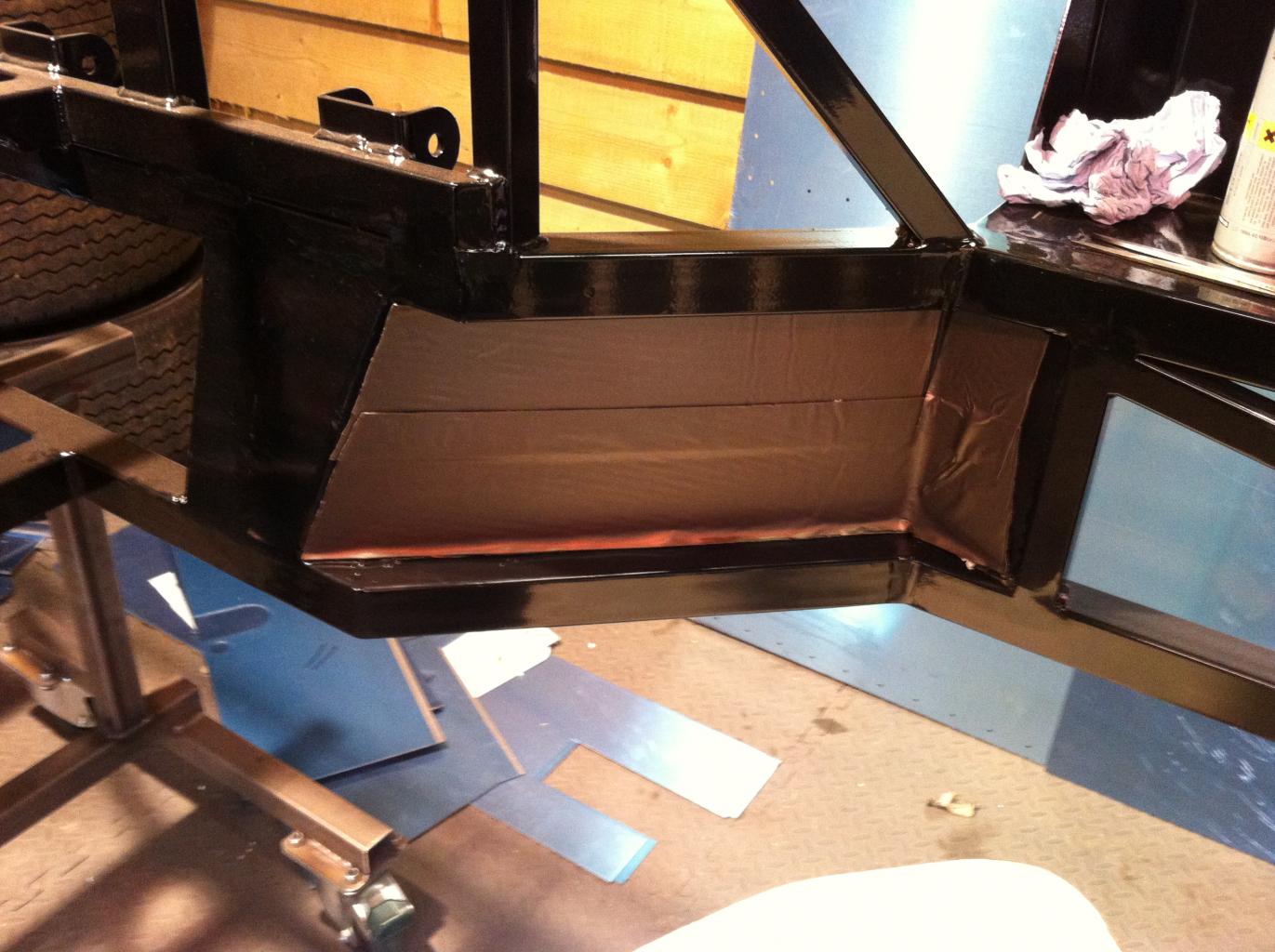

Inner Cockpit Skin

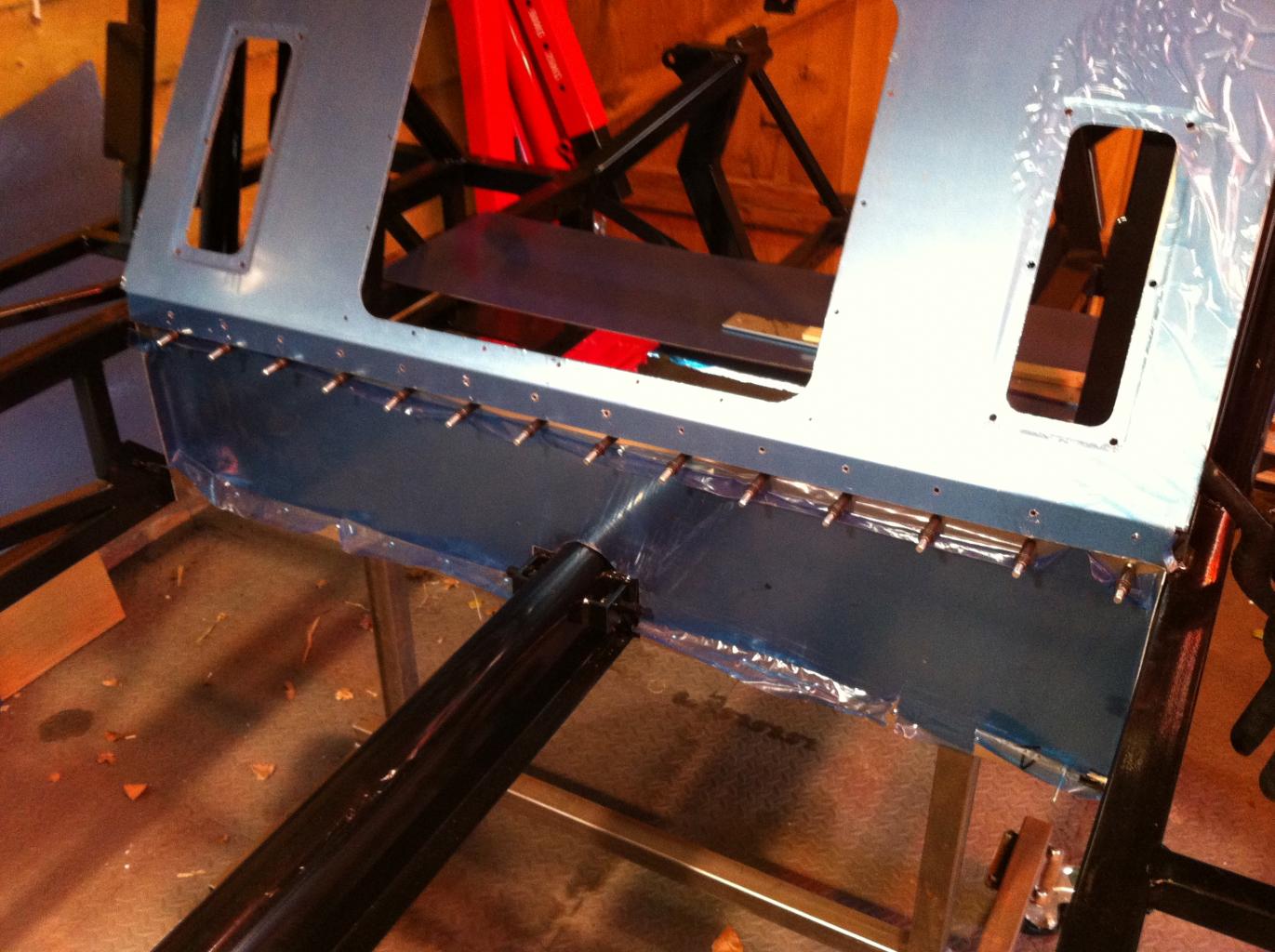

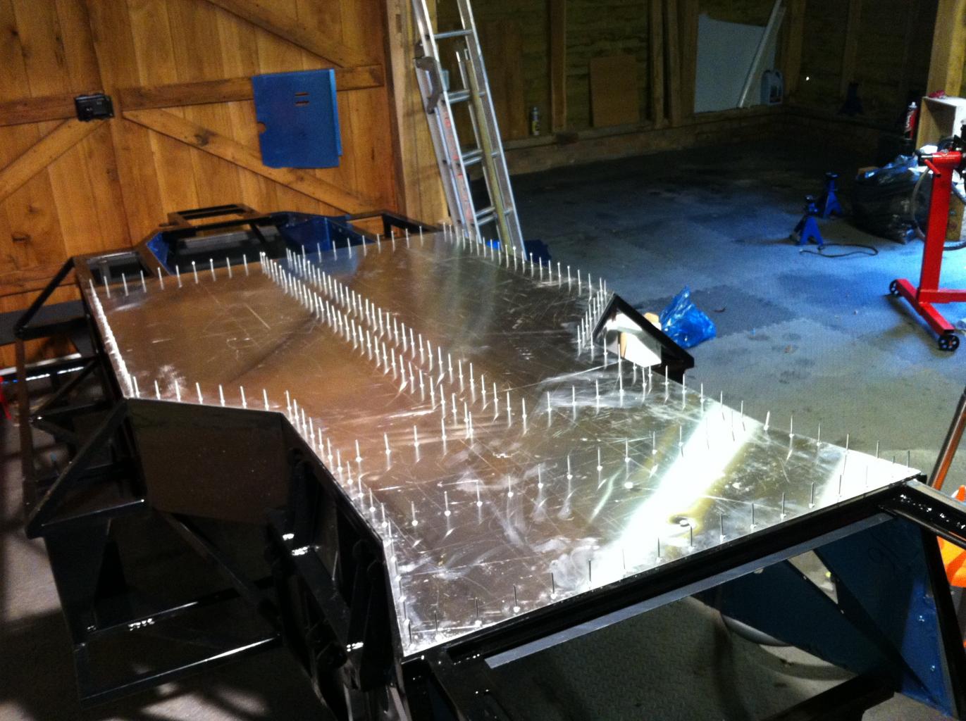

Got time last week end to do the inner cockpit. I must say I am impressed with Southern GT panel kit. It is nicely pressed and seems to fit well with some nice detailing. They recommend that the rear panel be done first (not the floor!). I thought this would present an untidy finish when you come to do the inner rear bulk head. So I presented both and pre drilled the rear bulk head at the same time. Then used temporary rivets to hold while sealer set.
Good idea to do inner panels first and not the floor, against my natural tendency to do the floor first! you can literally sit in the car and work making fitting easier.
I will use sounds proofing in all panels. two stage i. sticky back ii. high density foam all designed for sound and thermal protection.

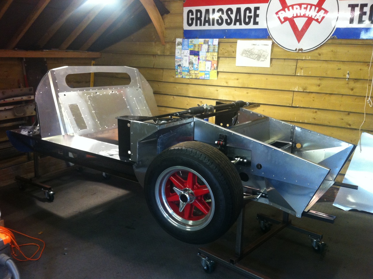

Footwell and Engine Bay

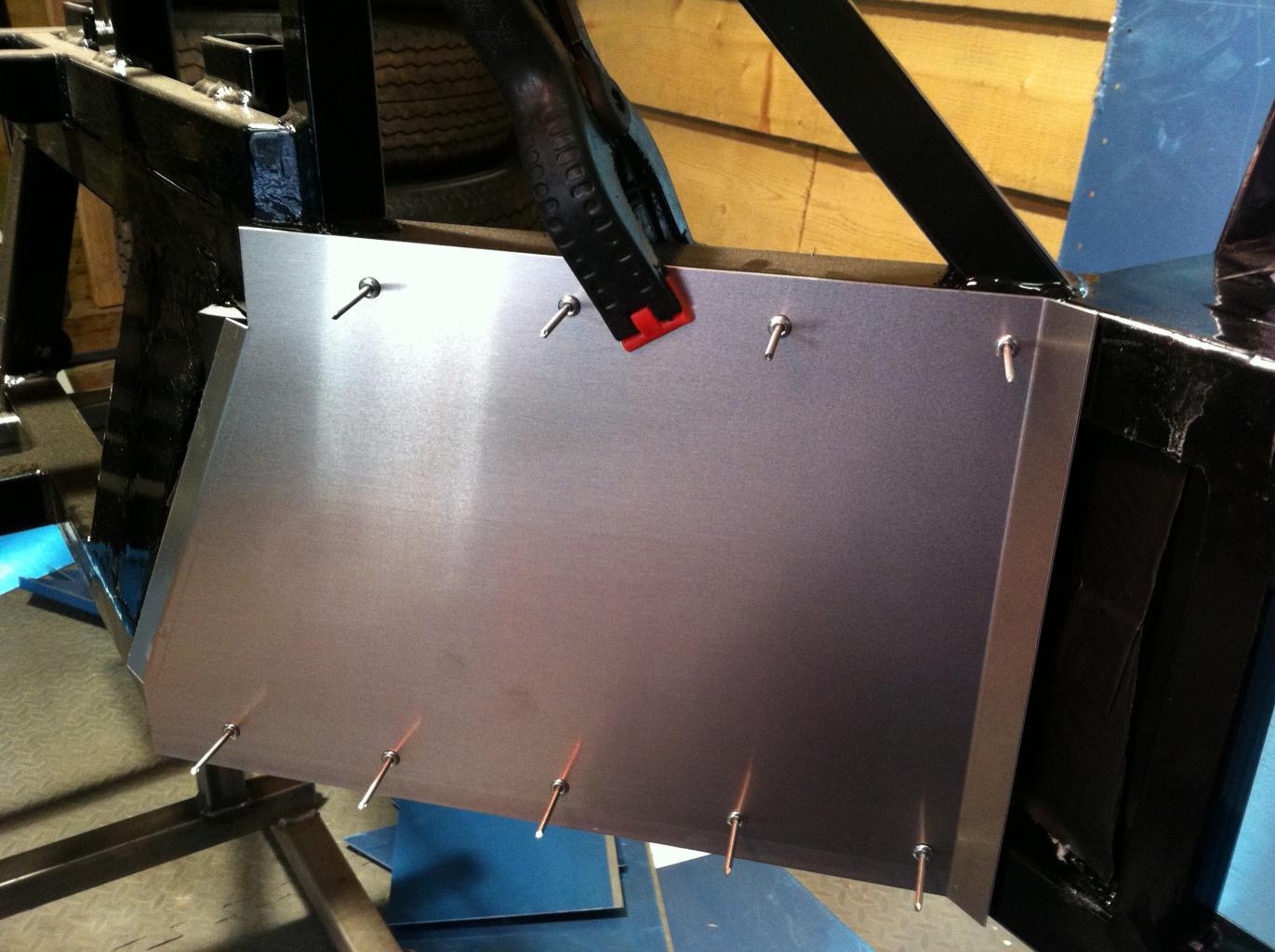

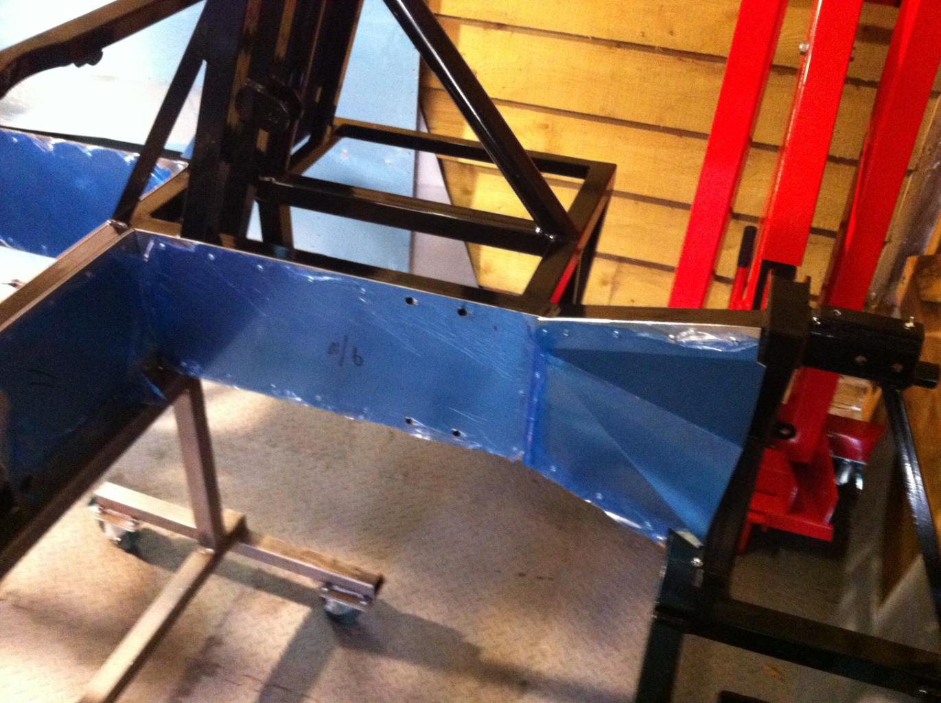

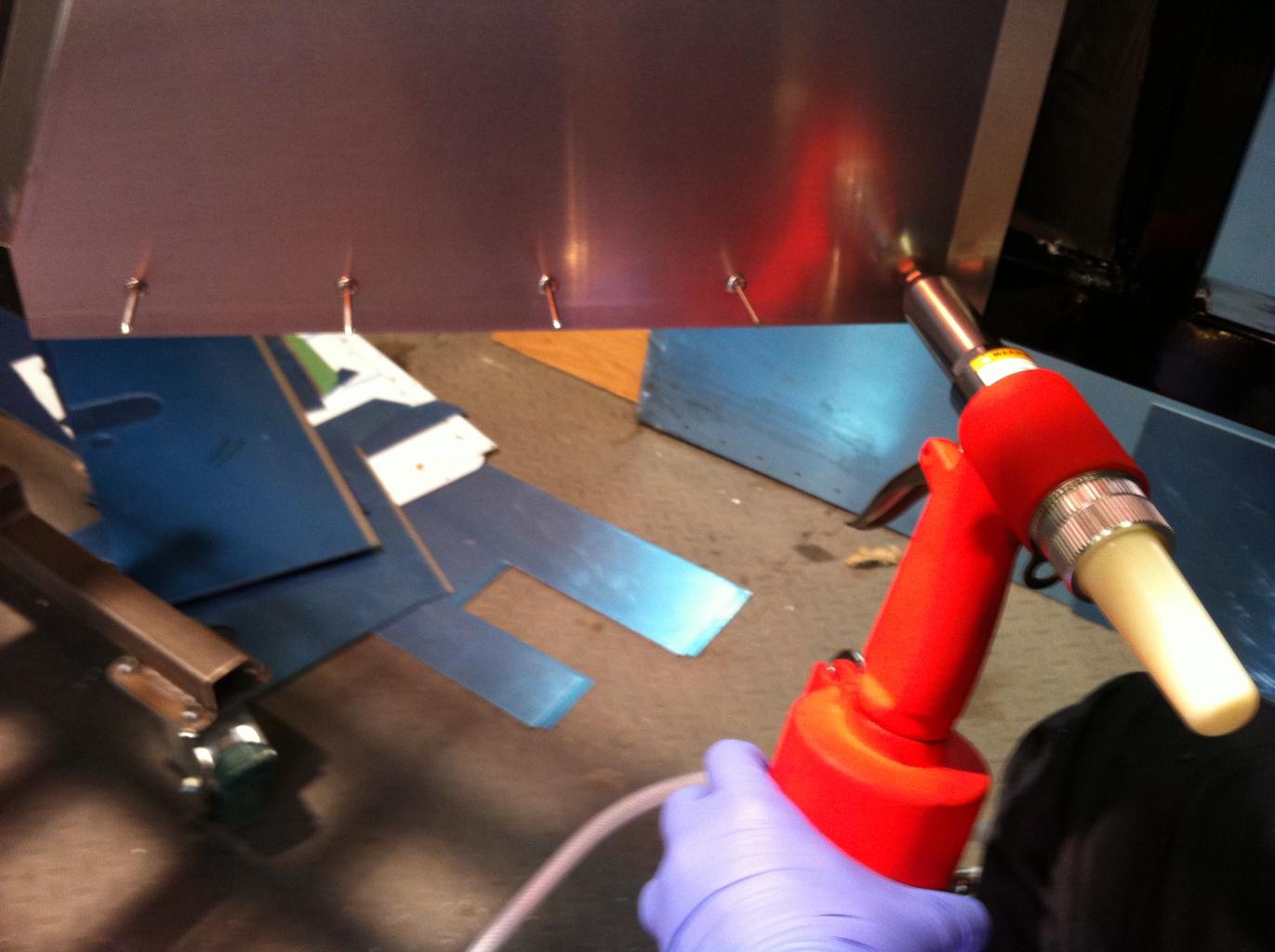

Got some time last weekend to do some panelling. All went very well, no problems with fit etc.

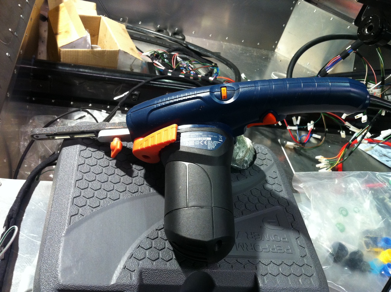

I would recommend a "power file" for final trimming. Got one from ebay for about 30 pounds. Really impressed so far with the ease of fitting. Sorry but think this may turn out to be a softy build at the panelling stage.

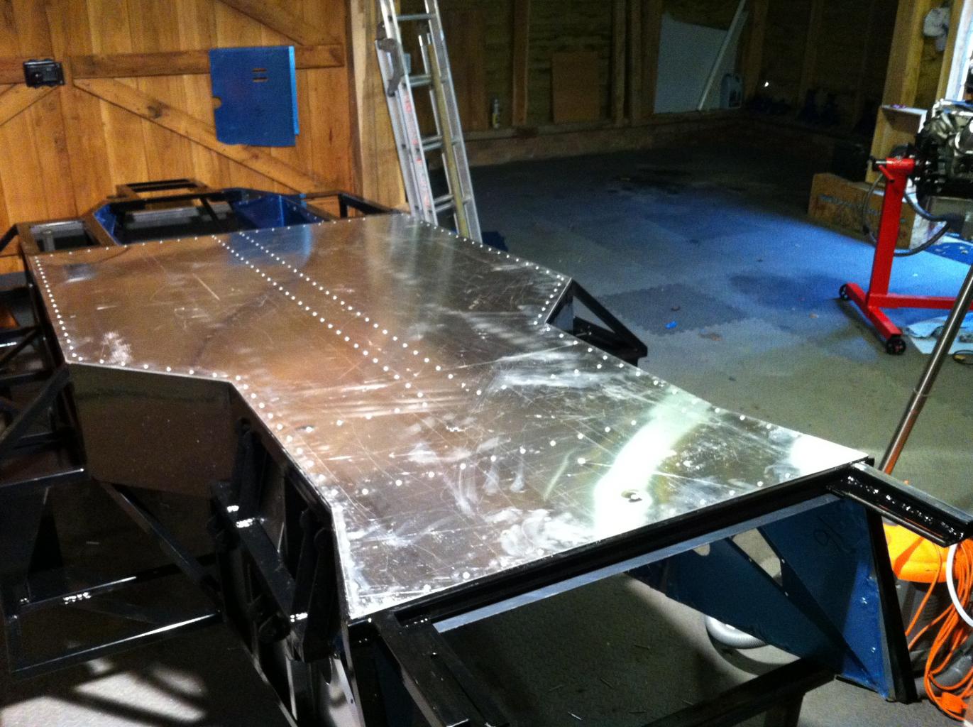

Foor Panel

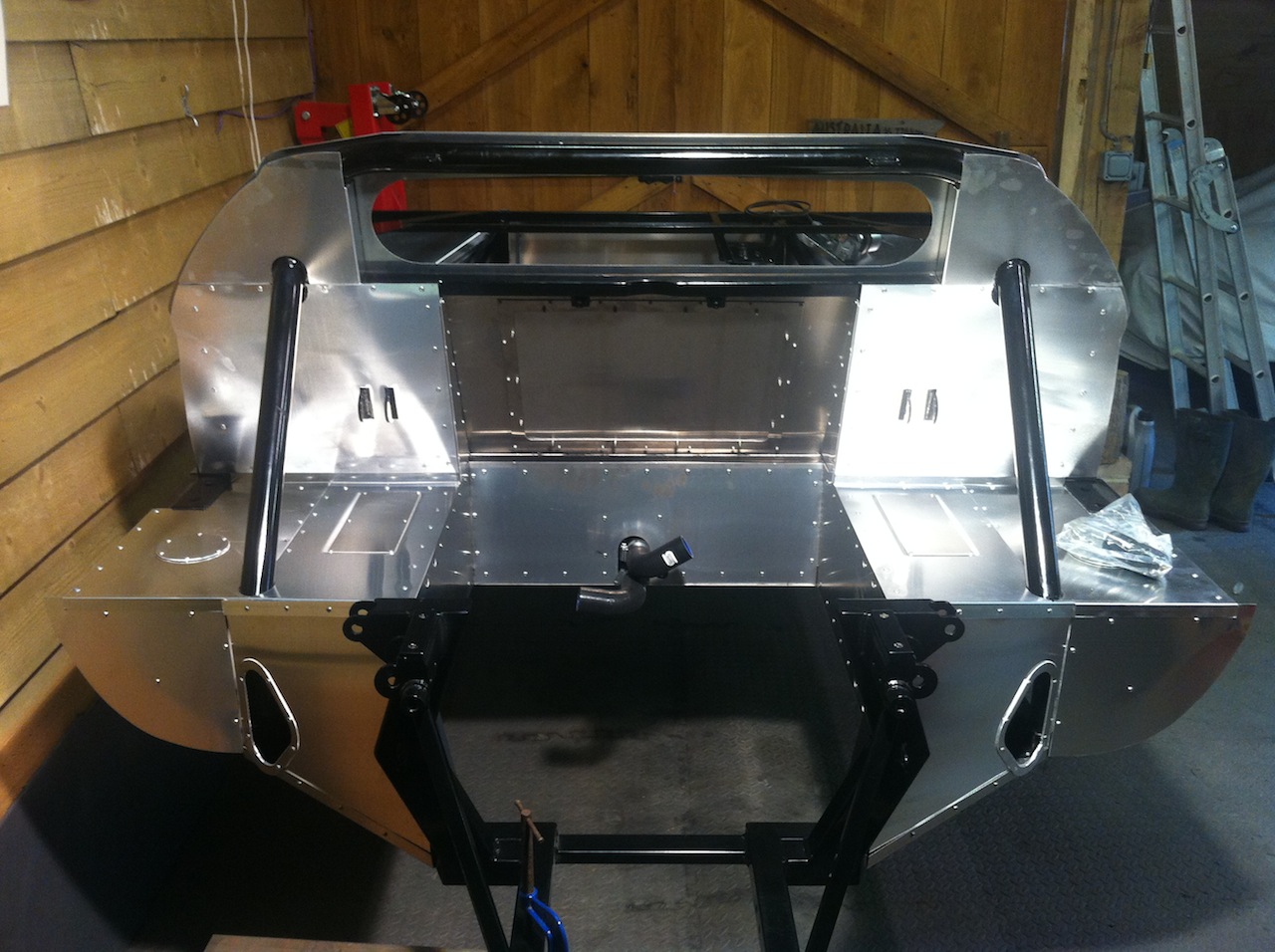

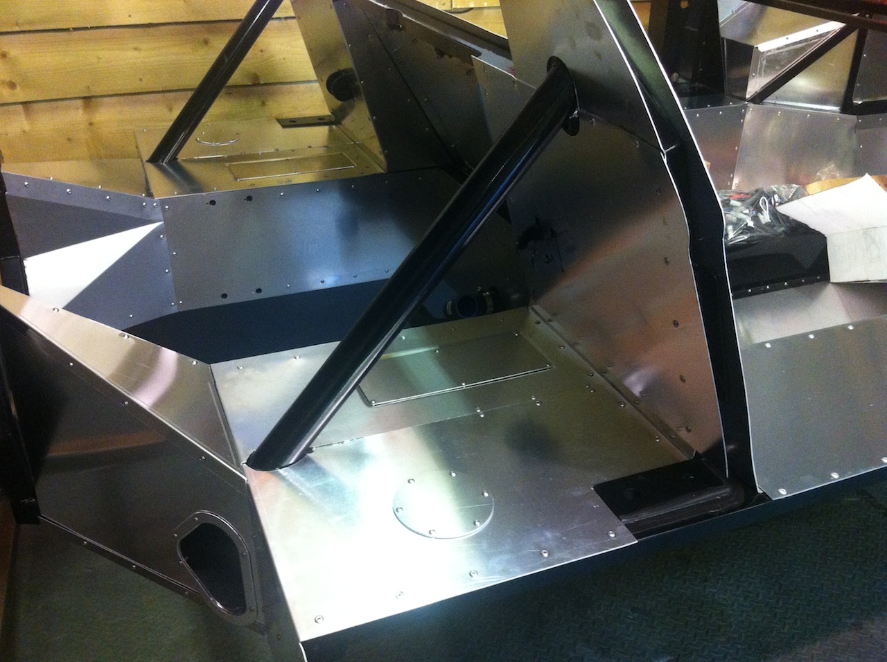

Fairly straight forward, but nearly made a mistake. The floor panel looks symmetrical, be aware, it's not (of course)! The front / rear water ducked etc is slightly off set! Nearly made this mistake of starting to drill. But picked it up just in time.

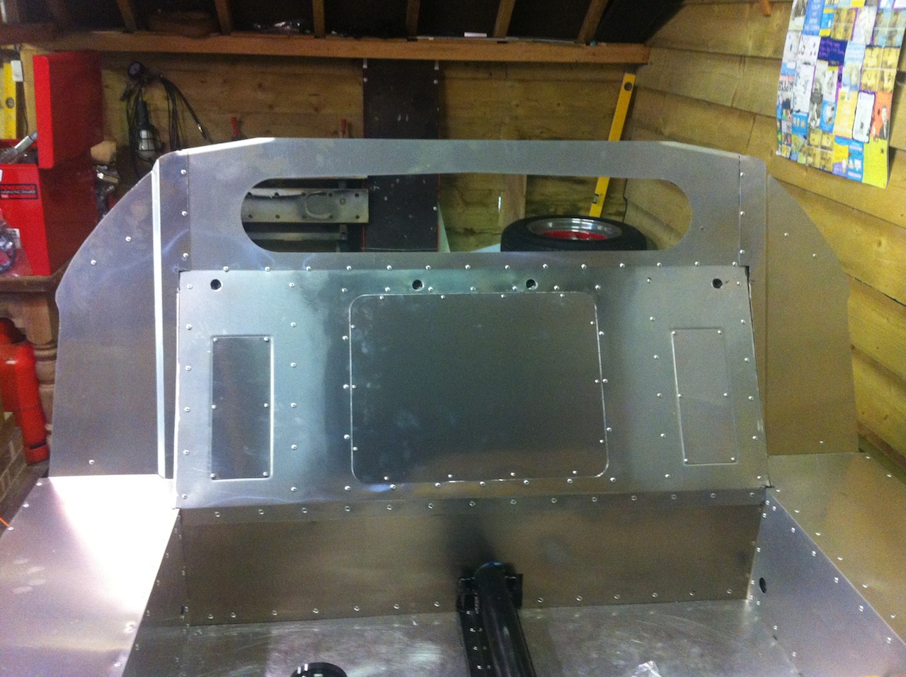

Body Paneling now Complete
Some interesting points to remember. As Paul found out the rear box sections need to be rivet nut fixed. Easy to do and as usual all panels fitted really well.
I made a mistake on the main engine bay cover - surround. The ring that fits on the rear bulkhead is fitted engine bay side. So that when the engine panel is fitted it is flush with the main bulk head in side the cockpit area.
Summary of panelling is that all fits really nicely but I am sure I will need to open out some holes etc. The guys at Southern GT have been great and easy to communicate with.

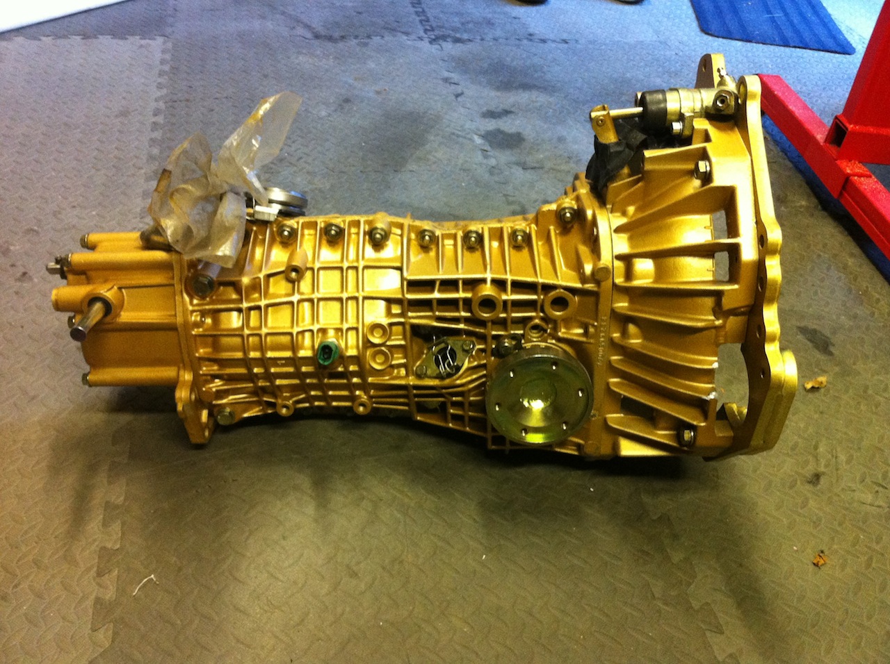

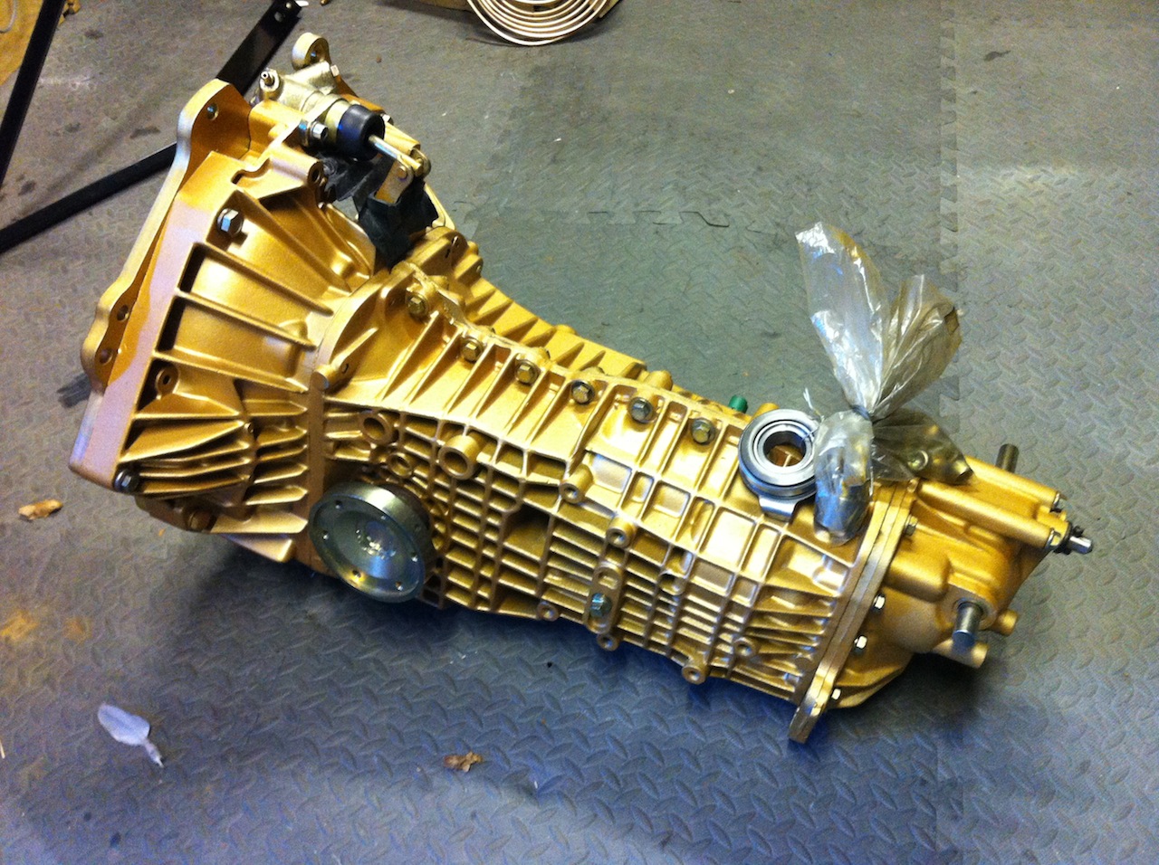

Chris Cole back to great form. Picked up my gearbox. Chris has put Quaife internals and a taller 5th gear. We have had the casing lacquered in gold and all the bright work Cadmium plated.

Now that I have the picture button sorted I can include some chassis pictures. Has been a bit miss and hit on the attaching of photos but now got it - size matters!
Hopefully these will show the completed chassis. Now going onto suspension, and wet systems then to wiring.
Nick, what do you mean with "power file". What is power file for? Would you upload a picture of "power file". Thank you.

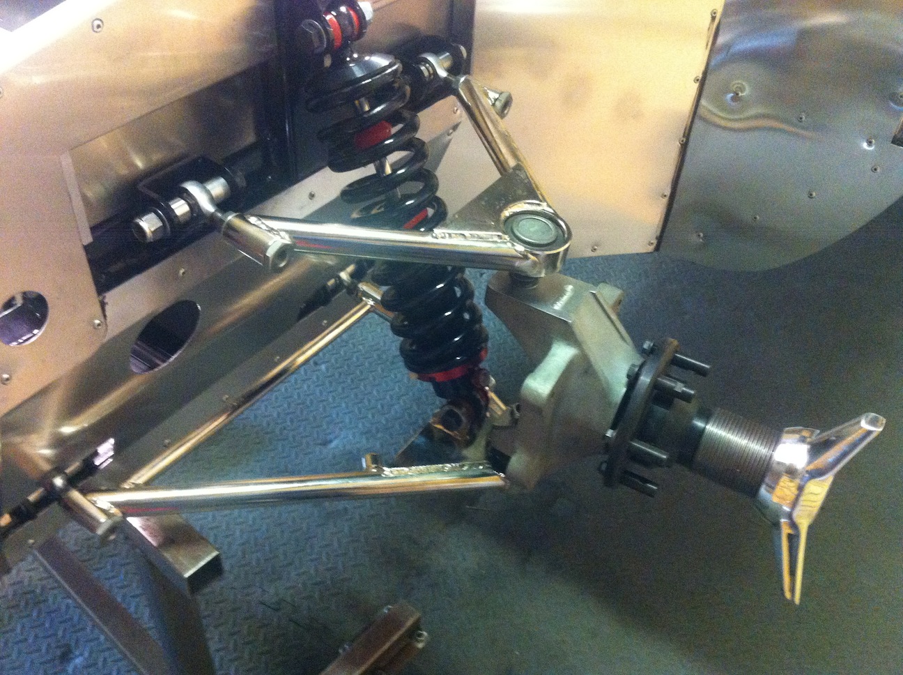

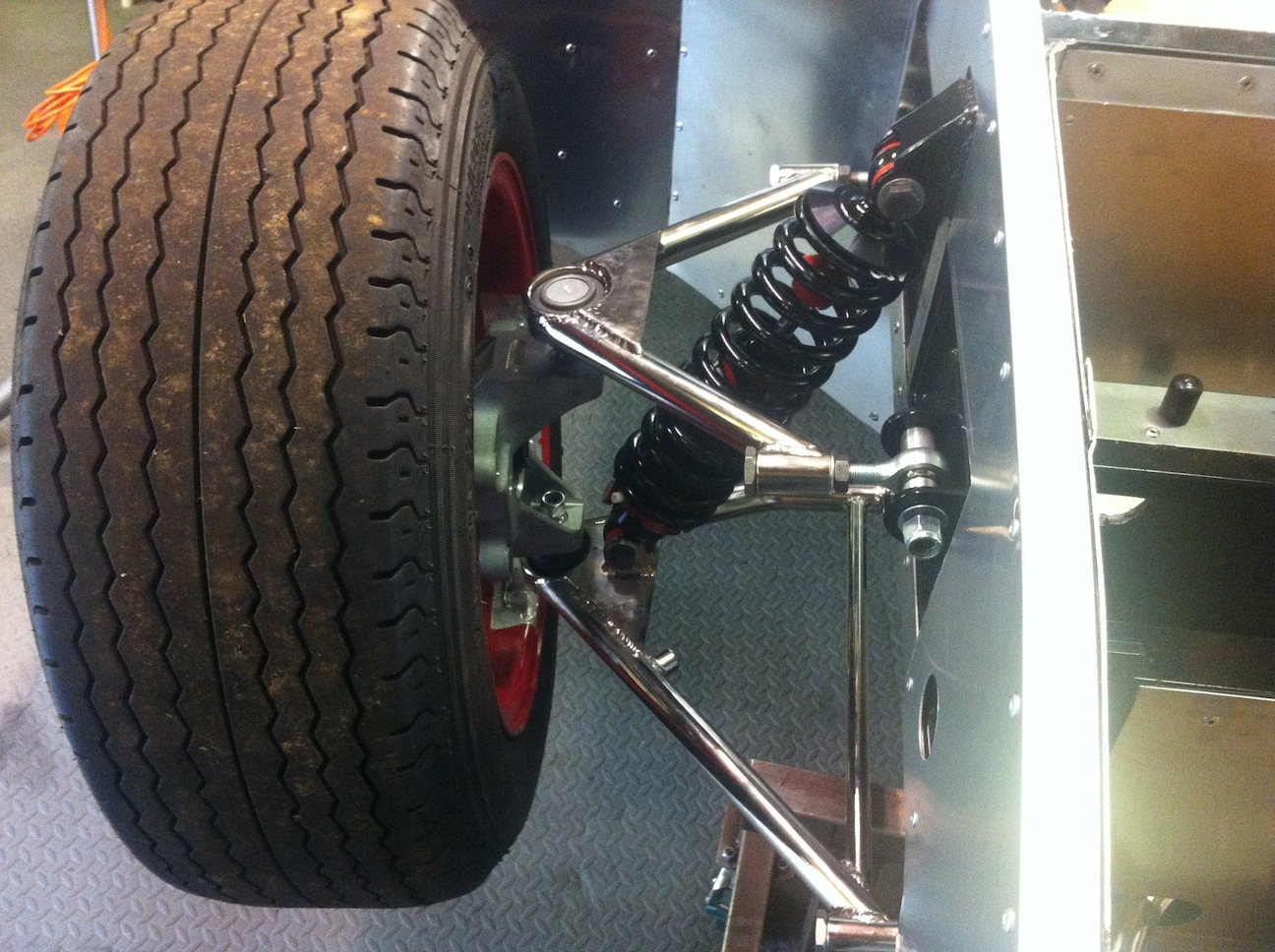

Front Suspension

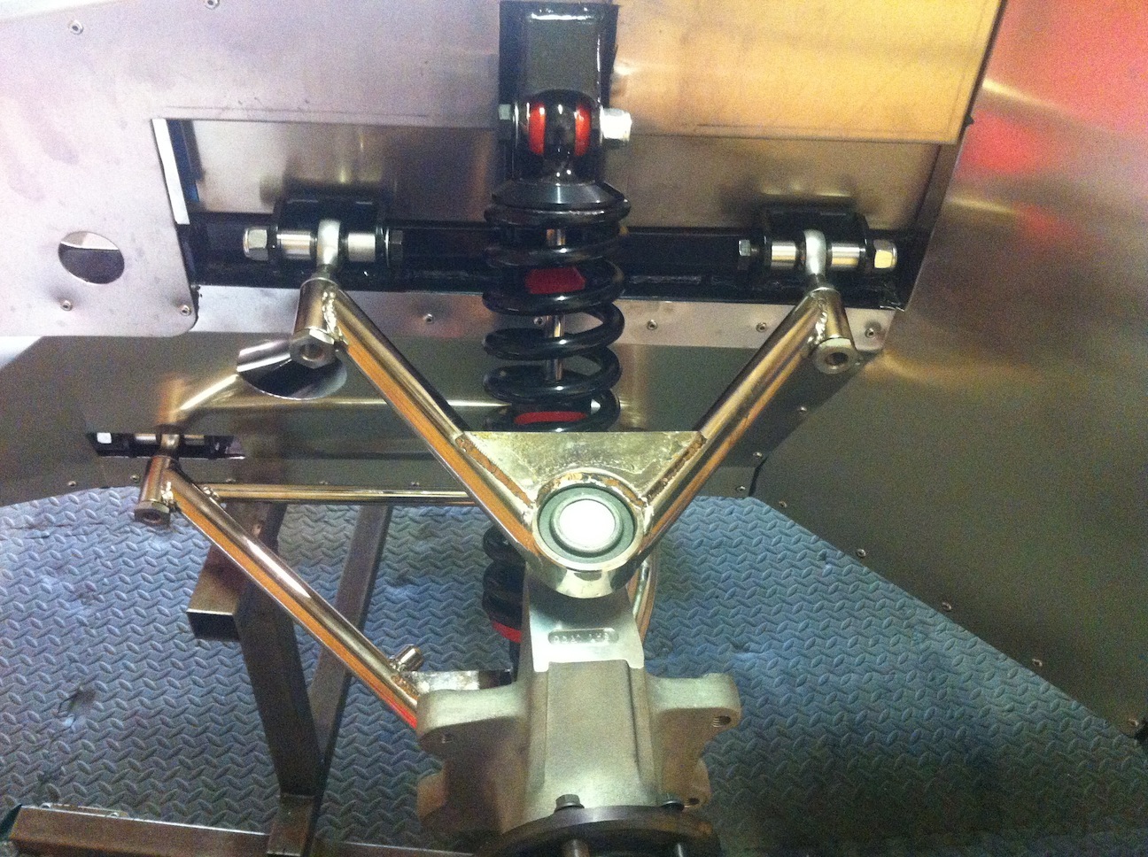

All quite straight forward and went together without problems. One tip would be clean out powder coating from holes before panelling. As some of the bolts have restricted access this turn out to be very tedious.

Hi Nick, greetings from the sunny New Forest. Yeah, ok. Is it me, the camera or the design in that the forward strut of the lower wishbone seems longer than the norm? And from that, it appears to be of quite 'slender' proportions for it's length?
Suspension is not my bag but I like to try and understand everything, so please forgive what might be a pretty stupid question - it's my eyes you see - it's a curse :laugh:
