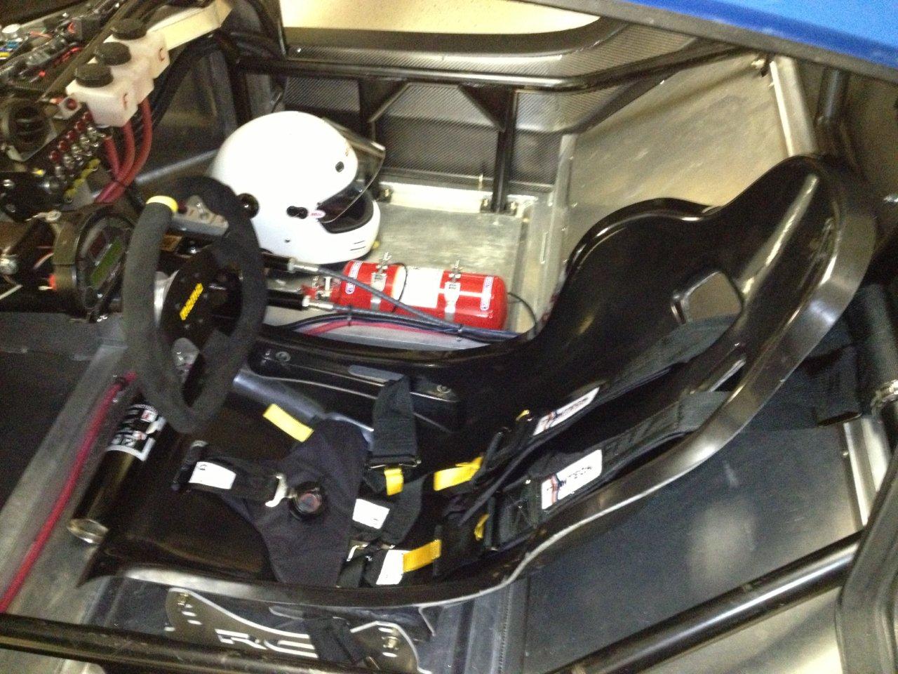

1) New seat - using Fran's new fiberglass shell.
2) New TeamTech 6-point harness

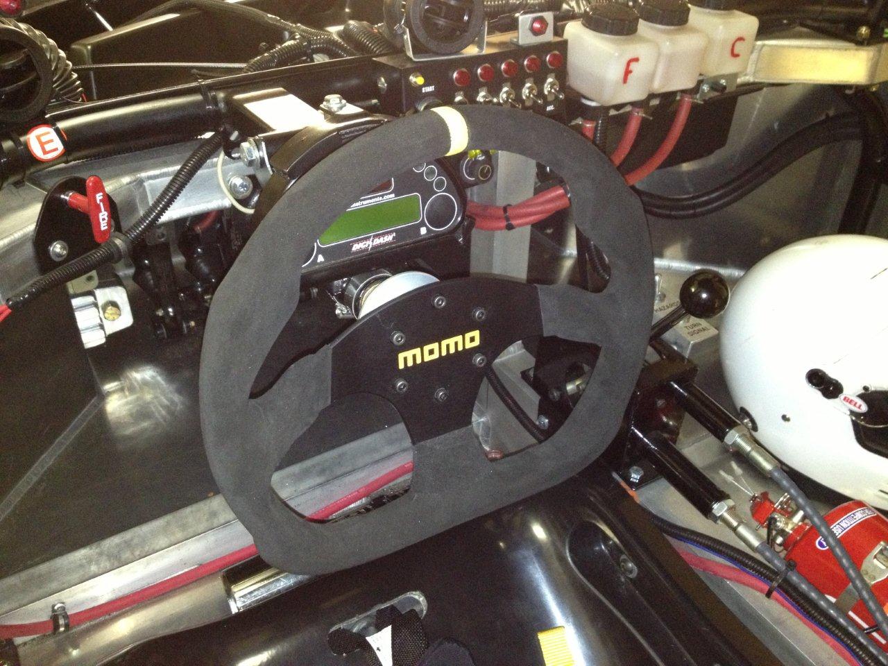

3) New Momo Mod 30 320 mm wheel

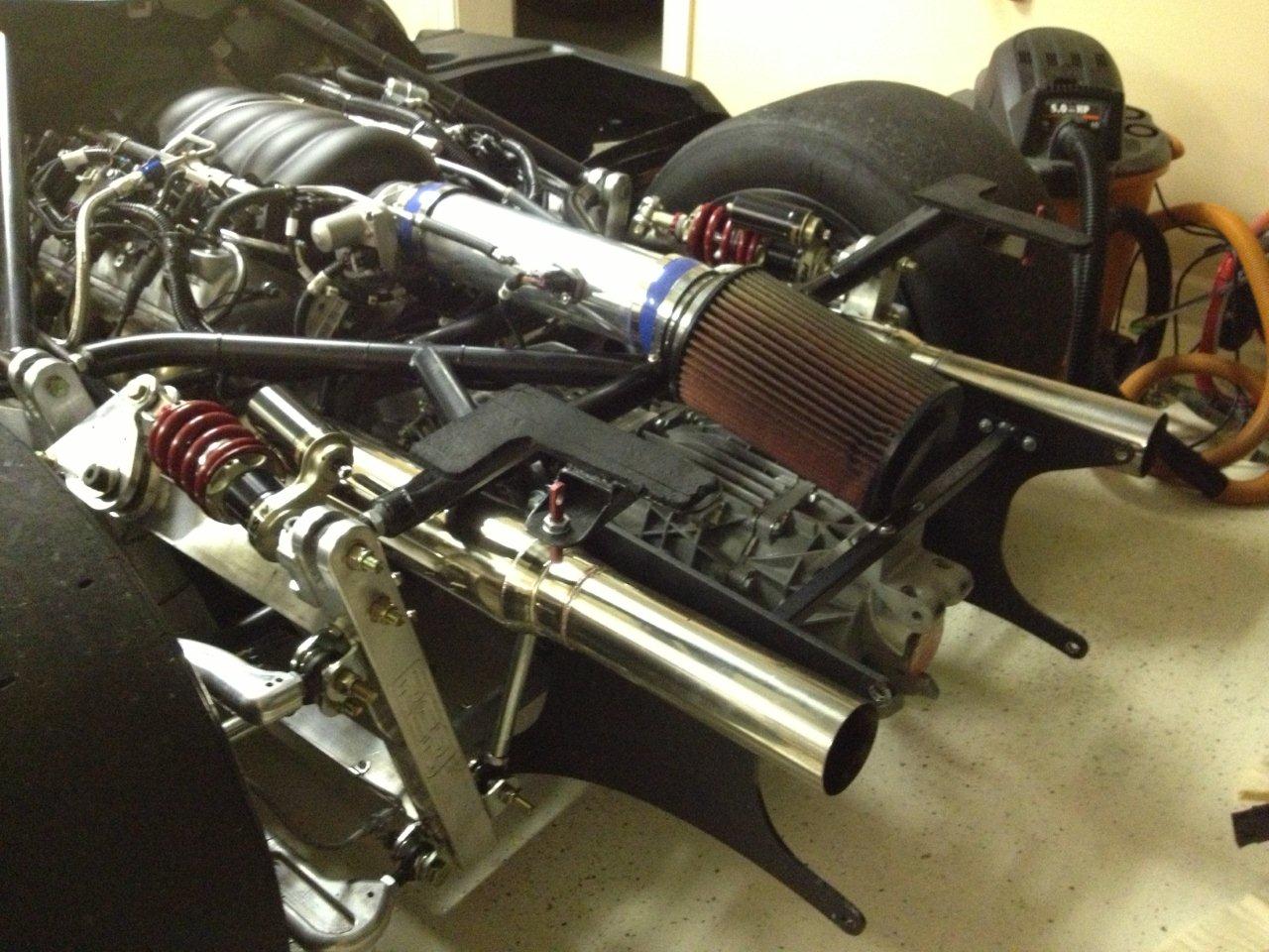

5) Rear exhaust system

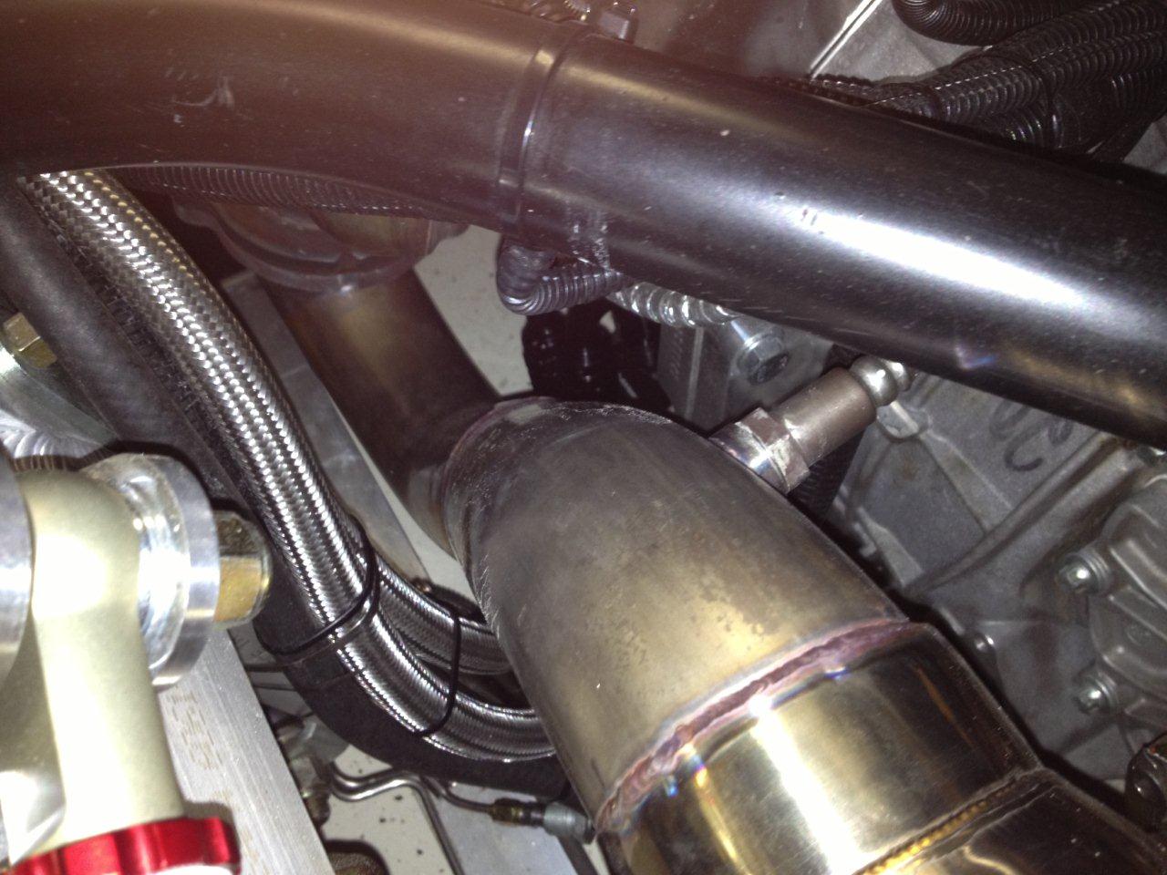

One thing I might be concerned about is how close the exhaust system is to those braided hoses., unless it's an optical illusion, I would want at least 3" air gap in there and would advise that you wrap both the exhaust and the lines with header wrap..
Give them heck out there and post the video!!!
You sure have it looking good!
I would agree with Randy on the wraping of the exhaust and the lines. It gets smoking hot under there.

Good call on the hoses close to the exhaust. I'll work on some heat wrap.

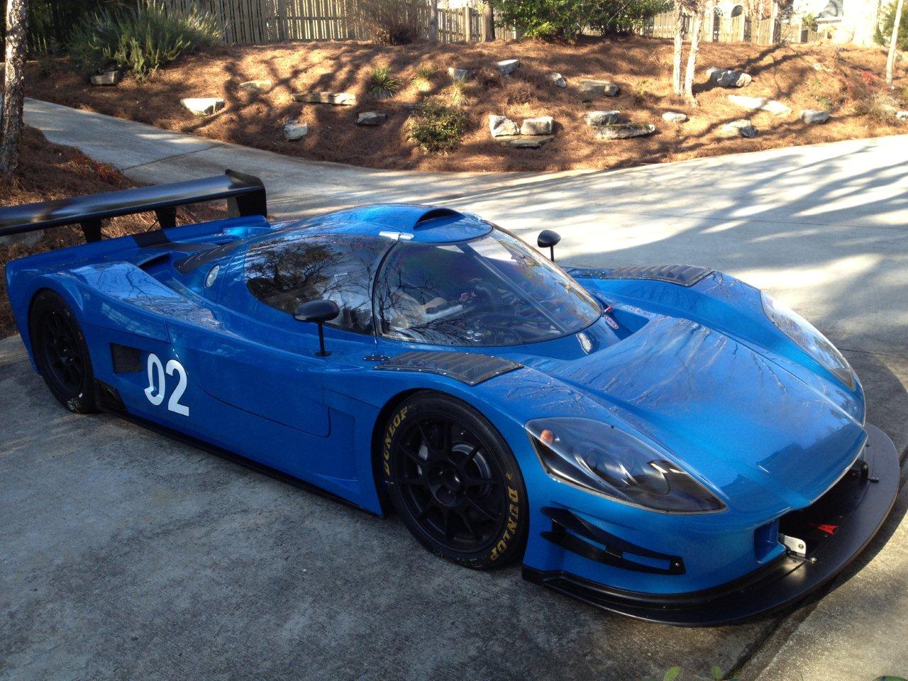

I think the canards may be installed incorrectly- the leading edge should be the wide one...
Thanks Will.
The canards only install one way. They have a vertical tab that fits up against the fender lip that would stick out in the air if turned around.

Mark: My goal for the exhaust swap was to make the car a little quieter. The side exhaust had a very harsh tone and I don't like having to wear ear plugs when driving it.
Jack: The canards only go on one way due to angles of the mounting points.
