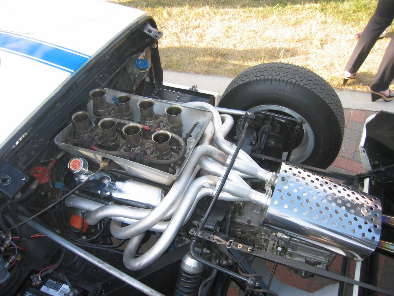

I was going through Ronnie's first book and found an interesting photo, with something I had not noticed before.
On page 78 there is a photo of P/1046 (the McLaren, Amon car), labled "The engine bay of the winning car".
The photo shows the rear sway bar to be mounted unlike any other I remember. The photo it kind of dark, but it looks like a custom bracket moving the sway bar up and to the rear and it sure looks like the sway bar goes between the upper and lower header collecters.
Has anyone seen this layout before?

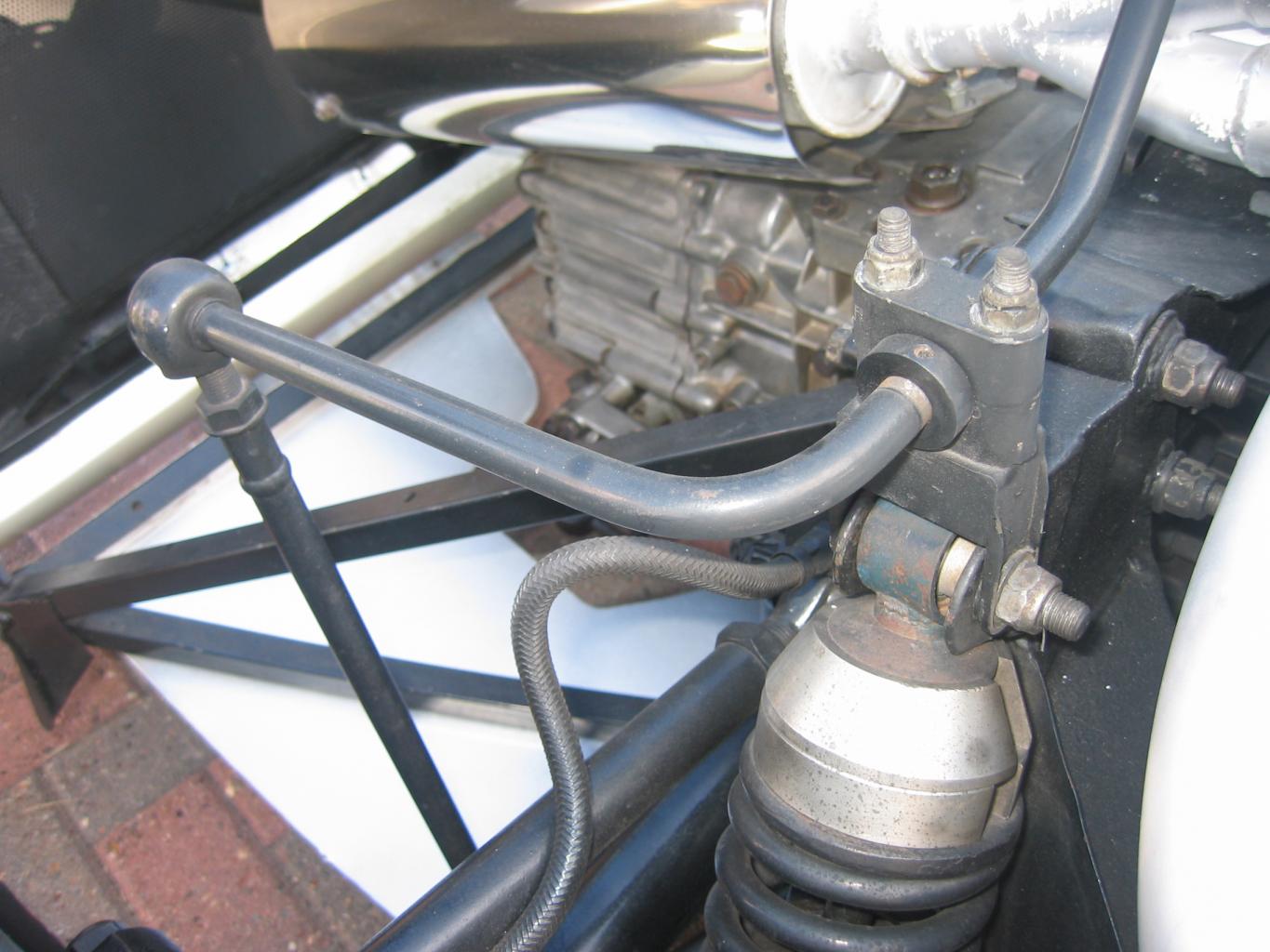

Well while looking for the photo of P/1046, I found this photo of another team car, in this much clearer photo the sway bar is silver and it can be seen going below the headers, My bad!
Any Idea what this is?

Is it my poor eyesight or do the headers on 1046 look larger than normal? Maybe thats why it is under them.
Here is a picture of one of the orginal cars, Mike Drew took these photo's at Road America years back.
The van video is a hoot. :)

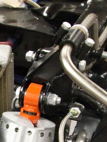

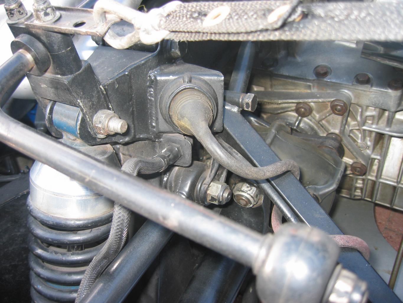

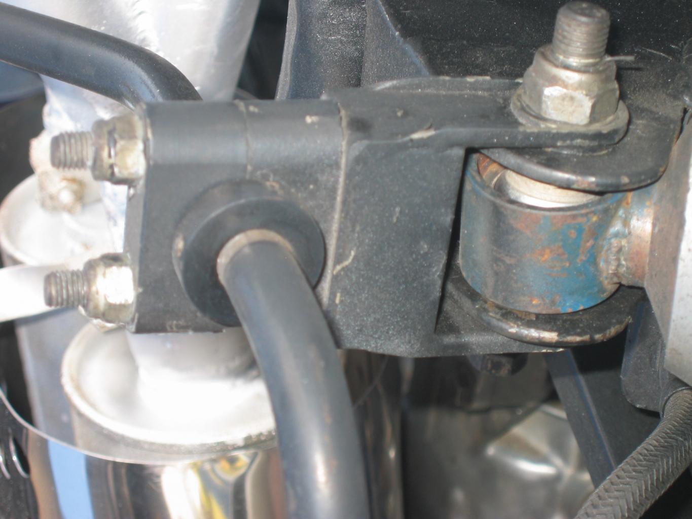

The MK II setup is different form the MK I bars. I have some MK II pictures somewhere that I will look for and post.
Exactly. Remember, 1046 is a Mk II, which had a 427 instead of a 289. The engine is physically bigger and taller, and the added displacement demands increased exhaust pipe size. That combination of needs crowded out room for the swaybar, so they had to route it underneath instead of above as on the 289/302-powered cars.
