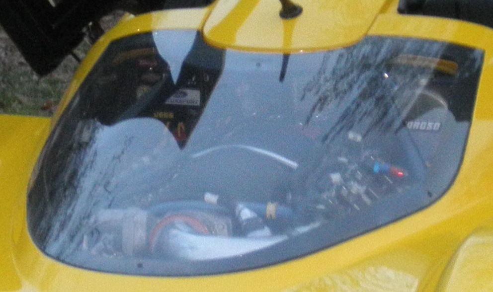

The problem with giving the clearance # is the slope and curves of the rear glass change the # depending on where you are measuring. I went through this with my intake, air box, and filter selection.
Alex probably has the best records with all of the intakes he tried on his car during his build. Hopefully he will see this thread and chime in.
With the race tail you start out with alot of room around 1ft. That slopes down to around 2" at the flipped TB. Then you have to allow for a 4" intake. Tight, 0" at the turn. I think the street tail adds a few inches?

Thanks very much, guys. Cam, thanks for the numbers -- that's what I was afraid of, that slope just kills the clearance.

There is a bit more room in the street tail. A couple of inches at the rear.

I did order the street tail so that's good news. I'm hoping to shoehorn in a holley Hi-Ram. Unfortunately, with the standard plenum, it's 12" tall off the valley right at the area of the least clearance in the SLC. I'm thinking about fabricating a different plenum since they just bolt to the base runners -- possibly a side-mount throttle body.
I definitely don't want to touch the bodywork or window, but I'm comfortable with metal fabrication.
I'm going over to Fran's shop next week so hoping to get some additional measurements to see if I'm even living in some realm of reality :) Absolutely nothing wrong with a stock GM manifold, but I love the looks of the hi-ram and it loves high rpms.
Ken Roberts
There is absolutely no way a Holley Hi-Ram will fit (under the stock unmodified window). Even with a modified upper plenum.
The LS3 throttle body mounted to a LS3 manifold fits comfortably with not much extra room. The slope back of the window at its lowest point (at the throttle body location) is the problem.

Fran Hall RCR
GT40s Sponsor
