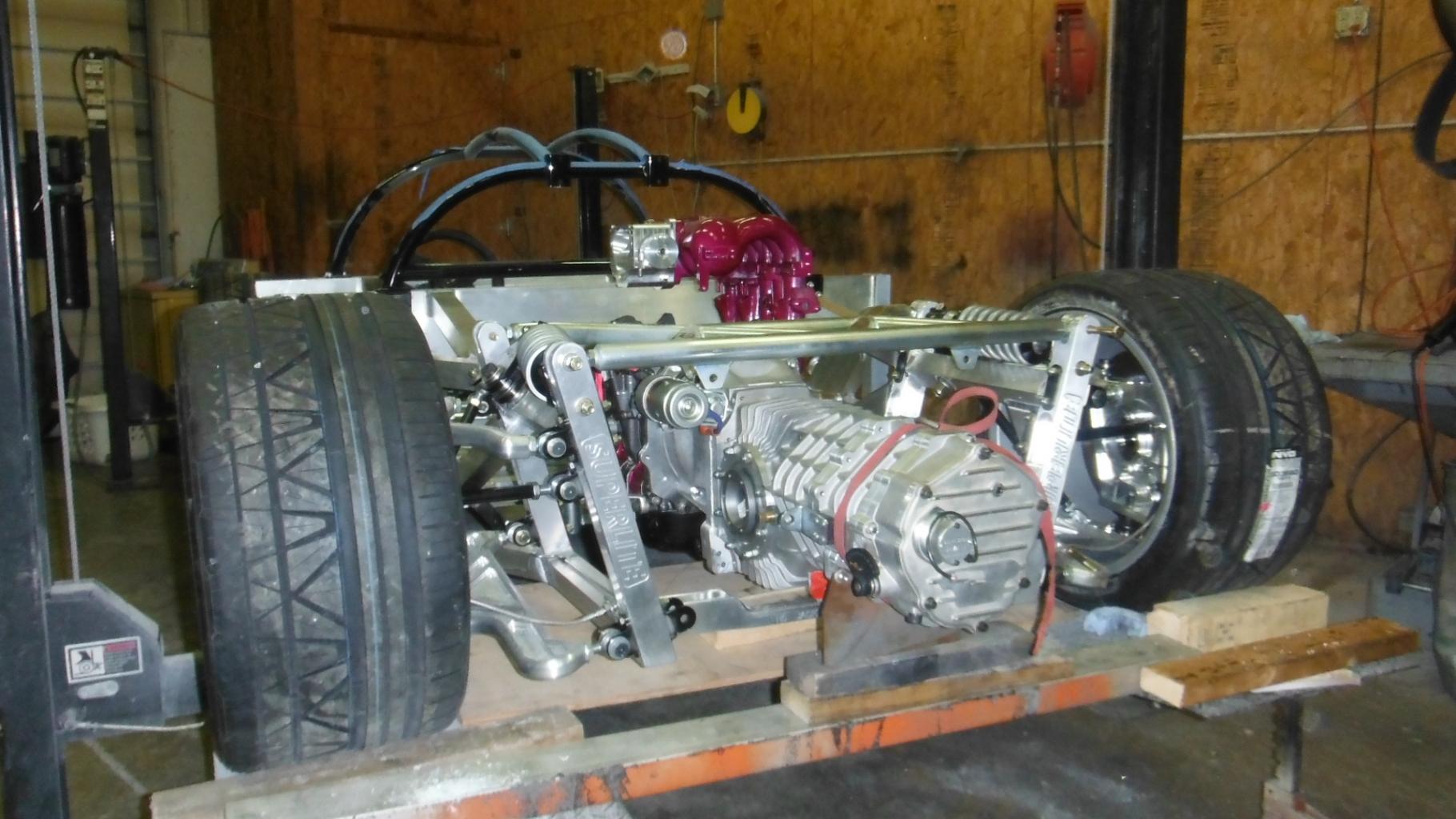

Here is my Mendeola in the car with the motor. You can pick your ratio's and this is a production product.
Errr... Unless I'm reading something wrong on Mendeola's website, you can "pick your ratios" providing you don't want anything taller than a 4.13 ring & pinion and a .89 top gear. This equals 3500 RPM on the highway and 140 MPH at 6500 RPM in top gear for a typical V8.
Great for a quarter mile drag car maybe, but geared a bit short for those of us with V8 cars we want to drive on the street...

They have any gear ratio you want for the one that I bought, they make everything there, so I picked what I wanted, at 160 I am at 8000 rpms, 3 rotor Mazda and thats a .8 5th gear.
I watched several videos of the other transaxles, and dont really care if 1st gear is good for 90 mph, I like acceleration and cornering, but that's my preference, you get caught going 100, your in jail for the nite around here.

John Ross,
At current there are available 4.11,3.88,3.55 ring & pinions.
top gears are .88, .82,.73, .68,.63,.60
I believe you may be looking at the Off-road gear sets.
The units for the FFR GTM's are being made and sold.
They work better then ok.
