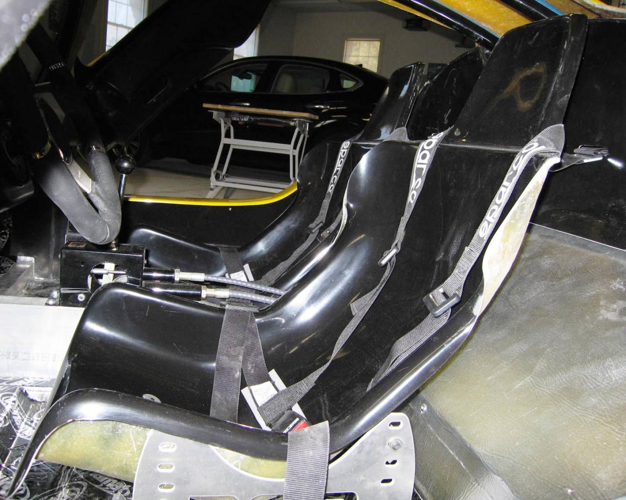

FYI, I mounted my shifter flat on the center structure (vs inclined).
Since the shifter base is wider than the center structure, your next decision is whether to mount it:
  • Offset to the driver's side - This means that the driver's seat needs to be positioned a bit to the left. If you have a gentleman's seat, that nudge will put the seat out of the center with the steering wheel.
  • Offset to the passenger side - This nudges the passenger seat to the right. If you have a gentleman's seat, this will push the far right ear into the door panel, so the seat will need to be trimmed.
  • Centered - Hmmm, Just can't decide...ayy:bigcry:
I mounted my shifter offset to the passenger side, because when I'm driving my SLC, its all about me rockonsmile
