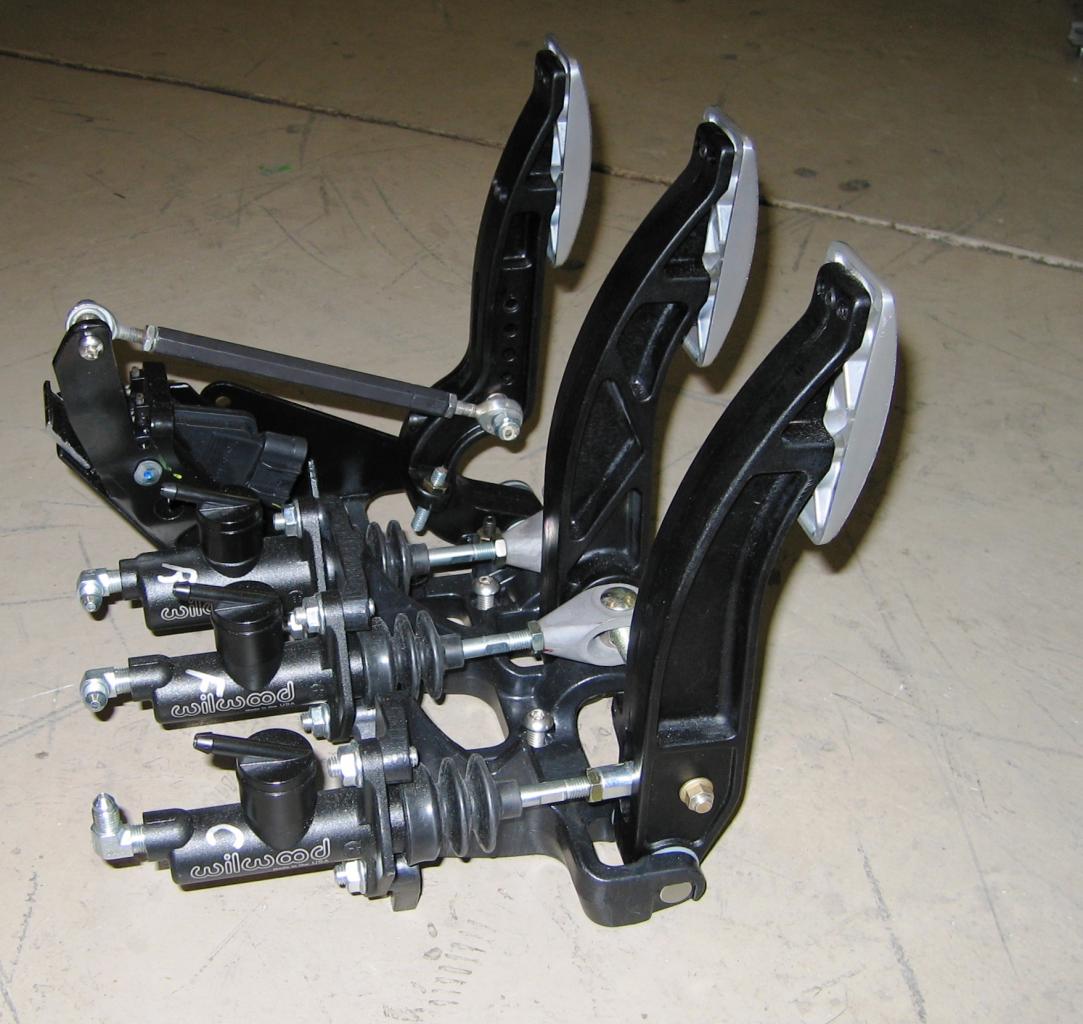

After sitting in several SLC's at the Charlotte event....I've changed my pedal to TAC set-up. I fabricated a bracket that is connected to the TAC arm - it's about 6" in height and bolted to the TAC arm at about a 90 degree angle. I'm using the 3rd hole from the bottom on the pedal as the arm connection point. I now have about 3-3.25" of pedal throw - it's all gravy now.
Figure to add a couple pictures - the arm doesn't have to be too fancy.
BTW: I didn't want to disconnect all the fluid lines so I worked this within the pedal box area. What a PITA - I'd highly recommend one does this on a work bench prior to installation in the foot-well. I need to see a chiropractor now.

I'm impressed you did that with it in the car - I just spent the last week (I work slowly :laugh: ) setting up the geometry of my gas pedal on my workbench and it's always a major pitta to get it setup just right even with it staring you right in the face on a bench, heh.
Btw, I don't see any jam nuts on your master cylinders where they thread into the celvises?
