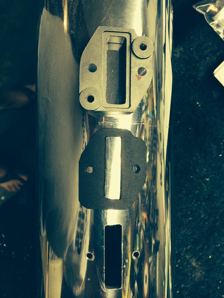

I used flat head cap screws to attach my mass air flow mounting bracket to the intake tube.
