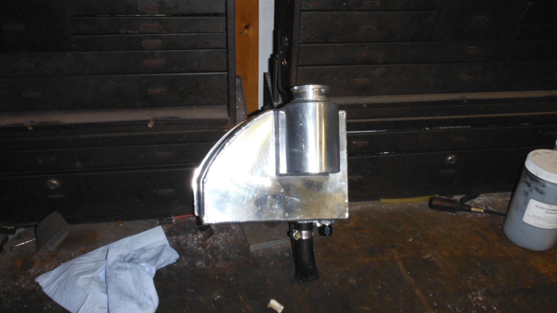

I have one that I can sell, it dont fit because of my boost hose, but it matches the curve of the roll cage.
