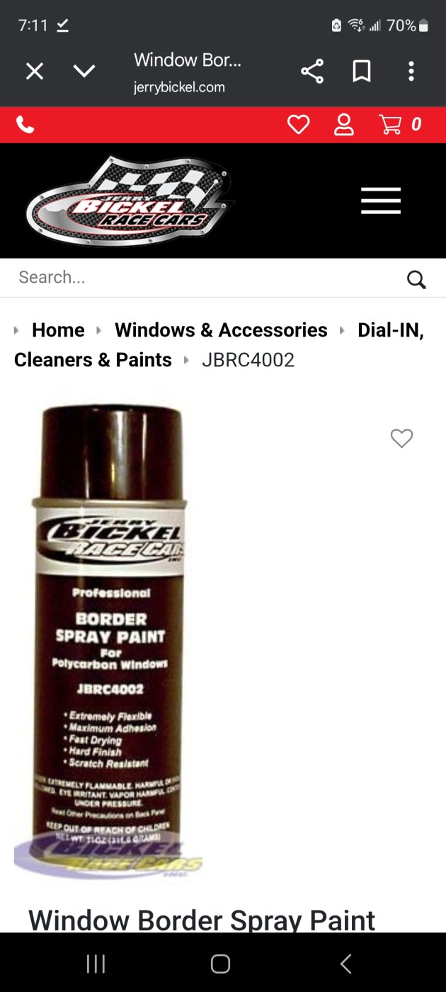

I have just been through this in replacing the windows on my KVA. Bleed through of the paint under the masking tape has been an issue, but I have managed to clean it up afterwards. It's tough to find a really good masking tape that will make any sort of curvature.
I'm not sure how you would fair with a dye, although I have heard of tinting plexiglass windows with dyes.
I used a border trim paint from Jerry Bickel and the paint itself is working well, although is does require scuffing the plexiglass surface for preparation.
Window Border Spray Paint
Julian

i used border paint and its still fine on headlight covers. i used a 3/4" border on the driver/passenger window that people are beginning to scrape off.
