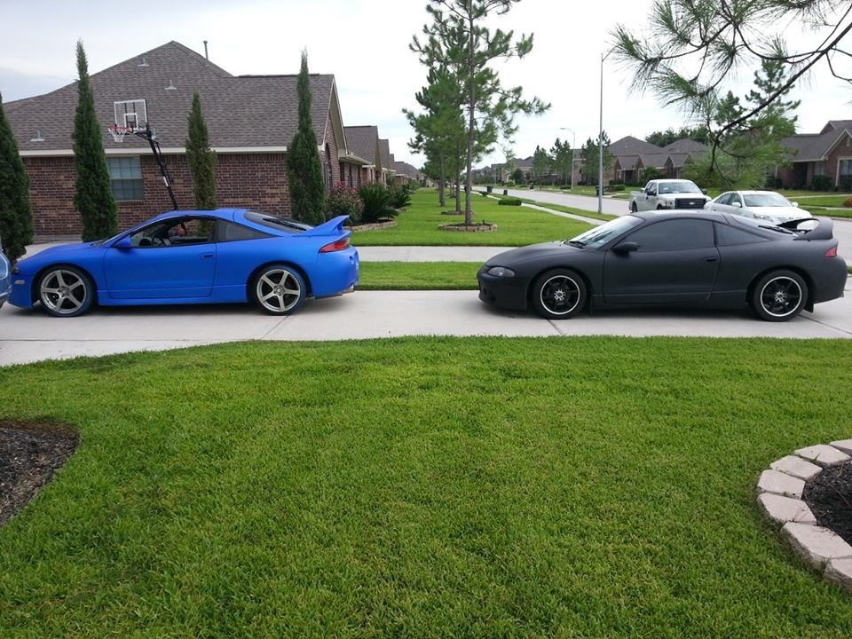

I love plastidip. Here is a pic of my friends car and my old car that I recently parted out. (Money in my SLC fund now) Both fully built AWD Turbos. 500HP plus. He plans to build the Apex.
Peeling the dip off is very easy and doesn't damage paint. It did however cause things like the front bumper and side skirts to look faded after the dip came off. I wonder if plastidip would damage the gelcoat.....

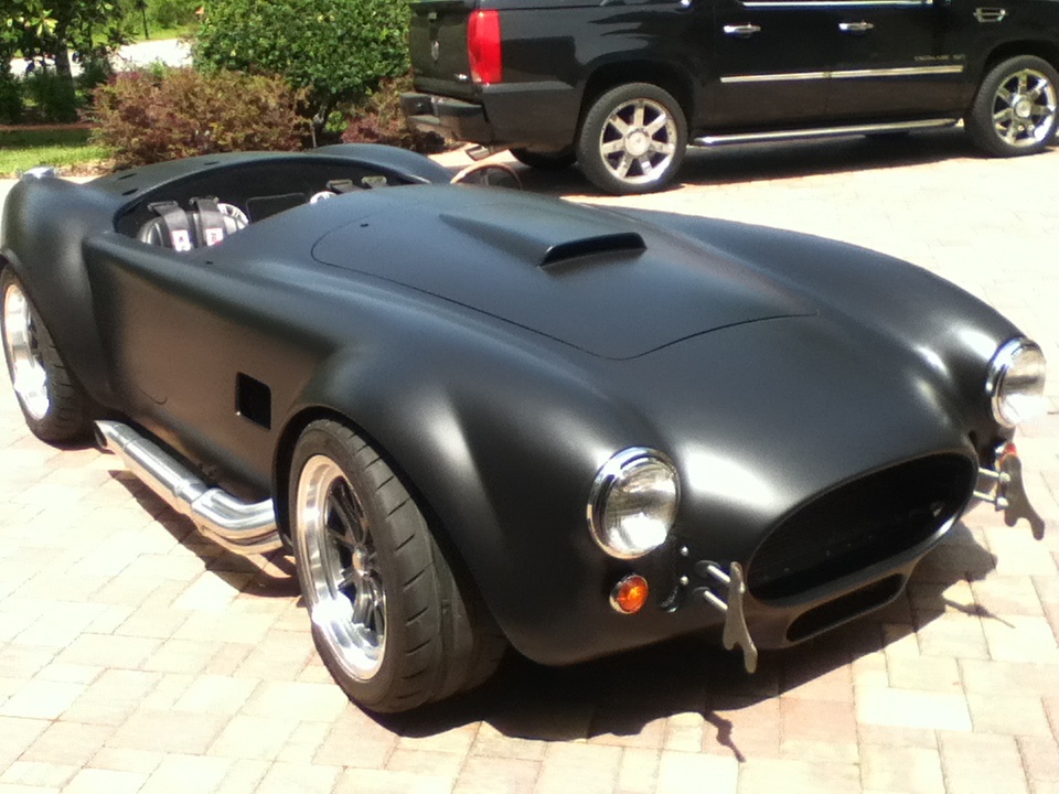

Could only figure out how to upload 1 photo - hope this gives a good feel for what the cobra looks like. I bought the professional kit from dipyourcar.com with 3 gallons of matte black and 1 gal of their glossifier. We did spend time with the various YouTube videos and I'd be happy to share more photos and our notes if you're interested.

Looks good!
