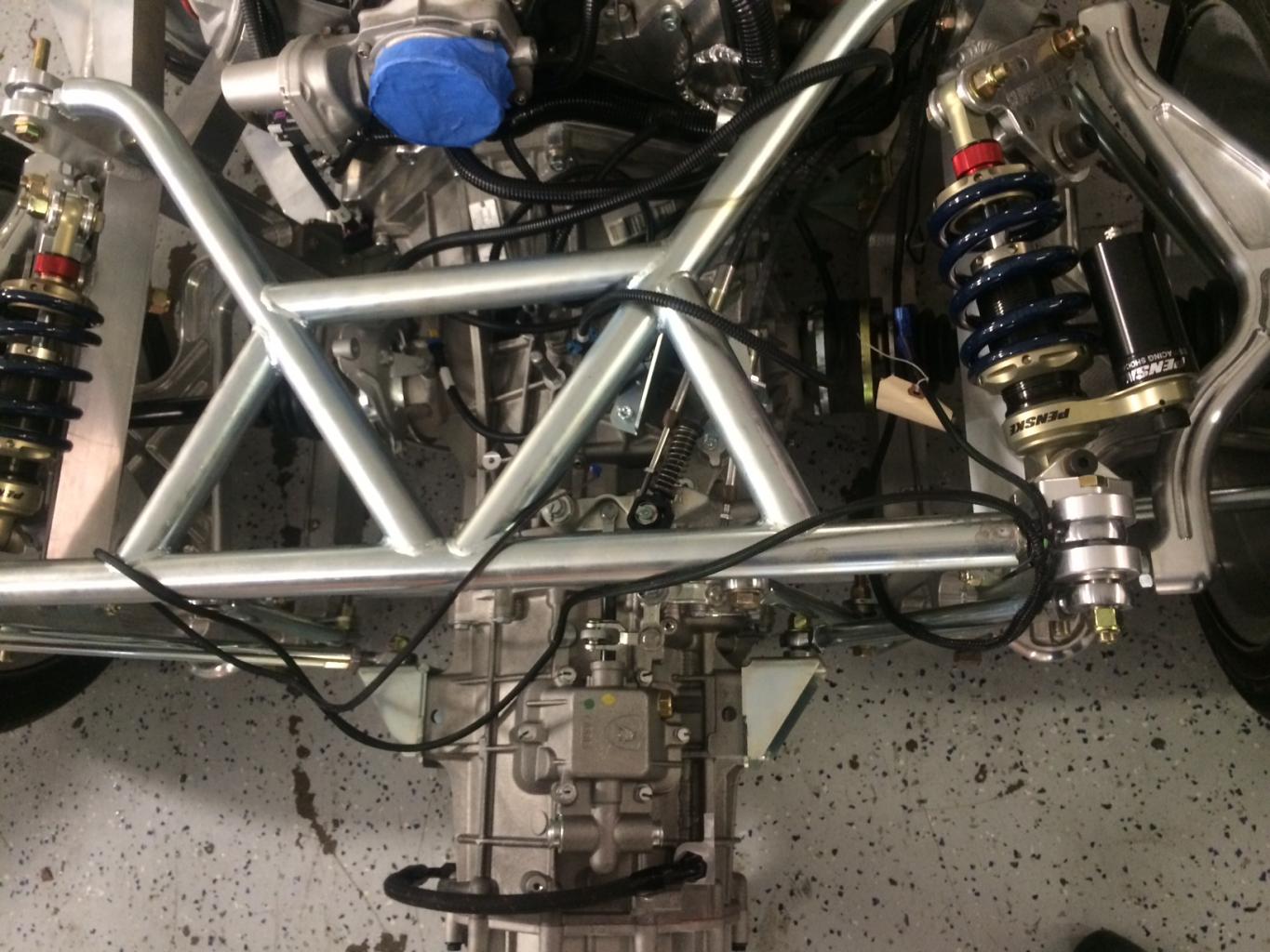

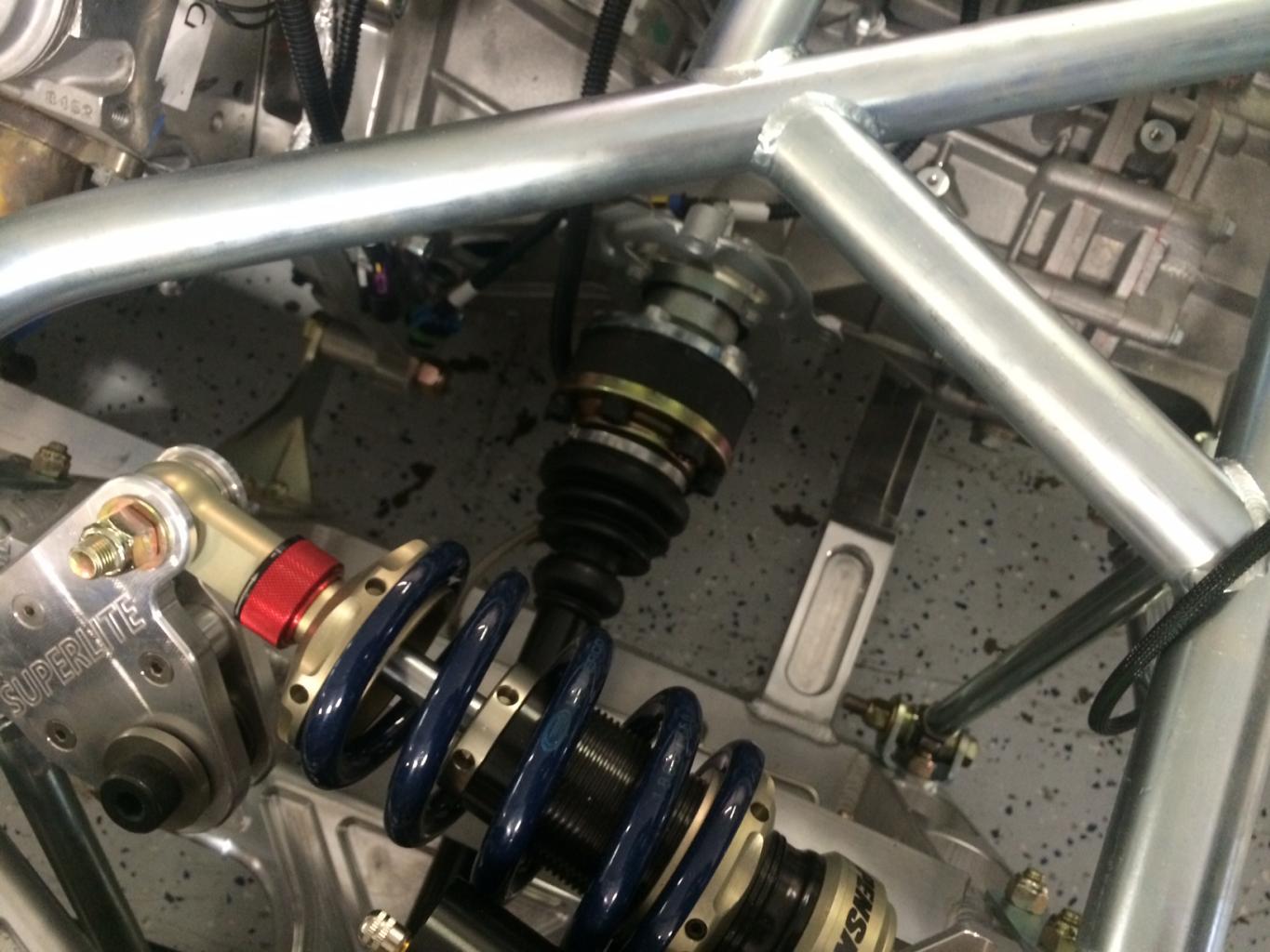

I took some pictures of the axles installed here in the shop and also went and measured both the transaxle and the CV joints that we have in stock and they are a match...as I expected actually.
Remember that the dust cap on the transaxle end of the driveshaft gets removed and discarded....
There is no issue that we are aware of and we have bolted up many sets now with no problem

The axles for my LS3 and Graziano fit. I checked them last night. The engine and transmission side bolt pattern is the same as Fran has indicated. I was told by Jim that the first set didn't fit though.
