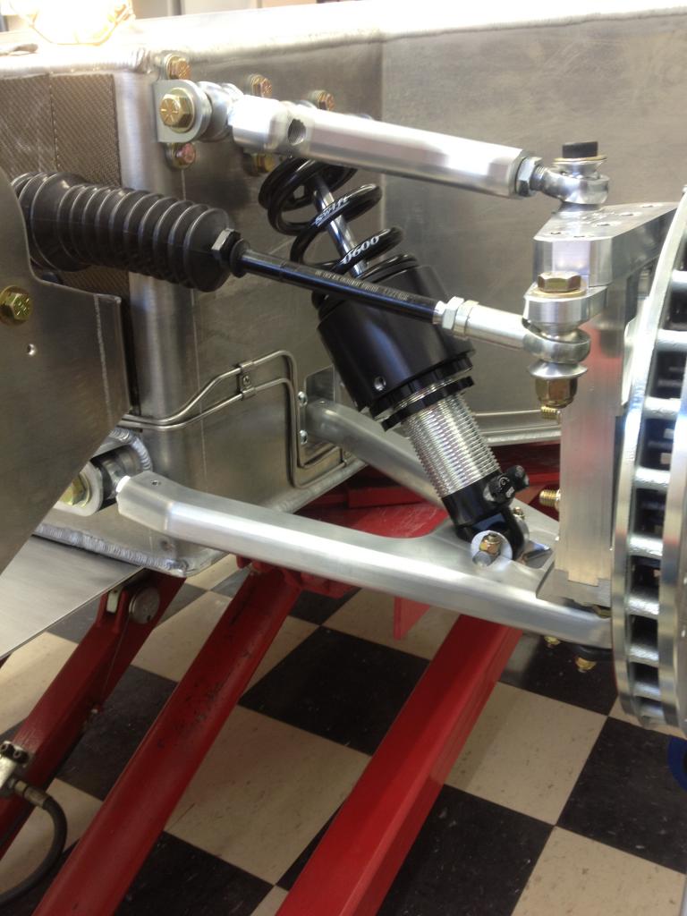

Bob,
I just noticed in the PIC of your front suspension, that the upper A-arm is mounted to the tub at an angle. All other A-arms I've seen are mounted level.
Is that an update to the chassis?
I have seen pictures of the lift sleeve on top of the spring, and pictures of it below the spring. As far as I can tell it will work both ways. Is there a "correct" position ?
Bill, all the chassis have the same angle to the control arms, its part of the anti dive designed into the geometry.
The photograph is exaggerating it for some reason.

EDIT: I think I understand what I'm missing... in Bob's photo the body is NOT installed whereas in Bill's photo (that I refer to below and when I look at my own Upper A-arm) the body is installed and thus it gives an a different perspective.

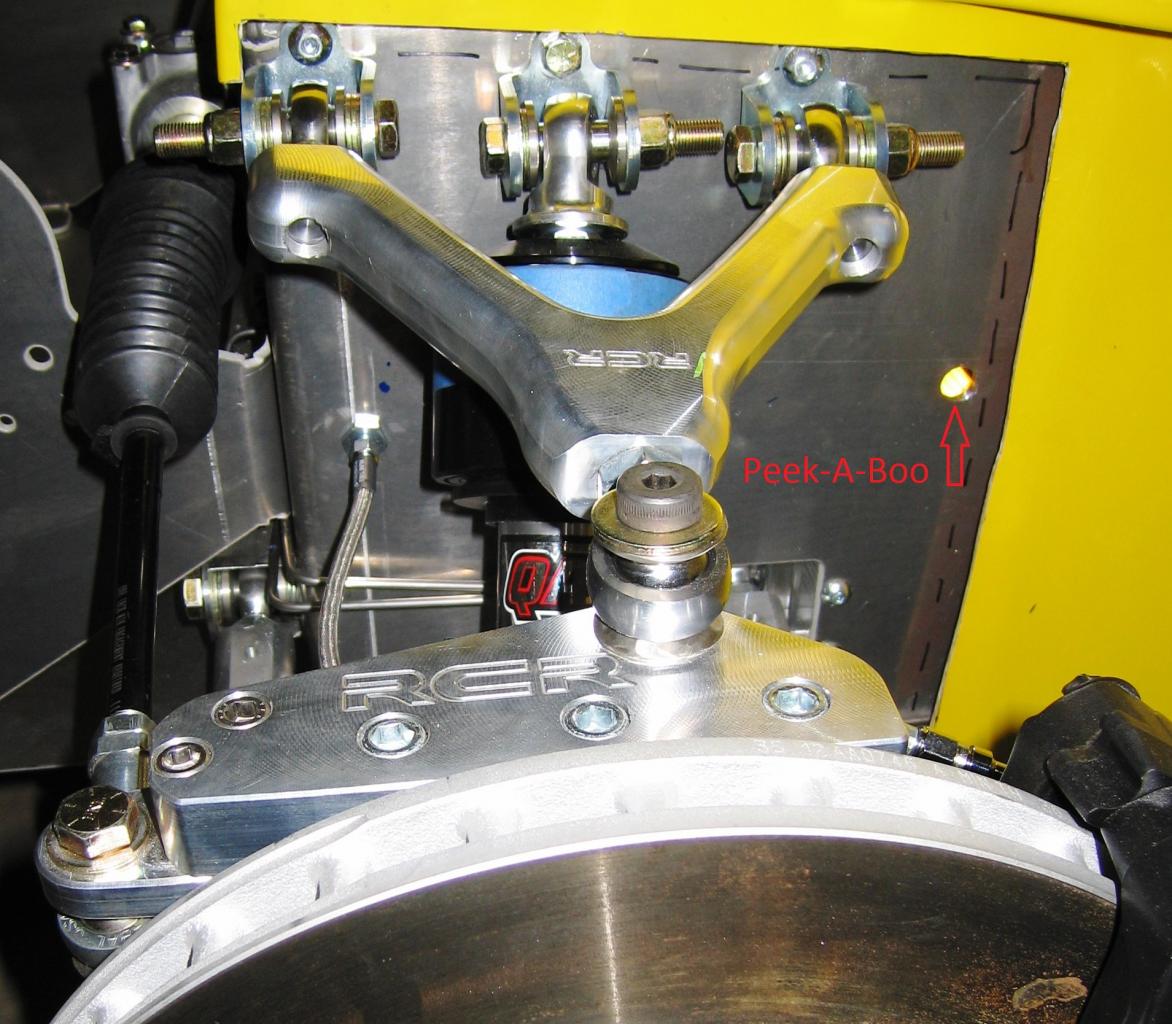

Fran,
Bob's picture in post #5 shows the upper A- arm attached to the tub by 6 bolts. In Bob's picture the 6 bolt attachments points DON'T APPEAR TO BE on the same horizontal plane, especially when you compare to Bill's photo of the attachments points for his upper A-arm as shown here:
http://www.gt40s.com/forum/attachment.php?attachmentid=63938&d=1362025528
cheers
Stuart
Stu,
they are all in the same plane and the same location...there have been NO changes in the upper suspension mounting holes and their locations in the last 6 years..
Bill, all the chassis have the same angle to the control arms, it's part of the anti-dive designed into the geometry. The photograph is exaggerating it for some reason.
