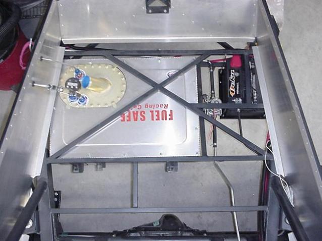

Sorry Hersh....gotta disagree...call me anal, but I notice.
I measure all rivets out and mark with a straight edge. Spacing of 1.5" to 3", depending on location, most all at 2". To me, them being in a straight line is just as important as consistent spacing.
