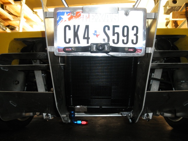

The day I put that B&M cooler on, all my boiling probelms went away. well spent $100. it only boiled on track days though. teaspoons, but its $10 a teaspoon for that oil....
