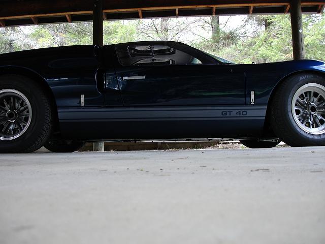

Well, after waiting another month since delivery, I finally got a chance to visit my SPF and spend a little more time with it.
I verified I do not have an electric fuel pump. This is contrary to what I was originally told by Olthoff.
The car sat for a month and would not start. I checked fuses and one was blown. It is a 15amp third from the right. I called Dennis and he said to use one of the two 20 amp fuses as those are for the electric fuel pumps if fitted. He is sending me a fuse diagram. He also said to pump the carb about 6 full pumps. I did and it lit right off. The car had very little fuel in it so I headed to the nearest gas station. Needless to say, it got stares everywhere I went.
I got two sets of gas cap keys - one was stuffed under the right tank cap. A different key operates each locking cap.
I was told to fuel one side and open the opposite tank cap to let it vent and they would cross fill. Well, the left tank filled, but the gas didn't seem to be transferring across fast, so I added gas to the right.
The car is very driveable and has a fairly smooth ride - I was pleasantly surprised. I could defintely drive this long distances.
I had to drive through town at 20, 35, and 45mph and that was no problem. Then I hit the rural roads and opened it up...what a wail it makes! I sat behind a pickup doing 55 in a 60 zone and when in third I opened it up (not all the way) to pass I hit 100 so fast I couldn't believe it. The pickup truck was toast.
It handles sure and a bit heavy at slow speeds (less than 100?). The shift action is short and stiff. There was not a rattle on the back country road trip.
In the mail today I also received the carpet set promised by HillBank in lieu of the oil pan I was originally to get. This is very nice and good quality - P/N SP-001-2. See the picture below after installation the cut isn't quite right, but they work well. The set is two sill covers that say GT40 and two footwell covers that show the emblem. I also got my rearview mirror which I have to install tomorrow before driving more.

Oh, a couple fo the shots above are to show ground clearance. I didn't have a tape measure with me, I will measure tomorrow, but I estimate 4". The lowest point is the bellhousing in the one pic, but it is within the wheel area.

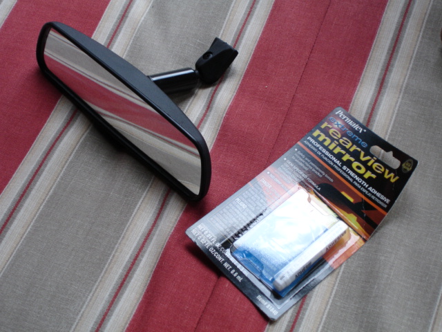

Where did you get the rear view mirror?
Gorgeous car BTW!

I got the mirror from Superformance...it was supposed to ship with the car.

Both of the cars I am building were also missing the interior mirrors? Strange.

Contact Superformance for the mirrors. I was told they just changd the mirror or found another source.

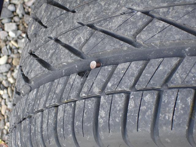

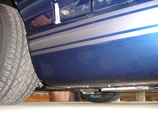

Bittersweet day...had another nice drive, but when I got home I discovered a nice nail in the right rear tire. I don't have a lead hammer to get the wheel off. I called Superformance and they have them in stock for about $20. Now why wouldn' they give one with the car...or suggest you buy one with the car?
I also do not know where the proper jacking points are. Other than the ery front and very rear - I dont have that kind of jack. Anyone know whre I can get one? Or where the car can be jacked from otherwise?
The clearance I measure is 4 3/8" at the sides. I can't measure the clearance at the bellhousing.

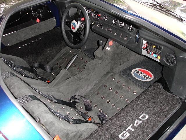

The info I got from Olthoff regarding the switch functions is wrong in teh A/C area. My lower left knob controls cold/heat, the center knob controls das h/floor and the right knob controls defrost/floor. Nice to find this out! Nothing like adding heat to the cockpit on a hot day....

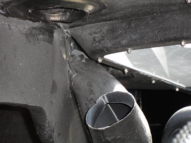

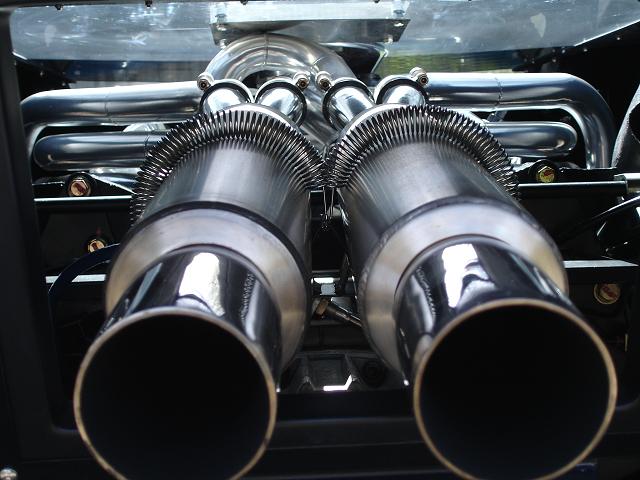

Some of the ducts are not hosed. Here is a shot of the back snorkels from the inside. There other ducts not hosed are the outboard ones up front that would feed brakes I assume. Picture 1 below.

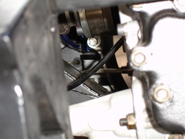

Here is a shot from behind loking in and you canjust see the white oil filter. Have to get at this from below. Picture 2

This diagram is in error. The switches for the A/C should be:
far left - Cold/Hot
center - Dash/Floor
right - Defrost/Floor
who knows...your car might be different!

The two "snorkel" scoops on the rear deck are to cool the rear brakes. The scooped slot between them is to cool the transaxle. Apparently Hi-Tech/SPF has left it to the purchaser to install the ducting from these to the brakes and transaxle. (Actually, unless you plan on getting into endurance racing, such ducting to the components probably isn't necesary.)

I also do not know where the proper jacking points are. Other than the very front and very rear - I dont have that kind of jack. Anyone know whre I can get one? Or where the car can be jacked from otherwise?
At least a couple of the SPF GT40's that've arrived at my local dealer have had brackets at the rear to, just like the originals, pop up the rear of the car for with a quick-jack for a fast rear tire change in the pits. Did yours come with one of these? A quick-jack shouldn't be hard to come up with (but you should use jack stands once you get the car up as, as you probably know, supporting a car with a jack when your under it should never be done.). I would contact Olthoff or HI-Tech for the proper solid points on the car for jacking and supporting, rear and front.
