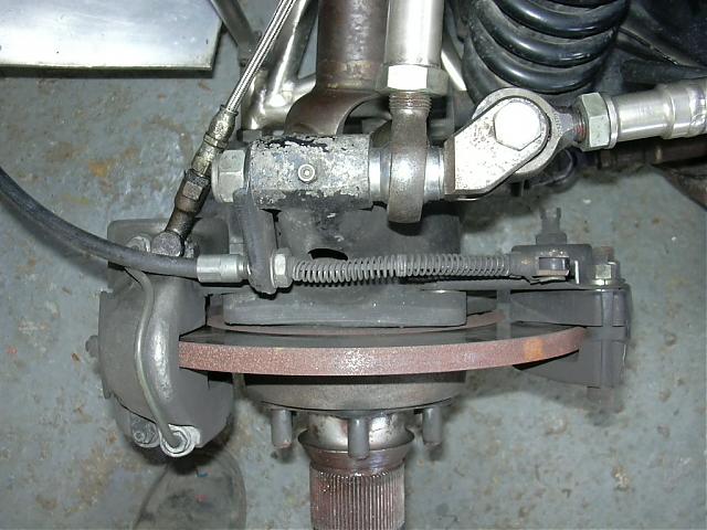

A small separate parking brake caliper is you answer.
Here is one as fitted to an original car.
