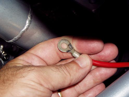

I shut down to investigate and find that the nut to the ammeter output teminal is backed off most of the way and the wire is loose - not really touching the post. I have no tools. Someone stops by but they don't have tools either.
In an hour my wife stops by and heads to get tools and a jumper cable.

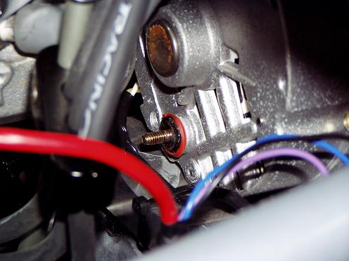

Fifteen minutes after her return, I have tightened the connection and restarted the car. During the first part of the short 6 miles back to my house, the ammeter shows proper charging. About two miles from my house the ammeter starts showing a large negative again. The alternator is not charging at all. I get the car home and look into it further - rather frustrated at this time. The pictures attached show that there was some arcing - the terminal is burnt and the alternator post insulation is melted (the post is loose too).

Mike, not much help at this point but now I always put a blob of silicone on the thead/nut on my alternator connections on the race cars. Keeps those nuts from backing off with the high vibration levels and is still removable with a tool.
We had one back off just like that, shorted on the block/bracket and toasted the wire and alternator during the 13 hour enduro last year. Was not cool, cost 30 mins in race time to replace.

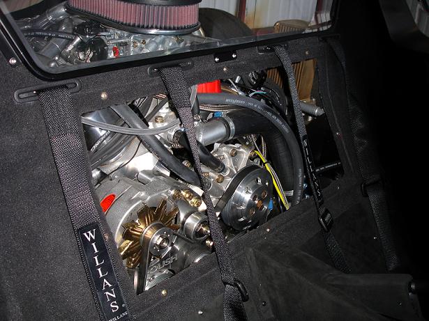

Probably be easier to replace yours one from the bottom if the alternator is down low, but I don't know how SPF has dressed the engines.

I am asking Dennis (in an email) to provide me guidance as to best replacement method. There is a pretty large access panel behind the seats.

And it is acessable via the panel in the bulkhead with the seat out. On Safir P1116 it was much faster to remove the seats and the panels than to curse and cuss at the lack of room.

It's hard to tell how bad the insulator is, but if all it was was just a loose bolt with some arcing to the metal, sand the connections clean, and use a washer and a locking bolt and you should be fine. If it did melt the insulator on the alternator, yank it and be safe.

well, the saga continues albeit slowly. I finally had some time to work on the car. Getting the alternator out wasn't that tough after pulling the seats and the engine cover on the bulkhead. Putting the replacemt in was a problem. The casting of one of the mounting ears was too thick - about 1/16" thicker and it wouldn't fit in the lower bracket. Now I have a choice to machine the casting of the replacement alternator or rebuild the original alternator. Luckily I was working at my hangar and two of the local plane mechanics came over to see the car. They told me of a shop that overhauls alternators and starters right down the road. I take it to them at 3pm and they say it will be as good as new by noon tomorrow - for the pricey sum of $20. Shweet. I might get to driv this car and get it registered this week...
So not only were they done early, but they only charged me $10. They took the original one apart, tighened the post with new hardare, replaced the insulator and tested it. I put is back in the car and it works fine.
Here is a picture of the access via the top bulhead cover plate. There are two lower ones also - behind the lower seat backs.
Back on the road!
Sorry about that - here goes. This should give you a good idea of the access.
